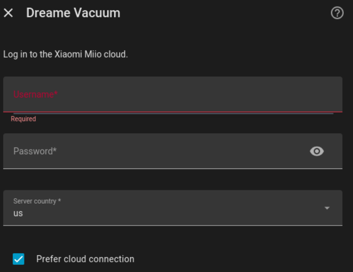

It’s barely a week that I join HA and I love it so far. A lot of learning so far. I’ve been trying desperately to add my Mova P10 ultra to HA without success. Some help would be appreciated. I use the mova application, I downloaded the xiaomo home account but unable to add my vacuum on it. I tried the integration on HACS the dreame one but when I try to login it states that my account has no device on it.

This is awesome, it looks like you added a bunch of new supported vacuums, I have the Mova P10 Pro but I can’t seem to get logged in? I’ve tried my mova email address and my ID but nothing works… It is also showing that you’re logging into Xiaomi Miio Cloud? Any ideas?

I have a dreame L10 prime also, try the the last beta version, this allow to enter the Dreame home app credentials and you will get the dreame on home assistant.

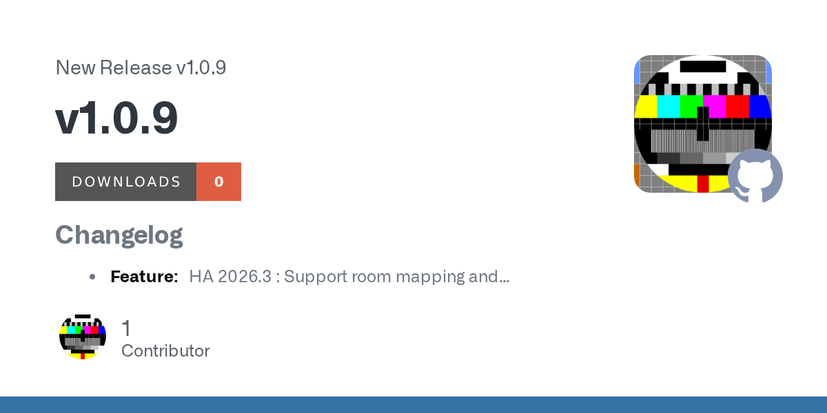

v1.0.9 has been released to add HA 2026.03 Clean Area feature.

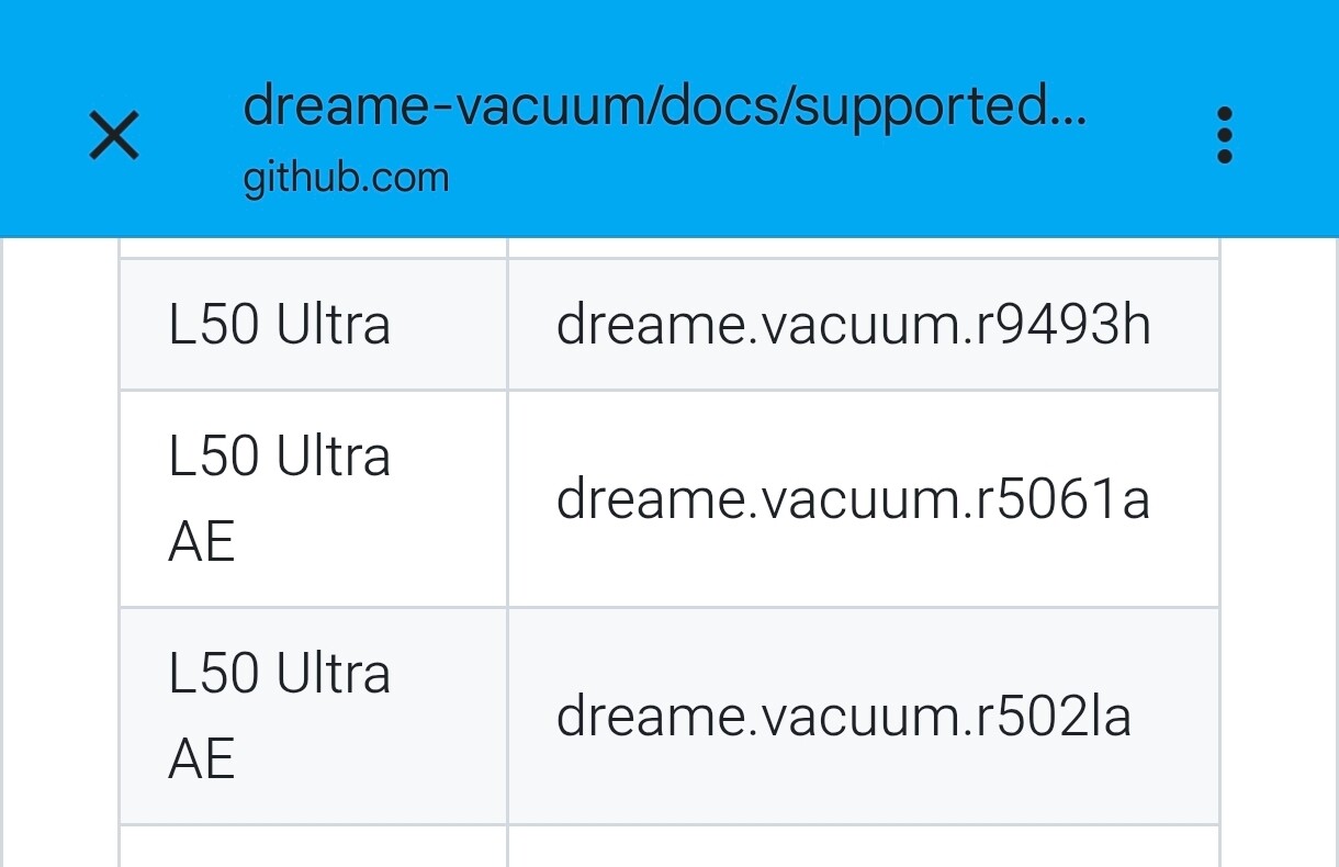

I’m considering buying a Dream L50 Ultra AE, but I don’t see it in the list of supported and compatible models.
The L50 Ultra is listed, but not the Ultra AE. Will it be compatible? Is it the same thing?
Sorry for all the questions, but I want to be sure before I buy it. I currently have a Xiaomi X20 Max, but many commands aren’t possible, or are very limited.
Thanks again for this custom component.
It is in supported devices list.
L50 Ultra AE dreame.vacuum.r5061a
L50 Ultra AE dreame.vacuum.r502la
Oh, sorry, I must have looked at an older supported_devices.md file. What is the latest version of supported_devices.md? Thanks again for your help, I’ll be contributing to this great project with a PayPal donation. Have a wonderful day!
I found the right file. Thank you very much.
