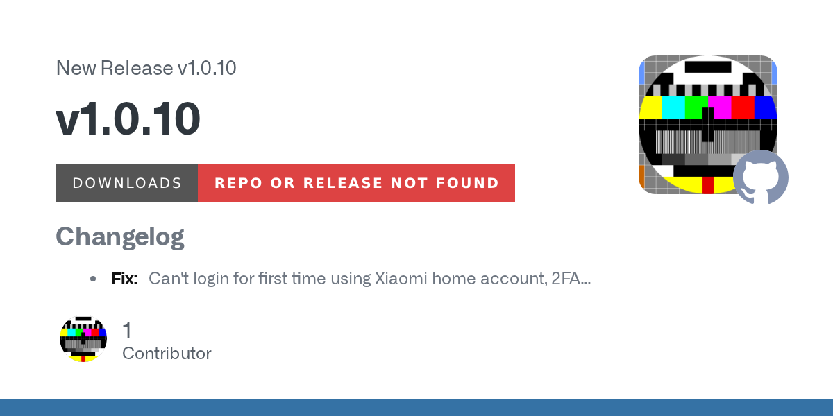

v1.0.10 has been released!
  • Fix: Can't login for first time using Xiaomi home account, 2FA code is not accepted #1647
  • Fix: pass full clean_segment args in async_clean_segments #1613
  • Fix: Memory leak #1650

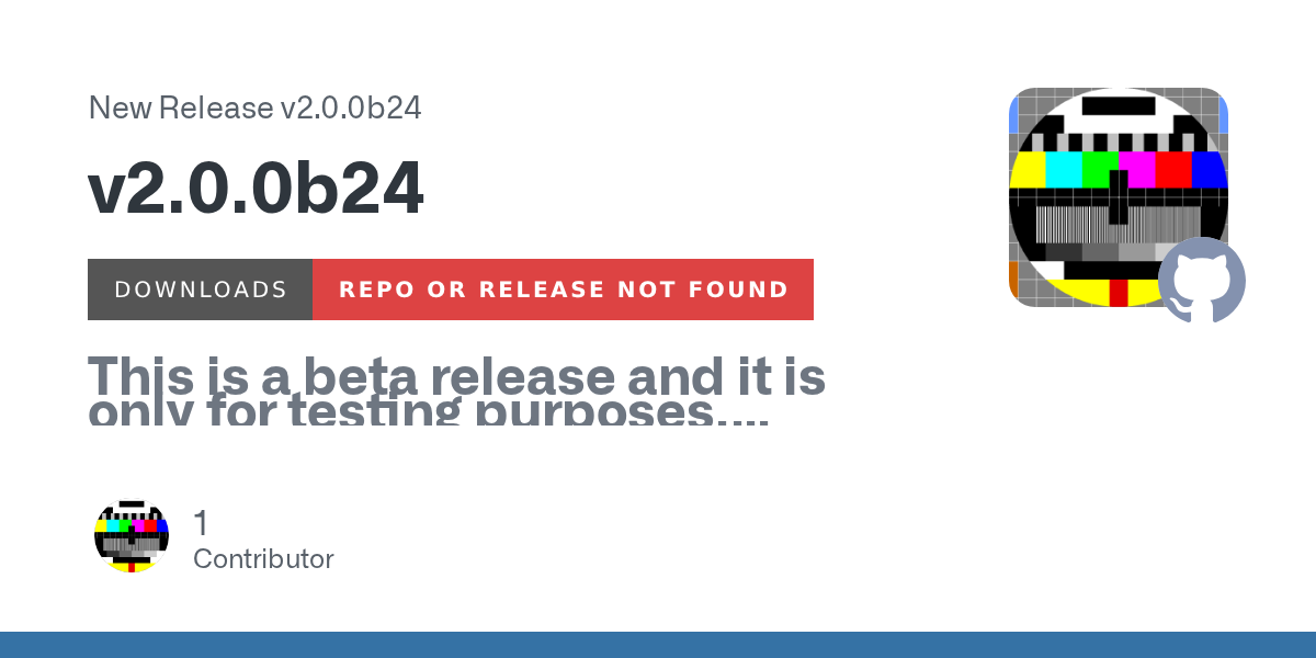

v2.0.0b24 has been released!
  • 74 new supported models.
  • Fixes for IT and ZH translations
  • Fixes for shortcut and base station cleaning
  • V2 Map Data support for 2026+ models
