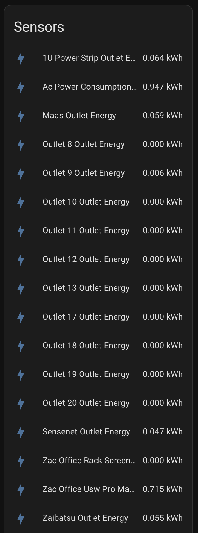

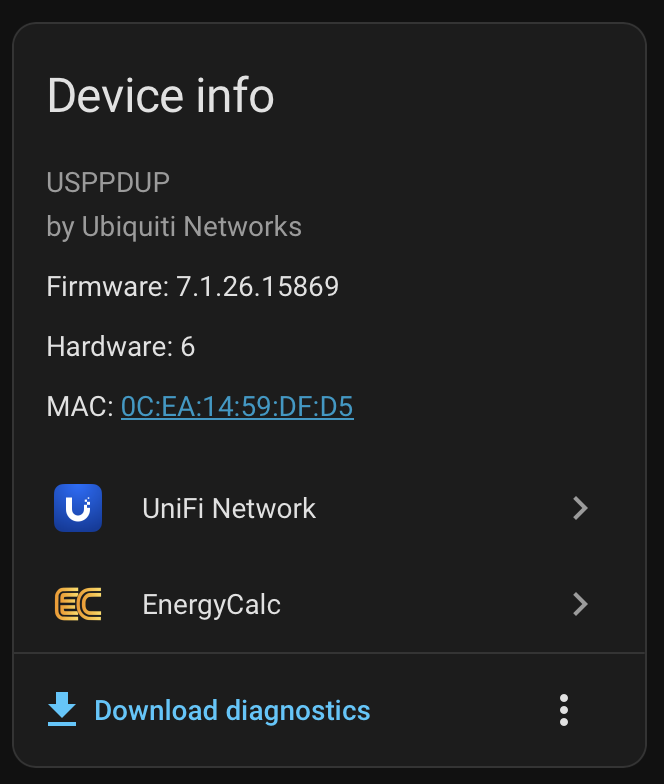

The newly created sensors integrate with the parent device, so you see all the sensors on the same device page (see image below).

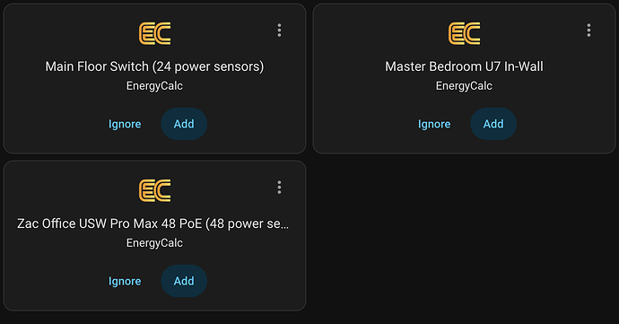

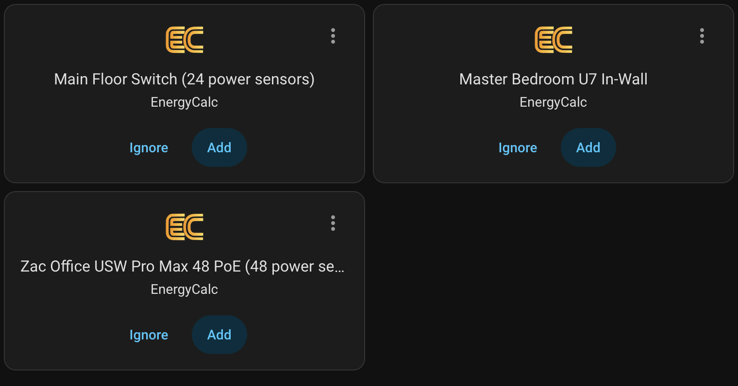

What does it look like?
Discovery
Device Details

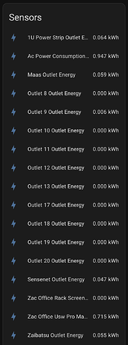

Sensors
