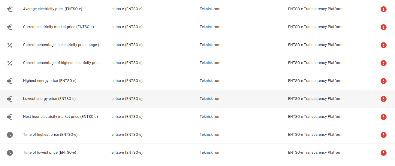

I have just installed the integration, but I cannot get it up and running. The logs state:
2025-07-04 10:48:58.395 DEBUG (MainThread) [custom_components.entsoe.coordinator] ENTSO-e DataUpdateCoordinator data update
2025-07-04 10:48:58.395 DEBUG (MainThread) [custom_components.entsoe.coordinator] NO_1
2025-07-04 10:48:58.395 DEBUG (MainThread) [custom_components.entsoe.coordinator] fetching prices for start date: 2025-07-03 00:00:00+02:00 to end date: 2025-07-05 23:00:00+02:00
2025-07-04 10:48:58.397 DEBUG (SyncWorker_0) [custom_components.entsoe.api_client] Performing request to https://web-api.tp.entsoe.eu/api with params {'documentType': 'A44', 'in_Domain': '10YNO-1--------2', 'out_Domain': '10YNO-1--------2', 'securityToken': 'xxxxxxx', 'periodStart': '202507030000', 'periodEnd': '202507052300'}
2025-07-04 10:48:58.595 DEBUG (SyncWorker_0) [custom_components.entsoe.api_client] content: <Element 'Publication_MarketDocument' at 0xffff4785db20>
2025-07-04 10:48:58.598 DEBUG (MainThread) [custom_components.entsoe.coordinator] received data = {}
2025-07-04 10:48:58.599 DEBUG (MainThread) [custom_components.entsoe.coordinator] received pricing data from entso-e for 0 hours
2025-07-04 10:48:58.599 DEBUG (MainThread) [custom_components.entsoe.coordinator] Finished fetching ENTSO-e coordinator data in 0.204 seconds (success: True)
2025-07-04 10:48:58.600 INFO (MainThread) [homeassistant.components.sensor] Setting up entsoe.sensor
2025-07-04 10:48:58.601 DEBUG (MainThread) [custom_components.entsoe.coordinator] The calculator needs to be synced with the current time
2025-07-04 10:48:58.601 WARNING (MainThread) [custom_components.entsoe.sensor] Unable to update entity 'entsoe.ENTSO-e_Current electricity market price': No valid data for today available.
2025-07-04 10:48:58.603 WARNING (MainThread) [custom_components.entsoe.sensor] Unable to update entity 'entsoe.ENTSO-e_Next hour electricity market price': No valid data for today available.
2025-07-04 10:48:58.606 WARNING (MainThread) [custom_components.entsoe.sensor] Unable to update entity 'entsoe.ENTSO-e_Lowest energy price': No valid data for today available.
2025-07-04 10:48:58.608 WARNING (MainThread) [custom_components.entsoe.sensor] Unable to update entity 'entsoe.ENTSO-e_Highest energy price': No valid data for today available.
2025-07-04 10:48:58.610 WARNING (MainThread) [custom_components.entsoe.sensor] Unable to update entity 'entsoe.ENTSO-e_Average electricity price': No valid data for today available.
2025-07-04 10:48:58.613 WARNING (MainThread) [custom_components.entsoe.sensor] Unable to update entity 'entsoe.ENTSO-e_Current percentage of highest electricity price': No valid data for today available.
2025-07-04 10:48:58.615 WARNING (MainThread) [custom_components.entsoe.sensor] Unable to update entity 'entsoe.ENTSO-e_Current percentage in electricity price range': No valid data for today available.
2025-07-04 10:48:58.617 WARNING (MainThread) [custom_components.entsoe.sensor] Unable to update entity 'entsoe.ENTSO-e_Time of highest price': No valid data for today available.
2025-07-04 10:48:58.621 WARNING (MainThread) [custom_components.entsoe.sensor] Unable to update entity 'entsoe.ENTSO-e_Time of lowest price': No valid data for today available.
I have tried the same request manually in postman, and it works fine. The logs also states: “Finished fetching ENTSO-e coordinator data in 0.204 seconds (success: True)”. I have tried to reinstall, but same result. I have also tried a clean setup with no additional costs, and different calculation methods.
I’m running HAOS 2025.6.3 on Home Assistant Green. Latest version of the integration.
The entities looks like this:
Any suggestions?
