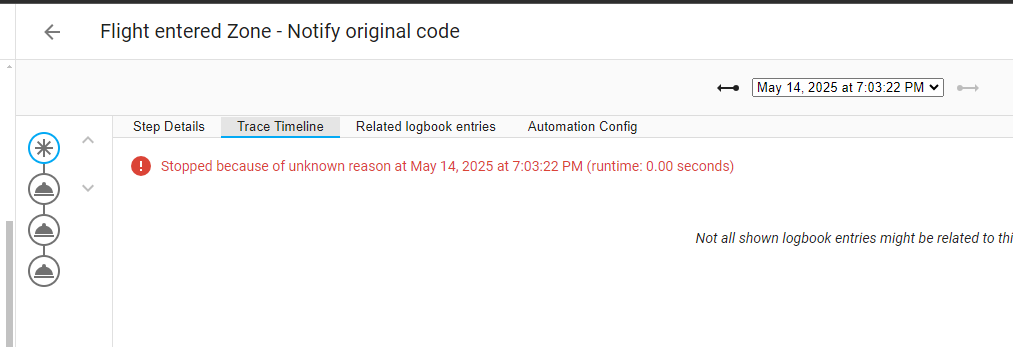

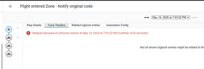

So far im only getting the first 3 words “Flight Nearby is” if i run it manually
When it runs itself it seems to error with an unknown error.
Would you be able to please check its still working for you?
No aircraft in area atm (I’m rural :wink:) can confirm if I run manually get same result as you are getting (first theee words only) - probably as message: ‘{{ details }}’ is not populated as no aircraft in area.
Will try tomorrow morning when aircraft in area & see if I can sort it out…
thanks yeah I tried it while aircraft in area and still got that. I am semi rural too so not a huge amount of aircraft around atm,

For some reason I dont think I am getting past the event stage, it just tried to trigger with a flight entering but giving me error right at the start
Ok so I copied your simplified version & changed necessary devices to work on my HA and an aircraft just flew over and was announced on my Google display as it should and created a persistent (for debug) message.
Try this once you check a few things I can think of:
  1. Check your flightradar24 entity trigger is same as mine (or select the correct one from yours.
  2. Im using Integration TTS Say for speech - if you are not either modify my code or i can send you a revised draft version using your preferred speech engine.
