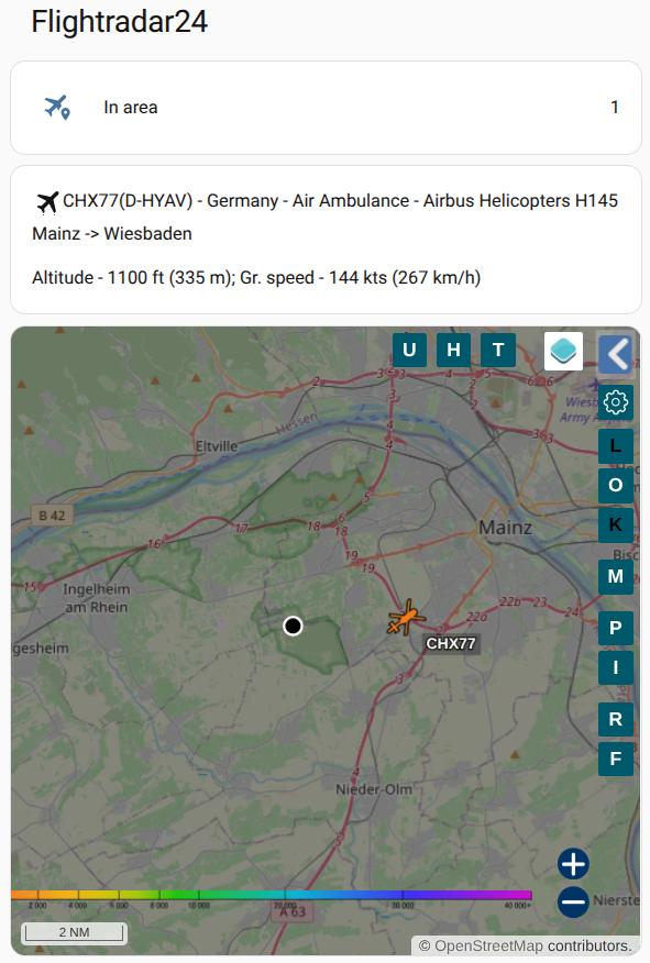

It is better to use parameters lat and lon instead of SiteLat and SiteLon
URL example:
https://globe.adsb.fi/?enableLabels&trackLabels&zoom=12&hideSideBar&lat=50.984944839678334&lon=11.311357147743463

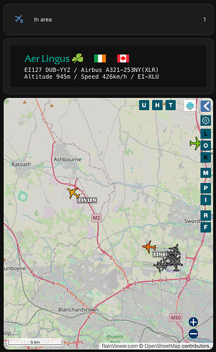

Worked on this today, and I’m loving it :slight_smile:
Source for the airline logos here.
Here’s the relevant code section:

I created a custom card to better visualize the flights from this integration
