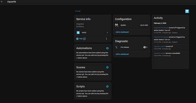

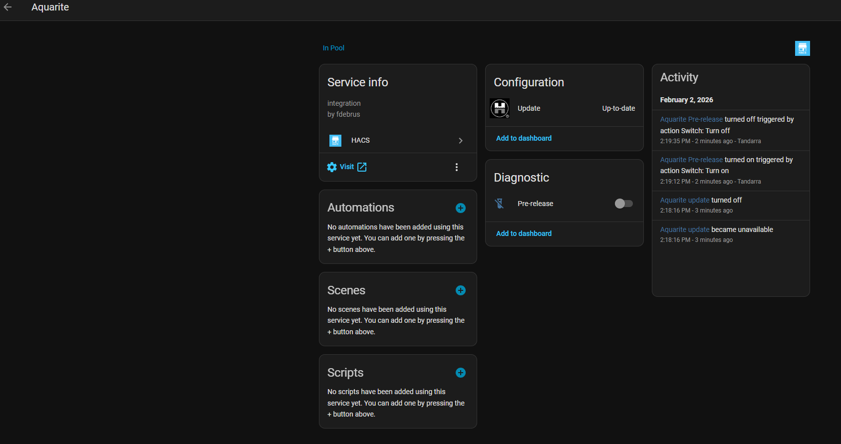

@fdebrus I’m not getting any prompts to login after installing from HACS is there a way I can force this?
Could you detail how you installed ?
Normal procress for any custom integration is
  • Download from HACS
  • Restart HA
  • Add the download custom integration from Settings - Device and Services - Add Integration (here aquarite)
let me know
Ahh I had missed a step.
I didn’t add integration to Device and Services. That got the prompt to login and is now working.
It did not appear in HACS, so I had to add the github as a custom repository.
Feel abit stupid for not reading instructions properly. Thanks for your help!
