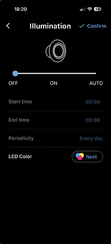

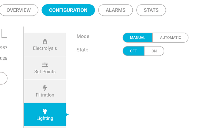

Do you have a dedicated menu / button on the application or webpage ? could you screenshot it
I think it’s basically a simple off/on within a very short time — probably even within a second — which then switches to the next color. If you do it manually (turn the light off and then immediately back on), it also cycles to the next color. In the app, the function is called “Next Color.”

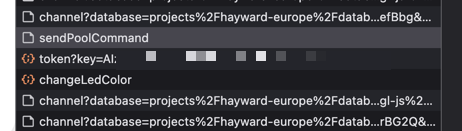

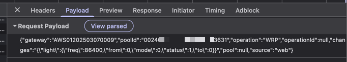

monitor the traffic for “SendPoolCommand” - Open the Payload - give me this line change
“{"light":{"freq":0,"from":0,"mode":0,"status":1,"to":0}}”
Should be similar to the one above which turn the light off to on, but I expect a specific command on your case.
else wait that I set this up on my aquarite
changeledcolor

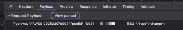

payload
{gateway: "AWS01202503070009", poolId: "002400xxxxx500E20373631", type: "change"}
gateway
"AWS012xxxx009"
poolId
"002xxxx0373631"
type
"change"
Check for other SendPoolCommand happening as you push the change color. The one you pasted has no payload regarding light nor color
already found the configuration, but not the payload

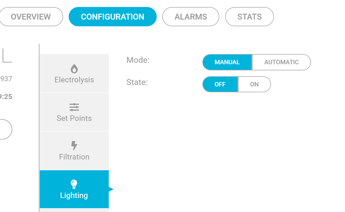

There is no poolsendcommand, when changing lights… only at sitch on .
the payload of chageledcolor is,
The sendpoolcommand at the time of switching on Lights was:
Good, I was checking my aquarite, and when on the physical device I do have a LED control, I do not have it in the application nor web page. I when over the service menu, I do not see how to configure my pool with LED.
So while I will look at your payload that you shared, I cannot yet debug as I do not have that fonctionality in the application nor the webpage.
Do you know how to get this in the application or webpage as you do ?
Should be able to configure it somewhere, as my pool has hasLED=0 in the payload, while yours I guess as hasLED=1 and then the functionality is available in the application / web
Also, can you use the “Next color” button when the light is off ? or it needs to be on ? if it is on and you “next color” does it turns on ?

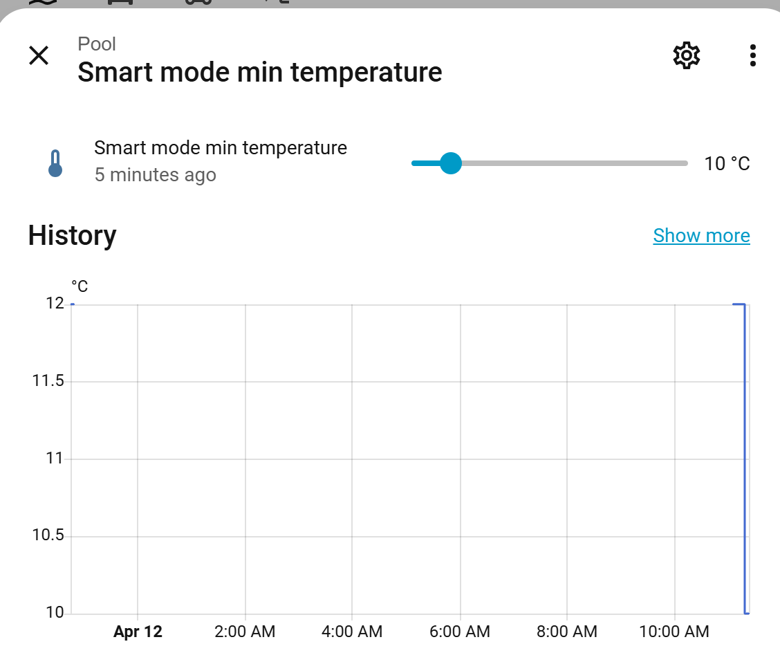

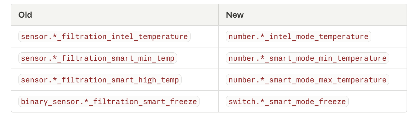

Those entities changes are also part of this release, so you can change temperature settings from the integration
If I could make one more request, it would be great to have the ability to set the pool filtration intervals (i.e., the schedules/times) directly through the interface. At the moment, they seem to be exposed only as sensors that reflect what’s configured in the mobile app, rather than allowing them to be set via Home Assistant.
I’ve been looking into that one, trouble is HA, the UI to setup interval is not trivial. I’ve been working on setting the temperature, which is done now.
Will look at interval, it’s not a coding problem, it’s an User Interface challenge. for now Temperature setting is working

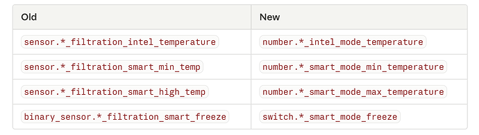

Can try with the beta 1.2.0 release. should be able to set time interval etc…
Some entities have been renamed to reflect that change, need to adapt your dashboard.
