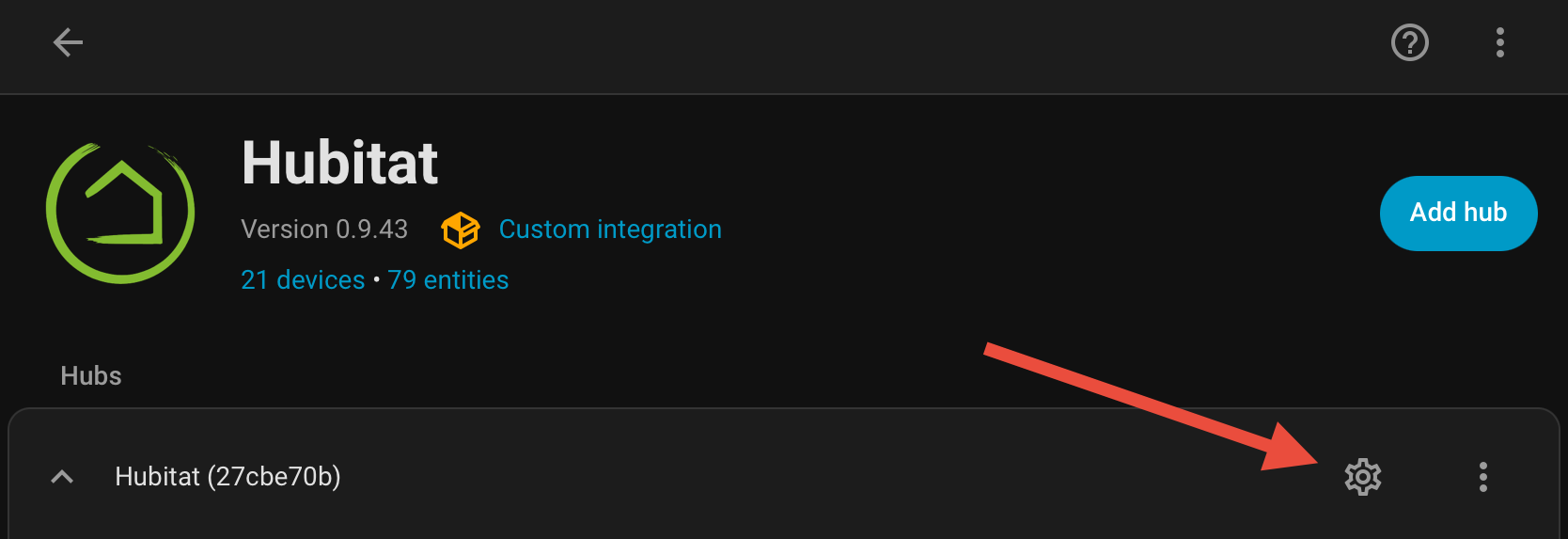

I’ve read this (and even searched it) but I do not understand what the words mean. “Open the inegration’s options and run through the options flow.”
My assumption is go to Settings - Devices - Integrations… from there I can’t find any settings or “flows” that give me the option to delete the device. I did remove the device from Maker in HE already.
Open the integration and tap the settings button, then step through the settings dialogs that pop up. It used to be more obvious, but the UI has gotten a bit more streamlined in the last few versions.

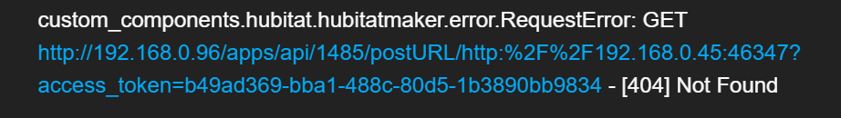

Hi a strange one for my HADB integration. It appears that all of my devices are communicating but the HA app saily failed to communicate and the HA has a failed log as per below. Anyone have any suggestions ?
Logger: homeassistant.config_entries
Source: config_entries.py:761
First occurred: 18:36:13 (4 occurrences)
Last logged: 19:12:44
Error setting up entry Hubitat (b49ad369) for hubitat
File “/usr/src/homeassistant/homeassistant/config_entries.py”, line 761, in __async_setup_with_context
result = await component.async_setup_entry(hass, self)
File “/config/custom_components/hubitat/init.py”, line 39, in async_setup_entry
hub: Hub = await Hub.create(
hass, config_entry, len(cast(dict[str, Any], hass.data[DOMAIN])) + 1
File “/config/custom_components/hubitat/hub.py”, line 324, in create
await hubitat_hub.start()
File “/config/custom_components/hubitat/hubitatmaker/hub.py”, line 197, in start
await self._start_server()
File “/config/custom_components/hubitat/hubitatmaker/hub.py”, line 503, in _start_server
await self.set_event_url(self.event_url)
File “/config/custom_components/hubitat/hubitatmaker/hub.py”, line 247, in set_event_url
await self._api_request(f"postURL/{url}")
File “/config/custom_components/hubitat/hubitatmaker/hub.py”, line 449, in _api_request
raise RequestError(resp)
custom_components.hubitat.hubitatmaker.error.RequestError: GET http://192.168.0.96/apps/api/1485/postURL/http:%2F%2F192.168.0.45:46347?access_token=b49ad369-bba1-488c-80d5-1b3890bb9834 - [404] Not Found
This integration has nothing to do with HADB. You might want to post your question on the Hubitat forum.
Based on the log data the user provided, he is not having issues with HADB. HADB does not use any Home Assistant custom code. It simply uses HA’s websocket interface to ‘listen’ for data changes and to send updates. HADB brings HA devices into HE.
Based on the log data, it appears @ebbeckn is probably using @jason0x43’s Hubitat to Home Assistant integration. The error seems to indicate that HA is not able to connect to the user’s Hubitat Hub using the 192.168.0.96 IP address.
@ebbeckn - Is your Hubitat Hub still using the 192.168.0.96 IP address?
Did you make any changes to your HE hub, like accidentally removing the MakerAPI App that HA was talking to?
