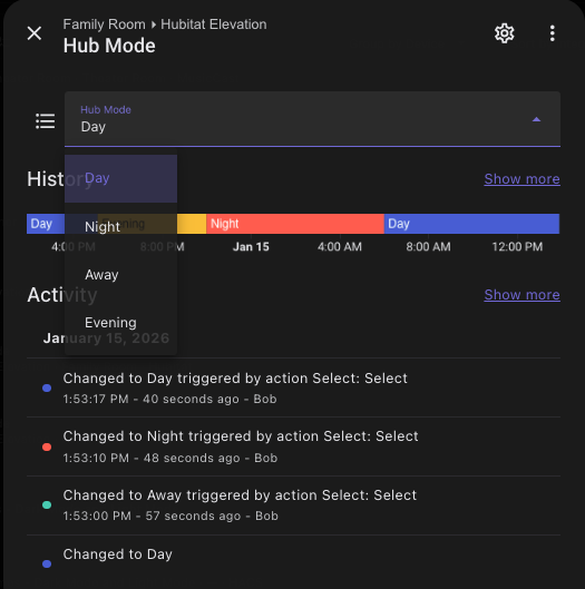

Anyone know if HE’s hub mode should be working? Because I’ve finally gotten around to setting it up and I’m getting strange behavior that I have repro’d.
  • hub mode enabled in Maker API
  • select and sensor entity shows up in integration Hubitat integration within HA (once it’s reloaded)
  • If I run an action from HA to change the mode, the change is reflected in HE as expected
  • If I use the select entity from HA to change the mode, no change is reflected in either HA or HE
  • If I change the mode from HE, no change is reflected in HA
Been messing around with this all morning and I’m stumped. Now I’m wondering if maybe modes aren’t even implemented in this integration since they are a special class of events in HE. And I don’t see anything in the OP’s documentation let alone this thread even.
Yes, it does work.
OK thank you for that feedback.
I figured out what I did wrong and am posting here for the benefit of others to follow. Two things I didn’t realize:
  • it is not enough to enable “allow control of modes” in Maker API if you want bidirectional sync of hub modes. You also have to enable “POST location events”, duh.
  • secondly, and more subtly, if you change the mode from HA, no mode change will be apparent in Hubitat, at least not from Settings>Mode. It looks to me like that screen does not show changes in mode unless you refresh your browser. That through me off initially because I assumed incorrectly that mode changes in HA were not being reflected in HE–when, in fact, they were.
Hope my pain helps others…
Hmmm…. Not sure which browser you are using, but mode changes are reflected instantly in HE using Chrome.
I’m using Chrome too, but I don’t see any change in Settings/Mode (unless I refresh)
