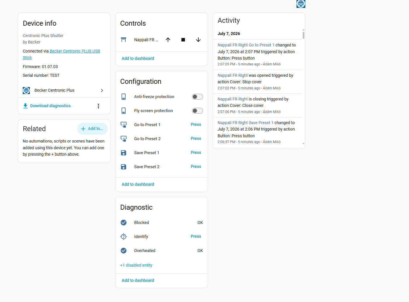

Hi, i am trying to set this up but failing with the Windows part and Becker Tool pairing. My stick finds all the 8 covers i have, and i can move them all together, but as soon as i click any of them i get a yellow warning that it cannot read all the infornation. In HA the stick is visible but sees no entity at all...
Hi, so you mean the Becker Tool complaints it cannot read all the information? I think i maybe had such a symptom once, but only temporary, and I was quite far away from my covers then.
Particularly odd if you can move them individually without problem. Maybe you can share a screenshot of the problem. Just out of curiosity, not that I could give any support regarding the Becker Tool.
Feel free to create a new issue here and attach a debug log, then I can have a look a the problem from the integration perspective.
I was able to pair the covers in becker tool, but was not working properly (becker tool gave me yellow warning that devices cannot be fully read). So idecided to move on and work in HA since the pairing was ready, as i assumed.

  1. There was a change in the action packet, so my "UP, DOWN, STOP" actions was not working, while "Identify" was able to cluck the cover. (Maybe version difference?)
 # return f"07010118{mac}01013400000000000000{action.value}0000000501"
    return f"0701011A{mac}01013400000000002000{action.value}000000010501"
In my case i had to change f"07010118 to f"0701011A in the action packet definition.
That change immediately fixed the action buttons, and now i can move them UP/DOWN/STOP.
Sadly the position command is not working and i am pretty stucked debugging it. I can read the cover postion, but the slide or the values (25%, 50%, 75%, 100%) not moving the cover into position at all. I have Centronic Plus USB stick (4036 200 001 0) and C01 plus covers.
As a little improvement and to bypass the need of % input i added 2 more buttons, to set preset.
With these I can set any position. When i click on save preset my motors aknowledge it with cluck, then the "Go To Preset" will return to that position. Added the below in the button.py:

However this is working still not sure how to solve the move to, and how to send % input to the motors.

Actually i don't want to convince you, but in my case preset was a good alternative since i cannot send % value to the cover or use the slider to set position. See some debug logs below when i hit 25% , 50%, 75%. or random value on the slider. My covers do nothing. But as far as i know preset positions are stored in the motor's memory so it is working. Maybe not the best solution but at least i have 2 more positions now (other then fully closed or fully open).
Well, this must be BECKER P9/16 C01 PLUS motor (based on the invoice), that I controlled with an EC5416 and EC548 handheld controller before. Is there any packet that returns the exact motor type (e.g. R20-17-C01 PLUS), or are only serial number and firmware available?
0700011F was only needed to discover the devices, without that i could not see any device in HA, only the USB stick.
The action packet solved my action buttons that was not working, with that correction now i have almost fully working integration (except the % value that i can send to the motor today, but it does not react)

Preset press Debug log:
2026-07-08 06:10:32.571 WARNING (MainThread) [pybeckerplus.client] SEND: 0701011Aa0dc04fffed73ded0101340000000000200024000000010501
2026-07-08 06:10:32.571 DEBUG (MainThread) [pybeckerplus.client]  --> USB 0701011Aa0dc04fffed73ded0101340000000000200024000000010501
2026-07-08 06:10:32.575 WARNING (MainThread) [pybeckerplus.client] SEND: 0701011Aa0dc04fffed73ded0101340000000080A0000000000000240501
2026-07-08 06:10:32.823 DEBUG (MainThread) [pybeckerplus.client]  --> USB 0701011Aa0dc04fffed73ded0101340000000080A0000000000000240501
2026-07-08 06:10:32.898 DEBUG (MainThread) [pybeckerplus.client]  <-- USB 0700011AA0DC04FFFED73DED010111000000008030CE1240630300240001
2026-07-08 06:10:32.899 WARNING (MainThread) [pybeckerplus.client] RAW PACKET: 0700011AA0DC04FFFED73DED010111000000008030CE1240630300240001
2026-07-08 06:10:32.899 WARNING (MainThread) [pybeckerplus.client] PARSED: {'type': 'device', 'mac_id': 'a0dc04fffed73ded', 'status': b'\x12@', 'pos': 1.3229571984435797, 'rssi': 206}
2026-07-08 06:10:32.899 WARNING (MainThread) [pybeckerplus.device] UPDATE STATUS a0dc04fffed73ded
2026-07-08 06:10:32.899 DEBUG (MainThread) [pybeckerplus.device] Device: a0dc04fffed73ded updated
2026-07-08 06:10:32.899 WARNING (MainThread) [custom_components.becker_centronic_plus] >>> DEVICE CALLBACK <<< MAC=a0dc04fffed73ded NAME=Nappali FR Right POS=1.3
2026-07-08 06:10:32.899 DEBUG (MainThread) [custom_components.becker_centronic_plus] Device update from a0dc04fffed73ded. Changes: {'position': (0.0, 1.3), 'moving': (False, True), 'upper_limit': (True, False)}
2026-07-08 06:10:36.326 WARNING (MainThread) [pybeckerplus.client] SEND: 0701011Aa0dc04fffed73ded0101340000000080A0000000000000250501
2026-07-08 06:10:36.326 DEBUG (MainThread) [pybeckerplus.client]  --> USB 0701011Aa0dc04fffed73ded0101340000000080A0000000000000250501
2026-07-08 06:10:36.396 DEBUG (MainThread) [pybeckerplus.client]  <-- USB 0700011AA0DC04FFFED73DED010111000000008030CF12408B3500250001
2026-07-08 06:10:36.396 WARNING (MainThread) [pybeckerplus.client] RAW PACKET: 0700011AA0DC04FFFED73DED010111000000008030CF12408B3500250001
2026-07-08 06:10:36.396 WARNING (MainThread) [pybeckerplus.client] PARSED: {'type': 'device', 'mac_id': 'a0dc04fffed73ded', 'status': b'\x12@', 'pos': 20.915541313801786, 'rssi': 207}
2026-07-08 06:10:36.397 WARNING (MainThread) [pybeckerplus.device] UPDATE STATUS a0dc04fffed73ded
2026-07-08 06:10:36.397 DEBUG (MainThread) [pybeckerplus.device] Device: a0dc04fffed73ded updated
2026-07-08 06:10:36.397 WARNING (MainThread) [custom_components.becker_centronic_plus] >>> DEVICE CALLBACK <<< MAC=a0dc04fffed73ded NAME=Nappali FR Right POS=20.9
2026-07-08 06:10:36.397 DEBUG (MainThread) [custom_components.becker_centronic_plus] Device update from a0dc04fffed73ded. Changes: {'position': (1.3, 20.9), 'rssi': (206, 207)}
2026-07-08 06:10:40.879 WARNING (MainThread) [pybeckerplus.client] SEND: 0701011Aa0dc04fffed73ded0101340000000080A0000000000000260501
2026-07-08 06:10:40.879 DEBUG (MainThread) [pybeckerplus.client]  --> USB 0701011Aa0dc04fffed73ded0101340000000080A0000000000000260501
2026-07-08 06:10:40.953 DEBUG (MainThread) [pybeckerplus.client]  <-- USB 0700011AA0DC04FFFED73DED010111000000008030CD10402C7300260001
2026-07-08 06:10:40.953 WARNING (MainThread) [pybeckerplus.client] RAW PACKET: 0700011AA0DC04FFFED73DED010111000000008030CD10402C7300260001
2026-07-08 06:10:40.953 WARNING (MainThread) [pybeckerplus.client] PARSED: {'type': 'device', 'mac_id': 'a0dc04fffed73ded', 'status': b'\x10@', 'pos': 44.98970016021973, 'rssi': 205}
2026-07-08 06:10:40.953 WARNING (MainThread) [pybeckerplus.device] UPDATE STATUS a0dc04fffed73ded
2026-07-08 06:10:40.953 DEBUG (MainThread) [pybeckerplus.device] Device: a0dc04fffed73ded updated
2026-07-08 06:10:40.953 WARNING (MainThread) [custom_components.becker_centronic_plus] >>> DEVICE CALLBACK <<< MAC=a0dc04fffed73ded NAME=Nappali FR Right POS=45.0
2026-07-08 06:10:40.953 DEBUG (MainThread) [custom_components.becker_centronic_plus] Device update from a0dc04fffed73ded. Changes: {'position': (20.9, 45.0), 'moving': (True, False), 'rssi': (207, 205)}
2026-07-08 06:10:43.154 DEBUG (MainThread) [pybeckerplus.client]  <-- USB 0700011AA0DC04FFFED73DED0101110000000080300010402C7365000001
2026-07-08 06:10:43.154 WARNING (MainThread) [pybeckerplus.client] RAW PACKET: 0700011AA0DC04FFFED73DED0101110000000080300010402C7365000001
2026-07-08 06:10:43.154 WARNING (MainThread) [pybeckerplus.client] PARSED: {'type': 'device', 'mac_id': 'a0dc04fffed73ded', 'status': b'\x10@', 'pos': 44.98970016021973, 'rssi': 0}
2026-07-08 06:10:43.154 WARNING (MainThread) [pybeckerplus.device] UPDATE STATUS a0dc04fffed73ded
2026-07-08 06:10:43.155 DEBUG (MainThread) [pybeckerplus.device] Device: a0dc04fffed73ded updated
2026-07-08 06:10:43.155 WARNING (MainThread) [custom_components.becker_centronic_plus] >>> DEVICE CALLBACK <<< MAC=a0dc04fffed73ded NAME=Nappali FR Right POS=45.0
2026-07-08 06:10:43.155 DEBUG (MainThread) [custom_components.becker_centronic_plus] Device update from a0dc04fffed73ded. Changes: {'rssi': (205, 0)}
