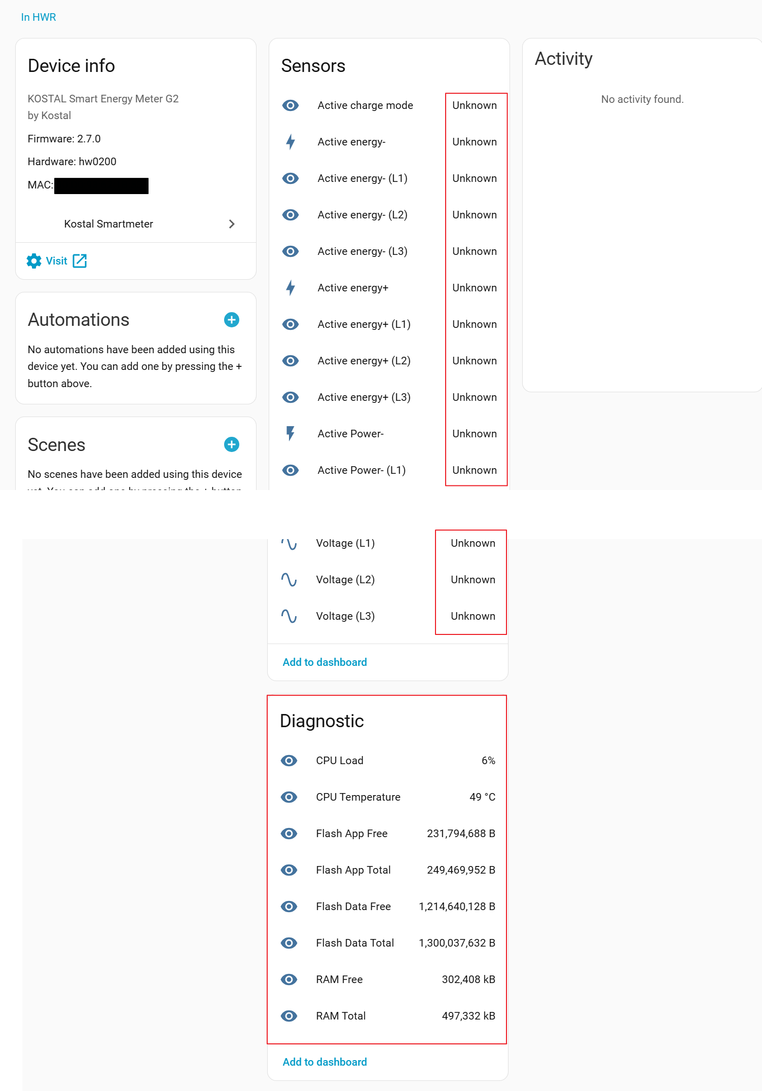

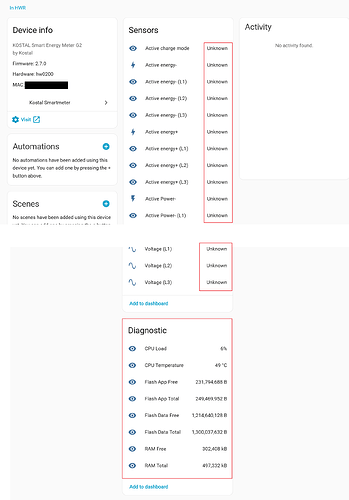

Many thanks for creating this integration. I installed it via HACS, but having trouble to retrieve data:
All Sensors are “unknown”, only the Diagnostics seem to work.
Any chance you could think of a solution for this?

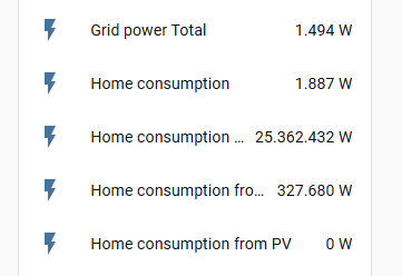

However, could there be some problem with number conversion?
I definitely don’t have 25 MW (Megawatt!) from my battery.
I am happy to assist in debugging!

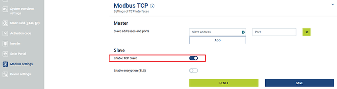

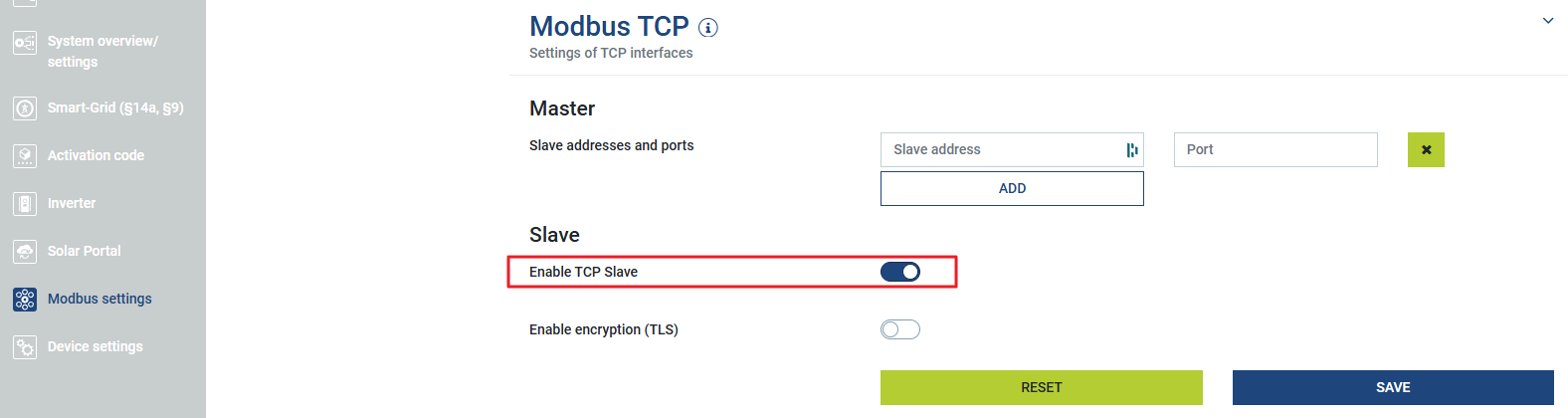

Hi, I was able to solve this issue by enabling the TCP Slave in the KSEM:
Now it works as it should! Many thanks for the integration!
