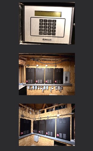

Hello new friends. I just purchased a home with a Litetouch 2000 system and I’m looking for the best place to start. I have a Ubiquity network rack all set up, but I haven’t yet played with home assistant. I wanted to get confirmation on my options before I started diving in. I will be integrating my solar, powerwalls, EVs, cameras, and wireless smart switches. Hopefully also my Litetouch! Anyone have any suggestions for me? Probably in over my head at this point but I’m sure I’ll figure it out eventually.
Use my matterbridge plugin above. I’ve been using it for a few weeks and it works great. You’ll need a raspberry pi and need to make a special cable.
Ordering a pi now. I should have everything I need to make a cable. Then I just install Matterbridge on the pi and plug it in to the 2000? I have not yet used any matter devices specifically. I got heavily into the Apple HomeKit stuff for a while… I assume matter devices will show up in Apple home? Or is there a better place before I get more involved with home assistant?
You’ll need to edit the config file for the plugin to tell it the load ID’s and the names of the loads. It’s in the readme, and there’s a sample file. Make sure you don’t forget the commas after each line in the config file, syntax matters. I couldn’t figure out a way to do this in matterbridge UI. I’m sure there’s a way.
Once it’s set up, matterbridge will have a QR code in the UI that you scan with Apple Home on your phone when you click add device. Also, that’s in the readme.

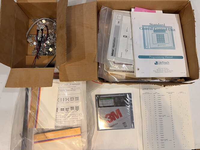

I was left a whole treasure trove of stuff. Blank buttons and new wall plates, old floppy disks with software, several books and binders full of information, electrical schematics, and an old dot matrix printout of all 297 switches and their corresponding addresses and module assignments. There is also a blueprint of the house with each switch number labeled in their correct locations.
I dream of one day having a web interface that will let me reassign modules and switch types remotely. And of course automation… Lots to learn!
:exclamation: :exclamation: :exclamation:
Can you get those manuals scanned to pdf and send them to me or post them? And, get copies of the software on those disks? This would be AWESOME to have this. I have some stuff that I was able to download, and one piece of software that allows me to upload/download the config from the CCU, but that’s it.
Getting the documentation and software to properly manage these has proven extremely difficult.
