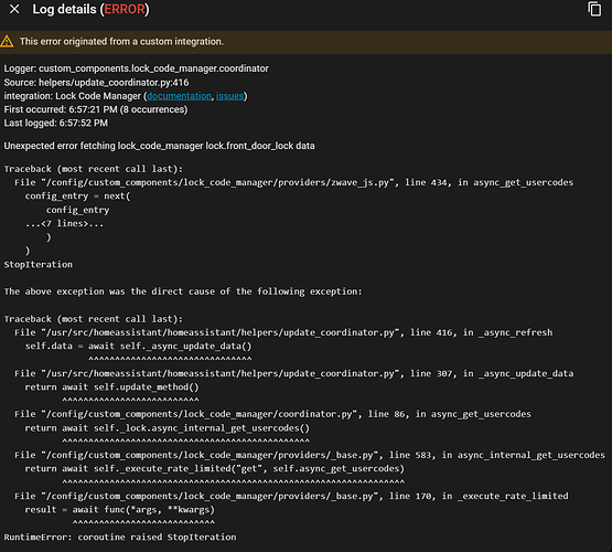

I installed the integration, and it all seemed to work correctly. I was impressed with how simple it worked. Unfortunately, I noticed it was repeatedly syncing my 3 slots over and over without end. I’m guessing that would kill my battery quickly, so I disable it (hopefully temporarily).
One thing I noticed: When it synced a code slot, the pin sensor would show *******, but shortly afterward it would change to the unhidden (“raw”) pin number. Could it be cycling the synce because of the ****** does not match the raw pin code? In other words, the obfuscation characters cause the sync to fail, which triggers another sync?
FYI, my lock is a somewhat older z-wave Schlage BE469.
Damn I put in some fixes specifically to prevent that behavior but I guess it’s not working for all scenarios… can you set the log level for the LCM integration and zwave js integration to debug, enable the integration again and watch it flap a bit, then disable again and send me the logs? That’ll help me track down the race condition that’s occurring. Thanks!
I get this in my host log. I also included the diagnostic log from my z-wave lock (I can’t upload diag file for some reason).
thanks for reporting, this was enough to figure out the issue: Fix StopIteration crash when lock has unmanaged slots with masked PINs by raman325 ¡ Pull Request #760 ¡ raman325/lock_code_manager ¡ GitHub
Works great now! Thanks for the update. I appreciate this integration. It’s more intuitive and simple to install compared to KeyMaster which is perfect for many users.
