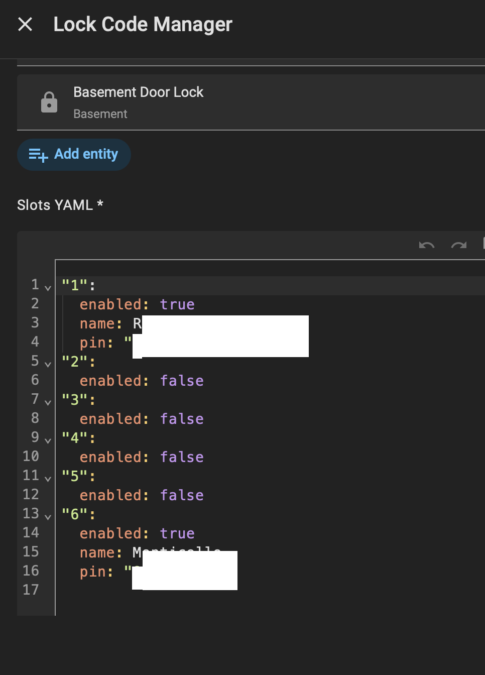

How do I simply add a new lock code to all locks without setting up from the beginning again? When I initially setup I setup codes -1-5. I want to add code 6. How do I do that?

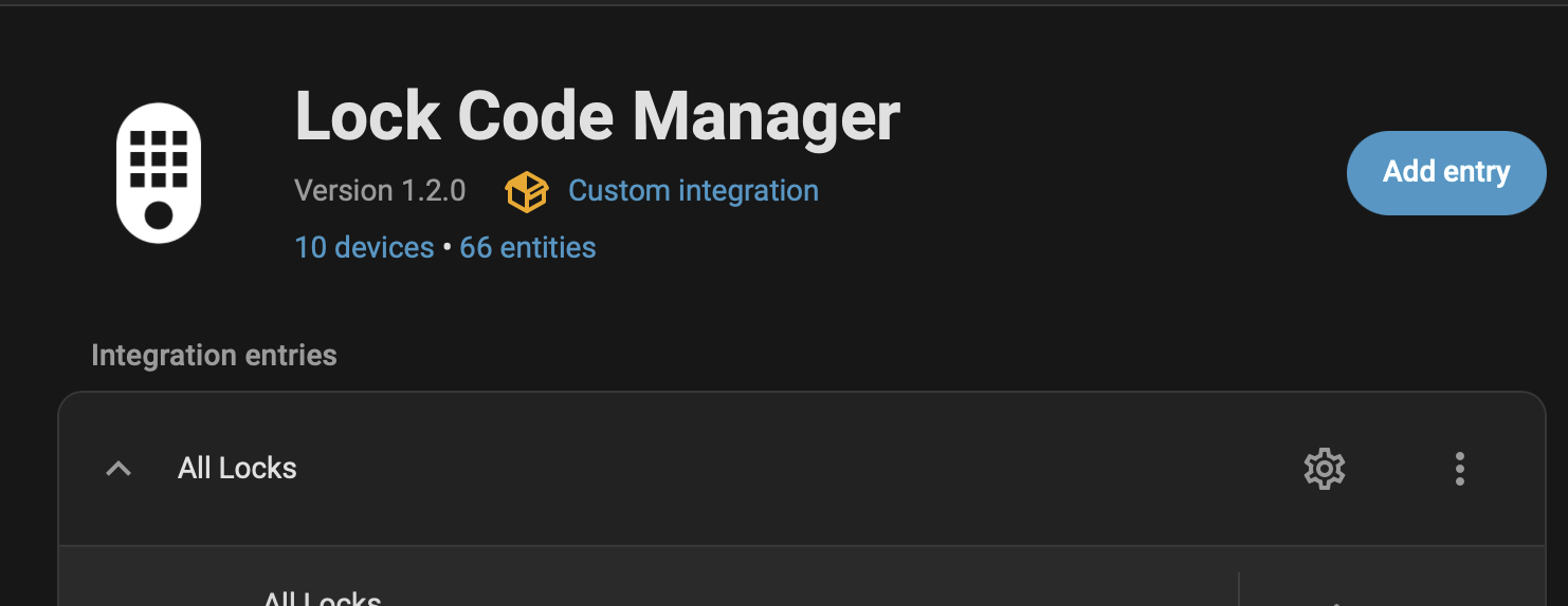

Go to Settings > Devices and Services > Lock Code Manager which should take you to the LCM page. On your config entry, you should see a gear icon towards the right. When you click that you will see a YAML block at the bottom where you can add a definition for slot 6
