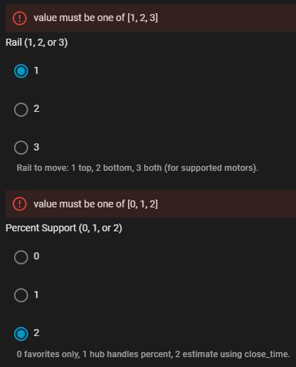

Anyway thanks for all the efforts scodes, setup was easy and working 100% (when the controller behaves). Only issue I have is with the buttons selection giving me an error even though I have selected numbers. Can only get it to save on selecting 1 and 0.
getting the same error
I have summitted a pr on github with a fix, although an ai bot has picked up another minor issue. Fix config flow radio option validation by flamingtoast123 · Pull Request #1 · shahedsalehi/Home_Assistant_NeoSmartBlinds · GitHub
