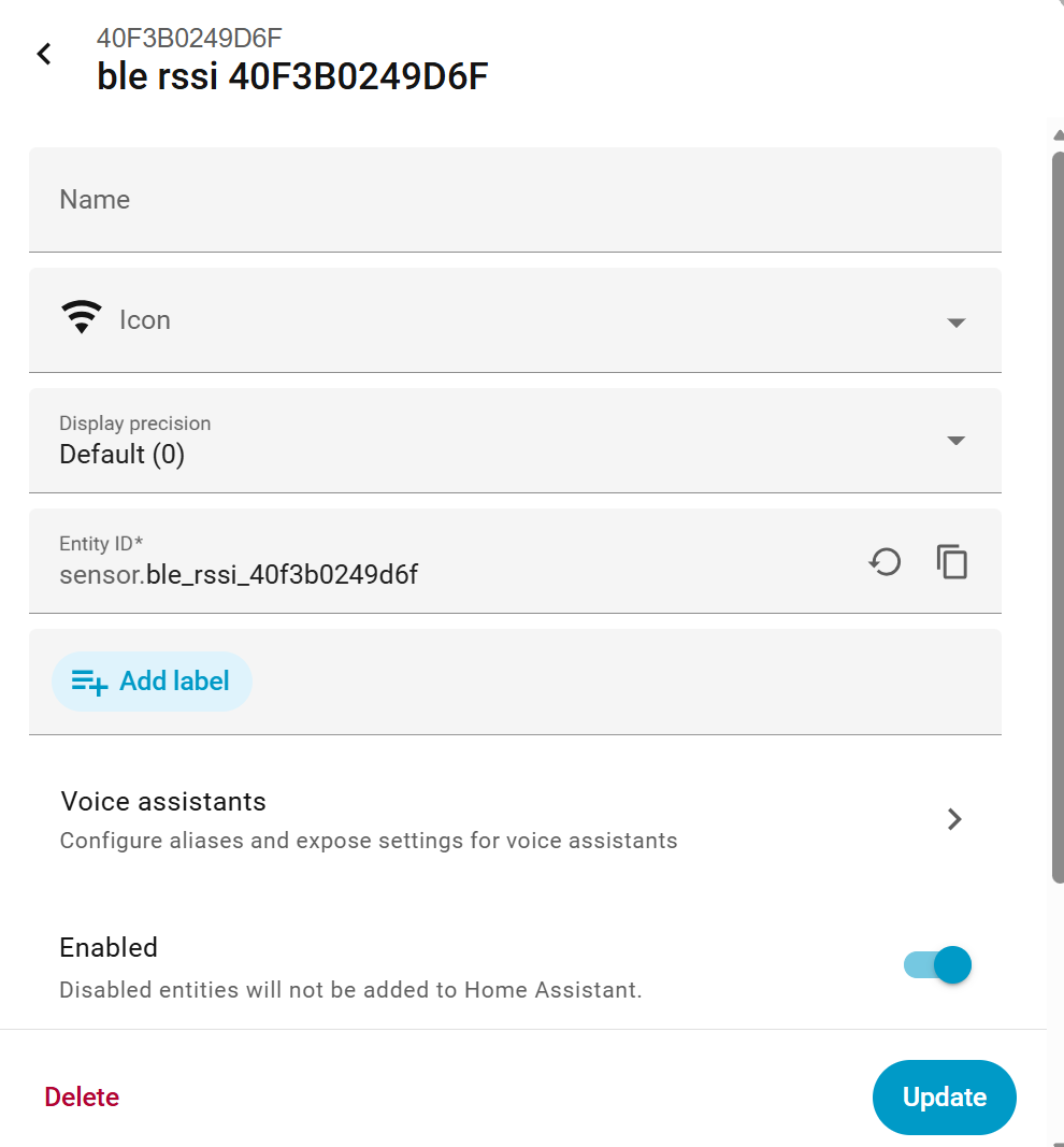

When removed from config, the entity shall no longer be provided and you will get
note: this is an example from another integration, but message is the same “entity no longer provided”
then the delete button will be available on the bottom left
if many, go to entities - filter on Nikobus integration and status unavailable - select - then top right corner “…” - then delete
