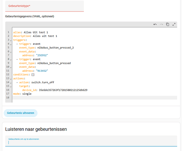

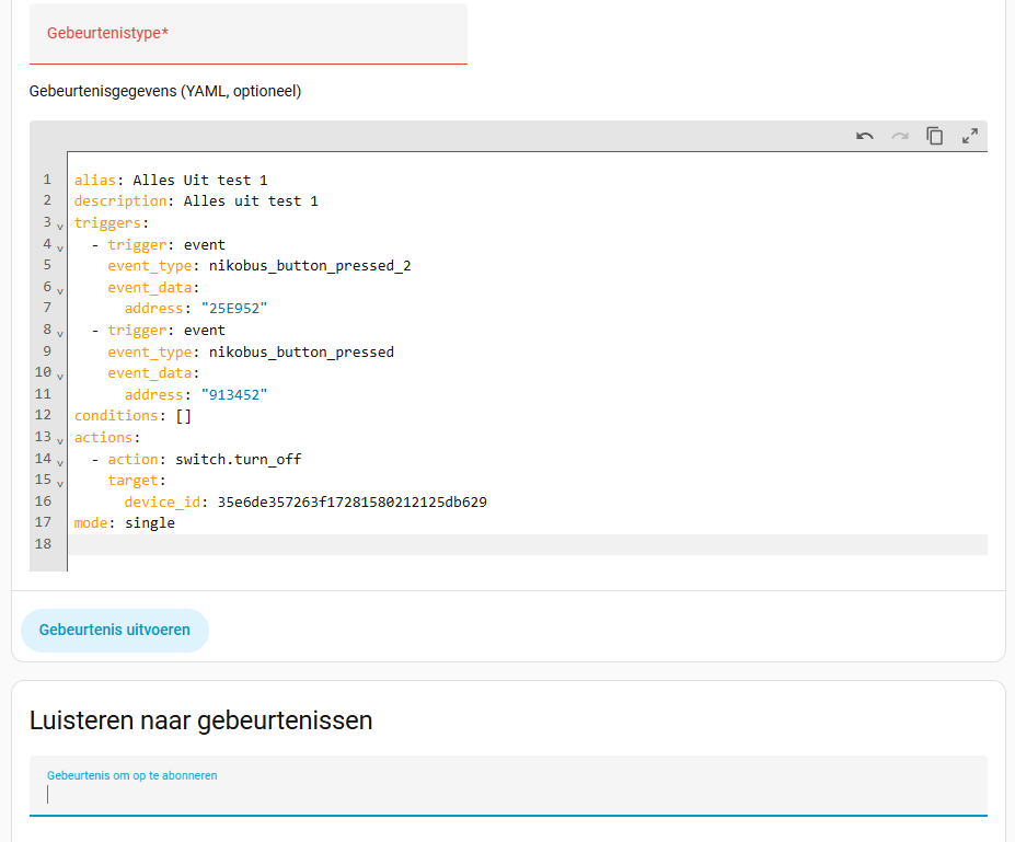

When I use your address 25E952 it is indeed replaced by a null, when I use my address 9A93EE, it is not
Try this in your event data, use 9A93EE without quote just to see if the address remains or replaced by null.
address: 9A93EE
That would explain why I can’t reproduce your problem, my address works 9A93EE and yours do not aka replaced by null 25E952
What is happening
  • 9A93EE contains letters (A, E) so YAML (and HA’s UI) keeps it as a string.
  • 25E952 is only digits plus E, which YAML can interpret as scientific notation (25E95225 × 10^952) if it is treated as a number-like token.
  • Home Assistant’s automation UI then tries to parse/validate it as a number (or JSON-ish value), fails/overflows, and the value ends up being written back as null.
So: 25E952 is being misinterpreted as a numeric exponent token, not a plain string. That is why it gets “eaten” and replaced by null, while 9A93EE survives.
That will be a nice one to crack, at least we know why now.
We must use address : " xxxxxx", now why it’s not firing with timer_2, will check once home.
If you want, paste the exact event payload from Developer Tools → Events (listen to nikobus_button_timer_2 and press that physical button). I can confirm whether the event uses address as a string, and whether it is upper/lowercase, padded, etc.
This also explains perfectly why:
  • 9A93EE works unquoted
  • 25E952 breaks
Sorry for my question, I never used this before.

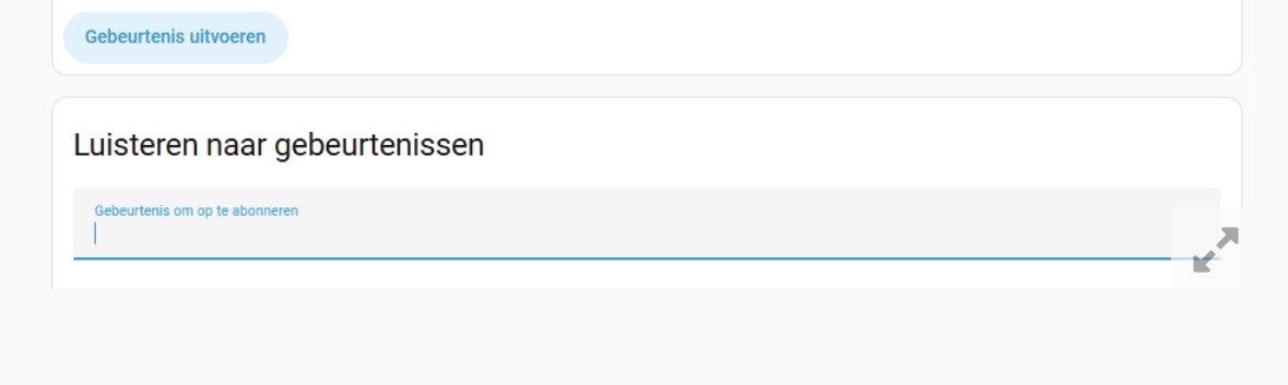

What should I fill into the field ‘Gebeurtenistype’ (Eventtype)
Just look at the bottom section, the top one is not relevant in this case / not used.
Input the name of the event you want to listen, eg nikobus_button_press and hit start.
Then press a physical Nikobus button and see if the event is being fired on that very same ha screen. You can do that for any nikobus_button_xxxx event.

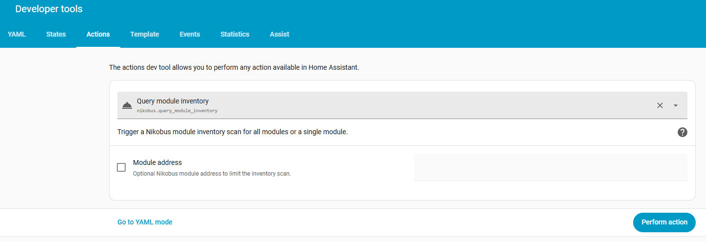

If you have a PC Link module and it’s used for connectivity
You can now use module_discovery, execute it without checking the “module address” box, this is reserved for future use.
1- It will create a file /config/nikobus_module_discovered.json
The file will have the full inventory of your modules and address

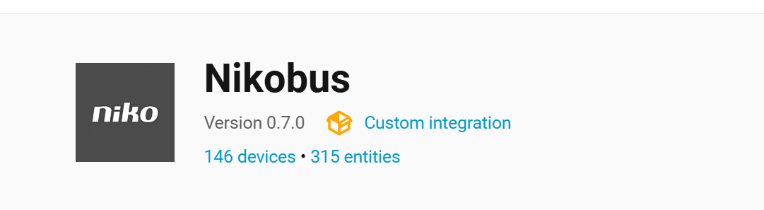

I just upgraded to 0.7.0b.

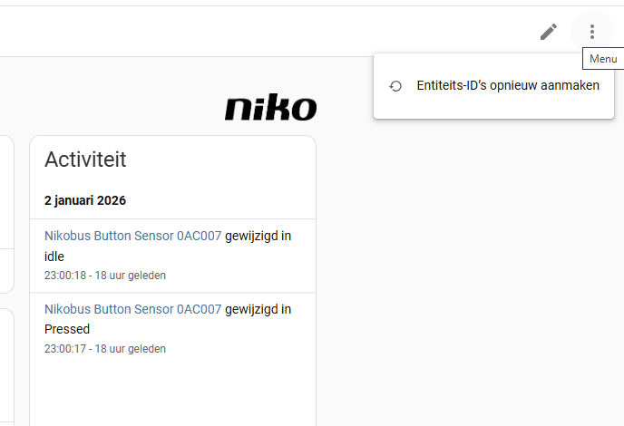

The documentation says
  1. Go to Settings → Devices & Services → Integrations
  2. Open Nikobus
  3. Click Entities
  4. Use Recreate entity IDs
Where is the ‘Recreate entity IDs’ option?
Is this the button you mean?
Do I have to do this for each device , or for each entity?
I first ask it because I have 216 devices and 488 entities of Nikobus :grinning:

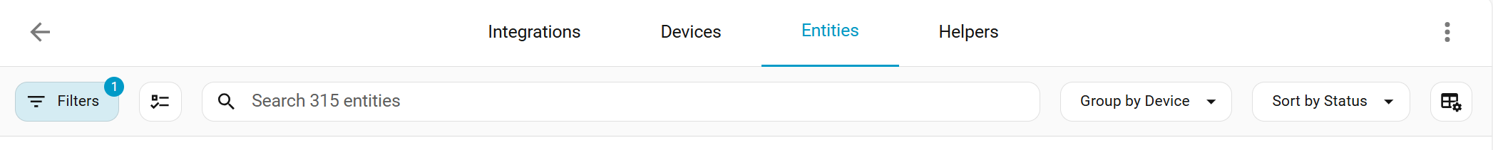

You can all at once :slight_smile: not one by one…

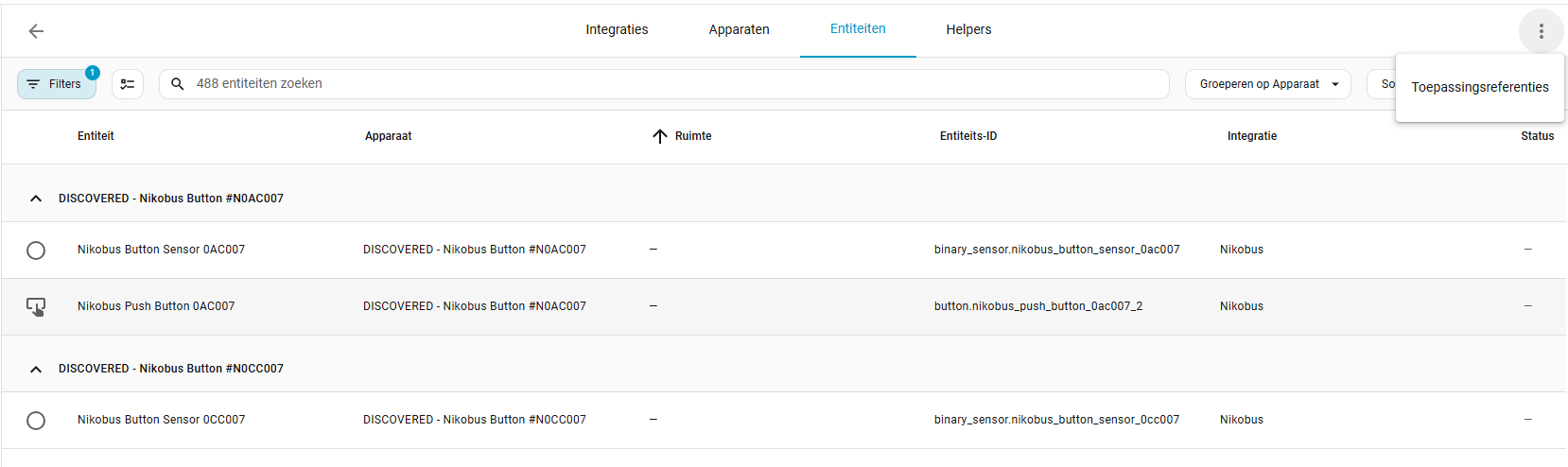

click entities here → “315 entities”
Then … top right
You should have re-create entities ID, cannot show you as mine are already done.
I don’t see the re-create entities… :cold_sweat:
I found it.
I had to select them all :partying_face:
Will update the readme :slight_smile:

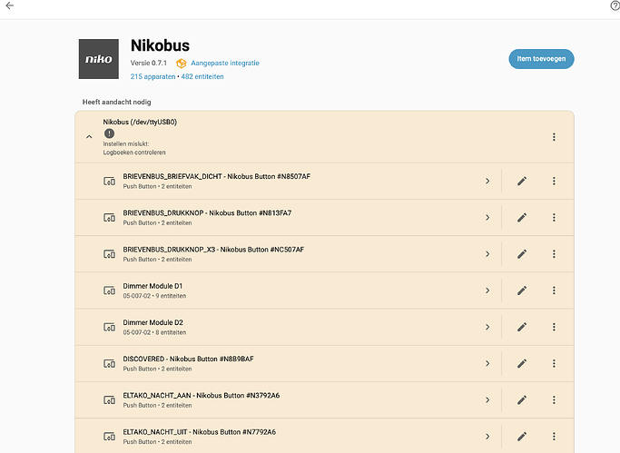

@fdebrus I noticed that for the most recent version of HA and the 0.7.1 version of the add on I often a config failed message get see screenshot below
If I click reconfigure and leave all settings as is it says configuration successful.
Not sure why it gives the failure message. It didn’t use to do that in the past after restarts
