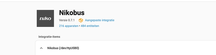

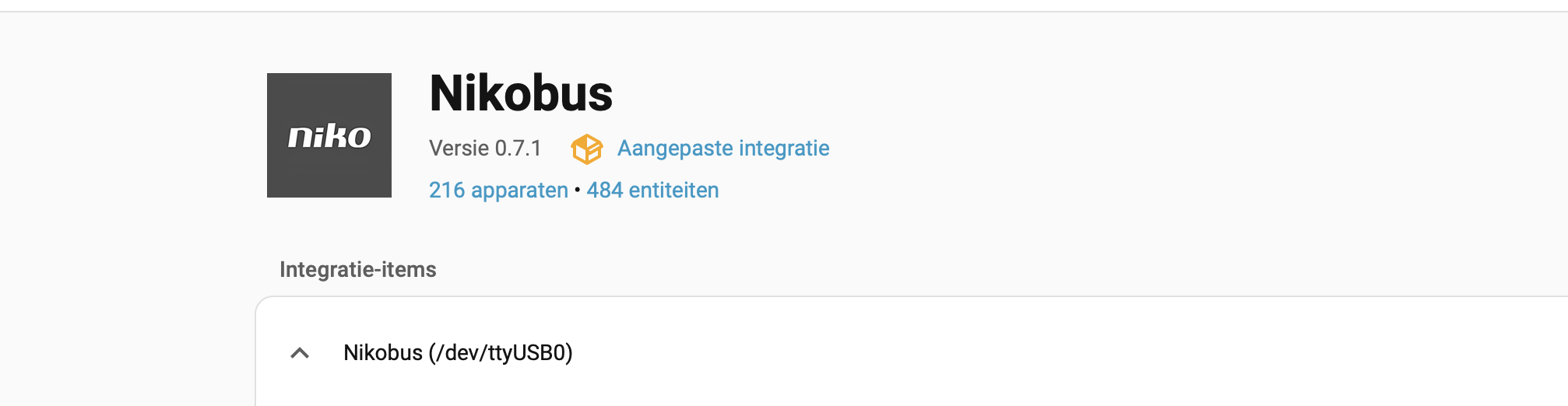

indeed 0.7.2 works now. It does say 0.7.1 though but is the new one.
yeap, just re-created the 0.7.2 with the 0.7.2 tag :slight_smile: just re-download.

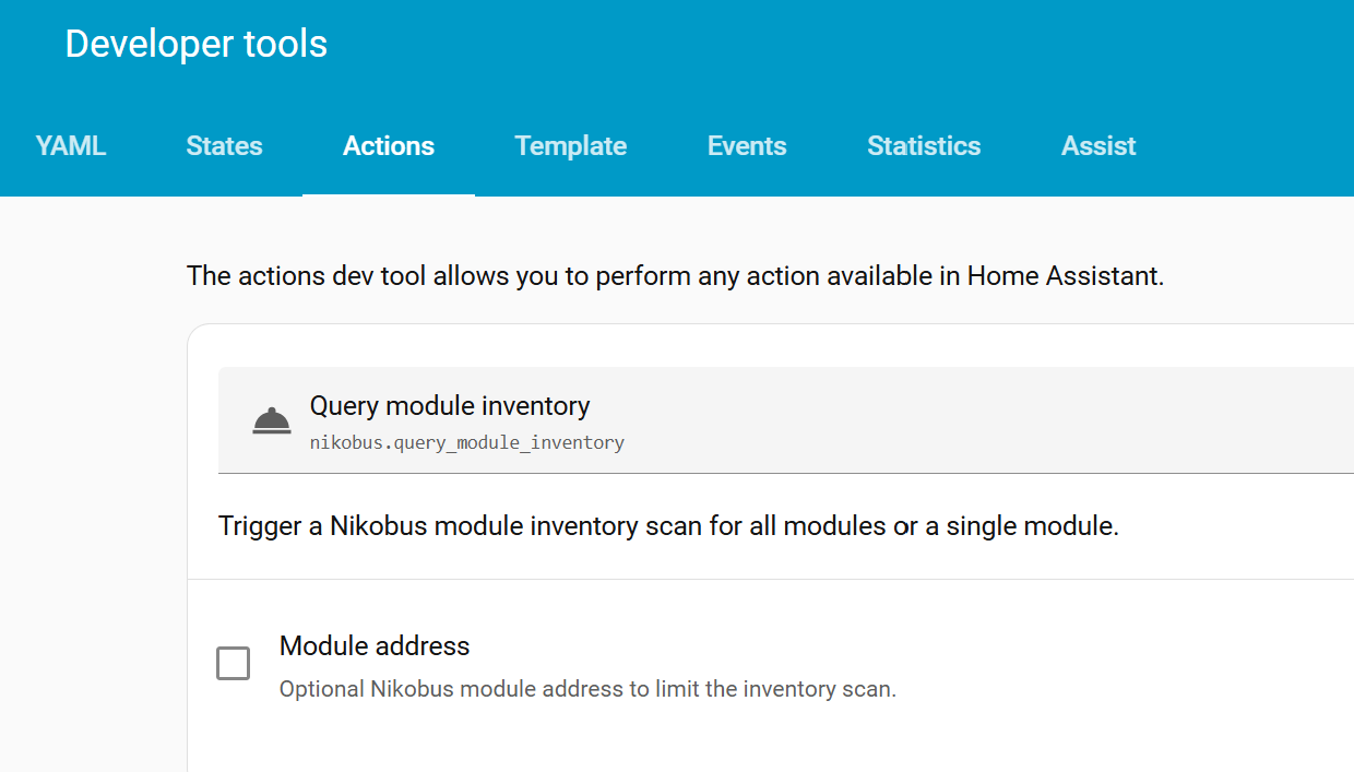

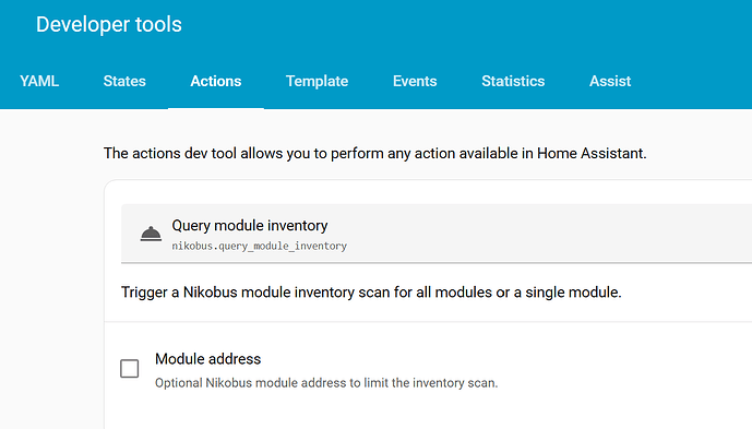

I will need more log, enable debuglog, filter on “niko”, restart, send the log
Also you can try to run the discovery, do not input any module address, this action will create a nikobus_module_discovered.json file in the config directory (only to assist the user to setup the integration, not actually used by the integration) and the nikobus_button_config.json file will be updated or created.
Wait a couple of minutes, taking the inventory from nikobus takes time.
