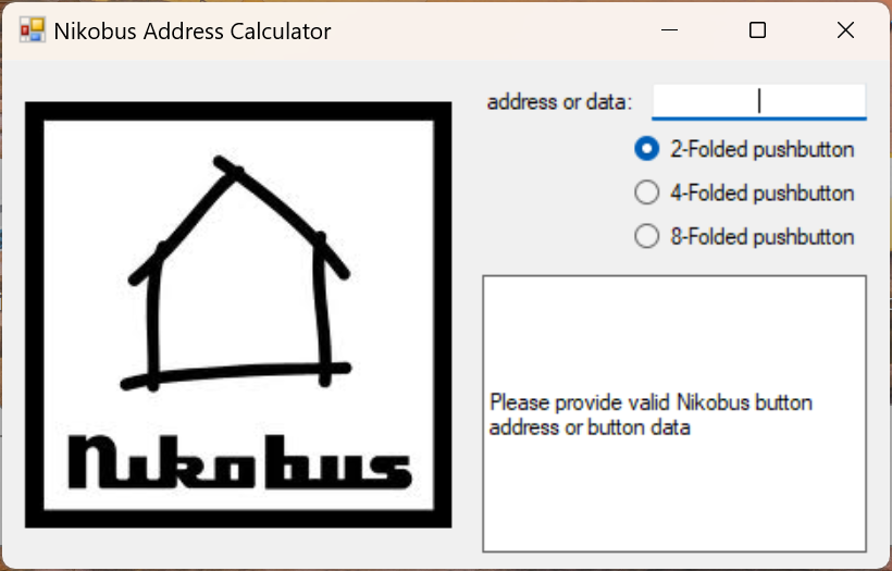

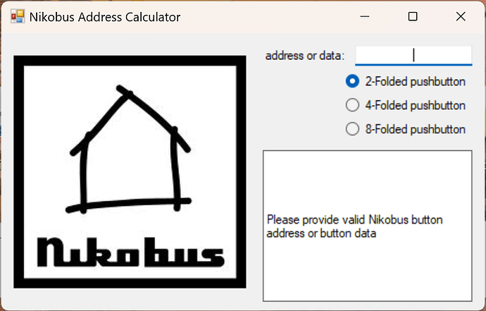

an alternative is the nikobus address calculator that I’ve uploaded to the repo, the zip is here: fdebrus/Nikobus-HA

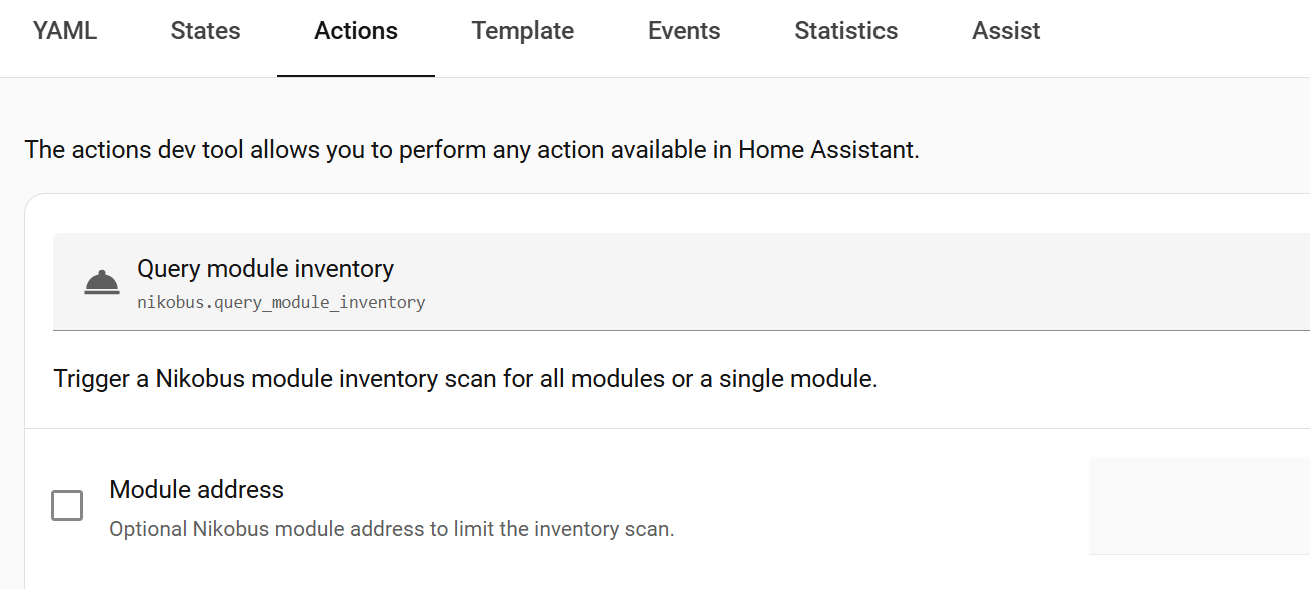

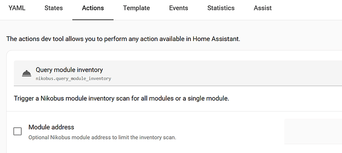

Very experimental, your could also instead run the discovery from HA developer tools, it ‘should’ populate button address from discovered button
Discovery_info will be added to the button_config file

Should I run the Nikobus address calculator if I also have the Nikobus software open and connected to the PC link? Or does it work on its own?
When I try to start the query module inventory, HA gives the following message: “Unknown action selected?”
What am I doing wrong?
Yes, standalone “calculator”
Yeap, not stable yet…
