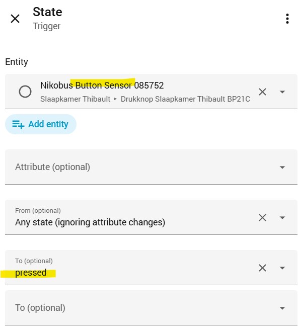

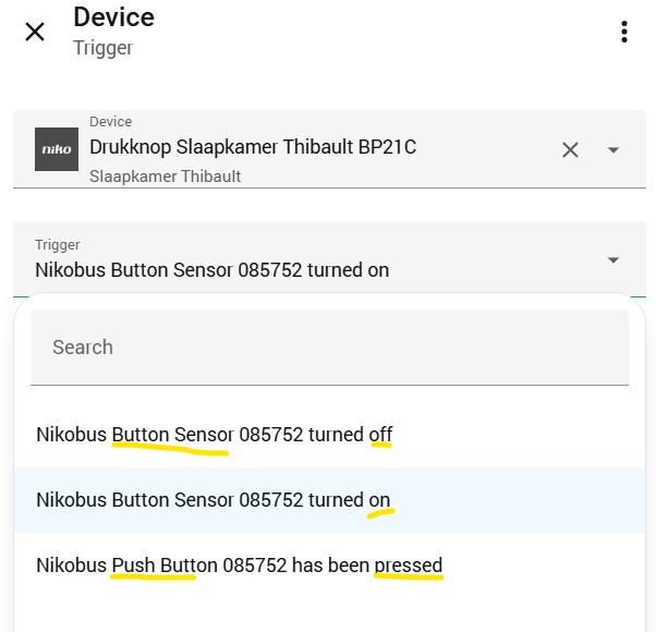

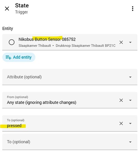

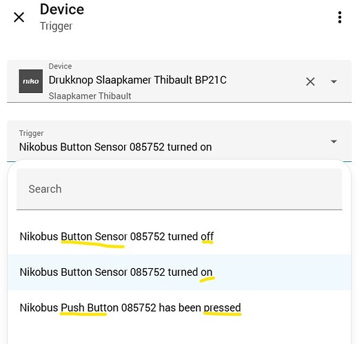

I have a question concerning using a nikobus button as trigger in an automation with the visual editor.
I experience that the results of ‘nikobus button sensor’ and the ‘nikobus push button’ are somehow reversed?
Isn’t the state of the “Button Sensor” = “idle” or “pressed” and not “on” or “off”?
When I create a manual state with trigger entity “Nikobus Button Sensor
” and use the custom state ‘pressed’ all works fine:
Can you please advise what i am doing wrong?
Kind regards, Geert
You should look at events, they are more rich and allow more granular control
fdebrus/Nikobus-HA
I will look at the behaviour you have with button, but triggered event is the right path. revert might you need any assistance to set this up.
I will have to retry with the current public version, but upcoming release 0.8.0 will be like
But I’m focusing on the integration performance for upcoming release,
 couple of weeks still needed.
There is indeed a naming conflict with button and button sensor in the current release. will be solved in the next one.

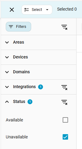

I just upgraded the Nikobus intergartion to Version 0.7.4, and now my cards doesn’t find the enities anymore. Are those been change again? I know that I had to recreate them all after upgrading to 0.7.0 , and change all my cards
should not, but if so it’s a 5 min fix.
let say you had entity kitchen_light
if somehow a new entity was created because of unique_id change you should now have
kitchen_light - unavailable
kitchen_light2 - the new entity

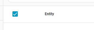

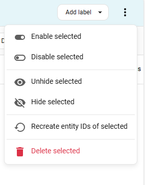

If this is the case, go to Nikobus integration - Entities
Filter on the entities that are not available
select them all from this button
Then top right 3 dots
Delete them all and restart, you might have to restart 2x
Then back to normal, your kitchen_light - unavailable is gone and kitchen_light2 - the new entity is back to kitchen_light
Changing internal unique_id never influence your code or card; your are always using the entity_name and you can always recreate the name.
Could you tell me how you upgraded ? using HACS ? or copy/paste ? this should not happen, either way, easy fix :slight_smile:
Any message in the log ? I will be out this evening but will check tomorrow for feedback.
Recreating the entities did the trick. Now it’s working again.
