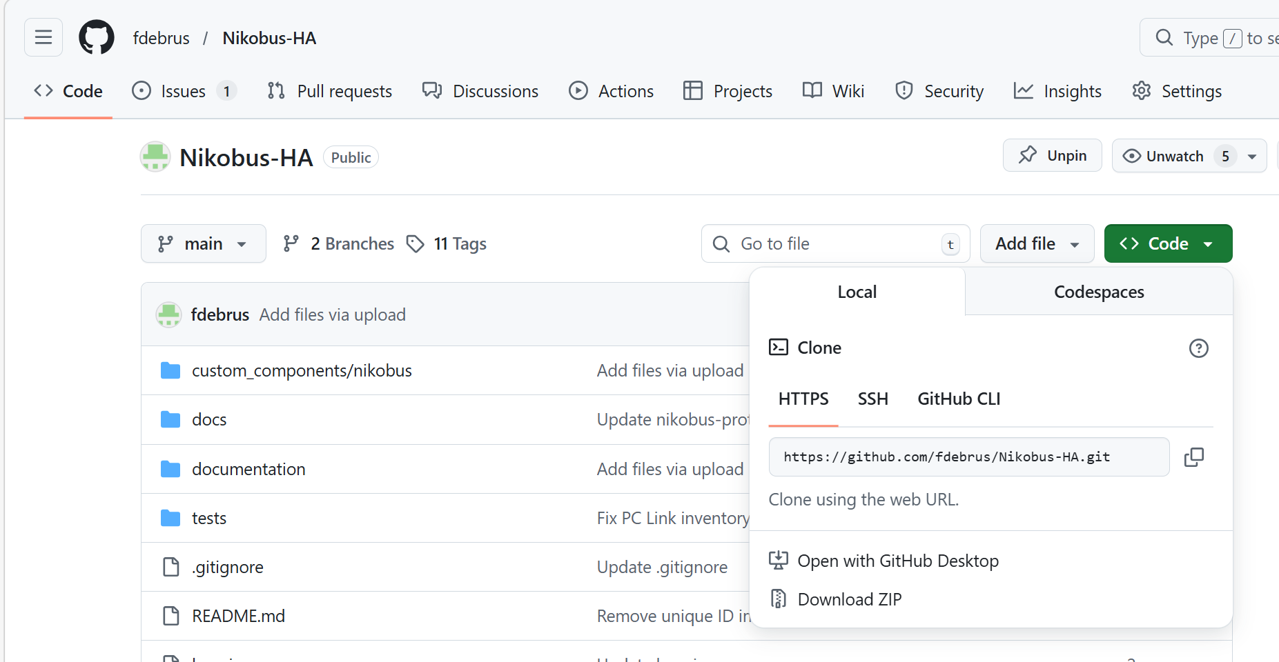

go to the repo, code - download zip and overwrite your ha /config/custom_components/nikobus
Restart HA, this will give you the 0.8.0 which has many performance improvements and the operation_time_down implemented. Update your cover module like
{ ā€œdescriptionā€: ā€œSalon Volet Terrasseā€, ā€œoperation_timeā€: ā€œ48ā€, ā€œoperation_time_downā€: ā€œ45ā€ },
ā€œoperation_timeā€ is the operation_time UP, I’ve not renamed not to introduce a breaking change.
If you are not confortable doing the manual upgrade, wait for the 0.8.0 official release.
