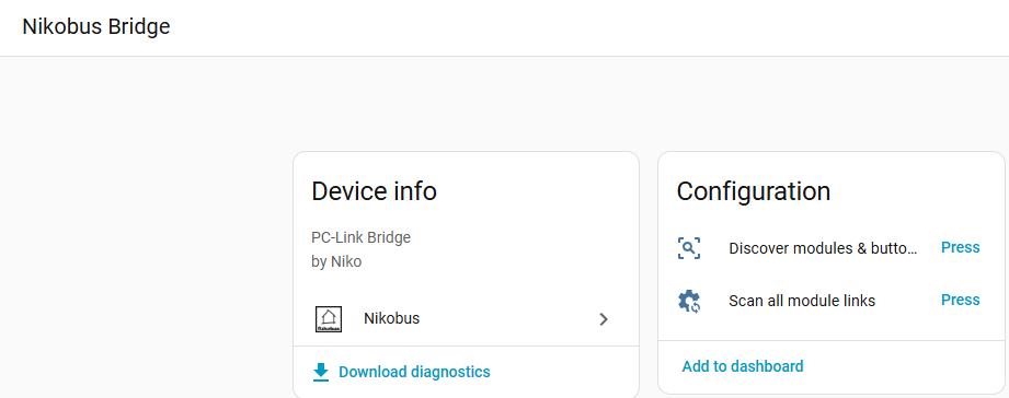

Once setup, find the “Nikobus Bridge” device, click “Discover modules…” wait, integration will reload itself, then “Scan all module…”, have a coffee :slight_smile: this one will take minutes to completes as it queries all modules and their register. Avoid using Nikobus buttons or others while this run, if it happen, no worries, just run again, both can be executed as many time as needed to completion.

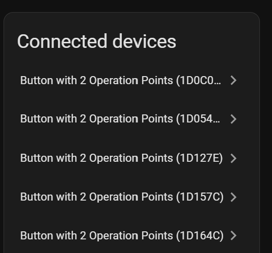

I have all my buttons and modules automatically discovered, let’s figure out what is special in your config and make it work.

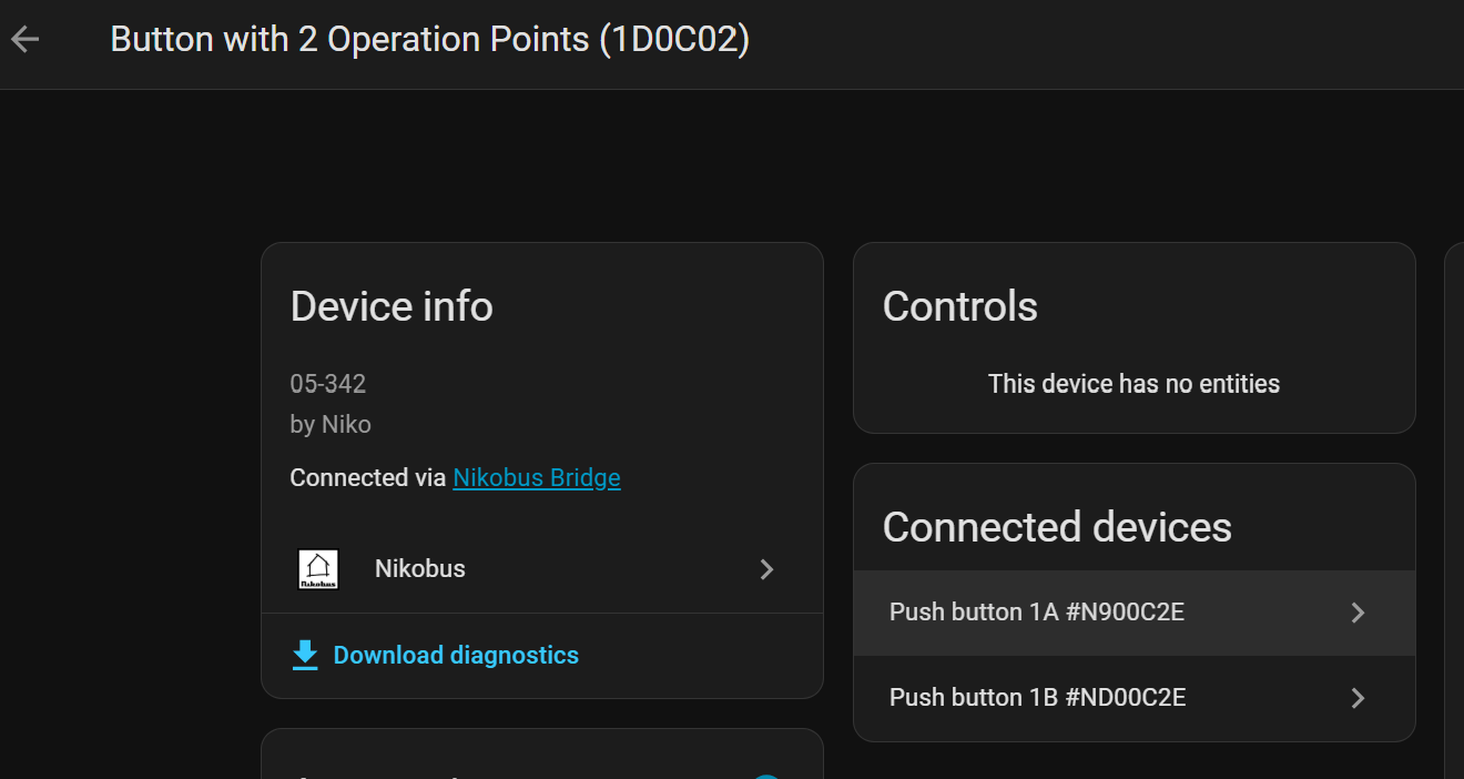

do you now see your wall button definition in the “Nikobus Bridge” ?
and for each wall button their push button ?

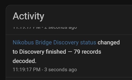

The scans and update process itself worked I saw the counting of the 12 modules and the integration showing some kind of address scan for each module

  1. Open a fresh GitHub issue at Issues · fdebrus/Nikobus-HA · GitHub with [discovery] in the title. Attach files to the issue (GitHub accepts file uploads on comments — .json etc. are fine).
  2. Attach the diagnostics dump from the integration: Settings → Devices & Services → Nikobus → ⋮ → Download Diagnostics. That packages the post-discovery storage state in one file — already redacted, no manual scrubbing needed.
  3. Attach the two .migrated sidecars: <config>/nikobus_module_config.json.migrated and <config>/nikobus_button_config.json.migrated. Those carry your pre-2.0 hand-curated truth and let me diff what discovery thinks should be there against what you know is wired up.
  4. One log snippet during a clean discovery run. Enable debug:
logger:
   default: warning
   logs:
      custom_components.nikobus: debug
      nikobus_connect: debug
Restart HA. Press Discover modules & buttons, let it finish. Press Scan all module links, let it finish. Then save the HA log (just the section spanning the two runs is enough — usually 5-15 minutes worth) and attach.
That gives me four things at once: what the bus reports (log), what discovery actually wrote (diagnostics), what the legacy file knew (migrated), and what bytes the chunk decoder rejected/accepted (debug log). With that I can usually point at a specific decoder line.
If a single GitHub issue would be too noisy, breaking it into one issue per bucket ([discovery] 05-057 not mapped, [discovery] PC Logic virtual buttons not exposed, [discovery] multi-module button links incomplete) would also work — the first three are definitely separate problems with separate fixes.
The 12-module count and per-module register scan completing means the bus side is healthy. The gaps are downstream, in the decode/merge logic — and that’s debuggable from the data above.

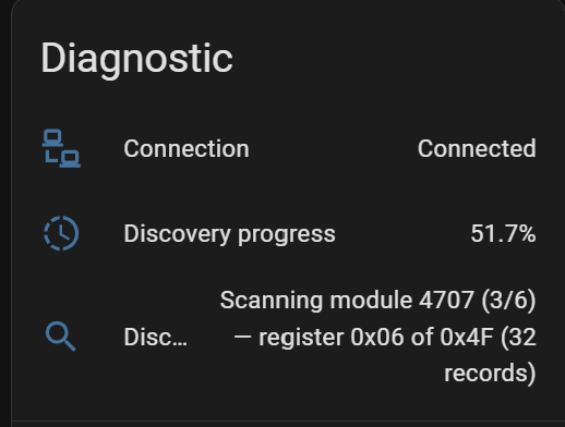

Hello and thanks for your great job! I was using Openhab before and when I found your module I directly migrated!
I have an issue :
When I try to discover new modules and buttons,the PC-Link inventory only goes to 96/240 and stop. Then I have the message in the settings saying that no buttons have been discovered yet. I try again and it’s the same, everytime.
I upgraded to 2.0.9 and nothing changed.
Any ideas of what I could do to make it work ?
Thanks !
