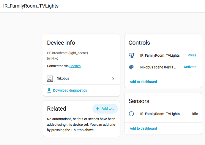

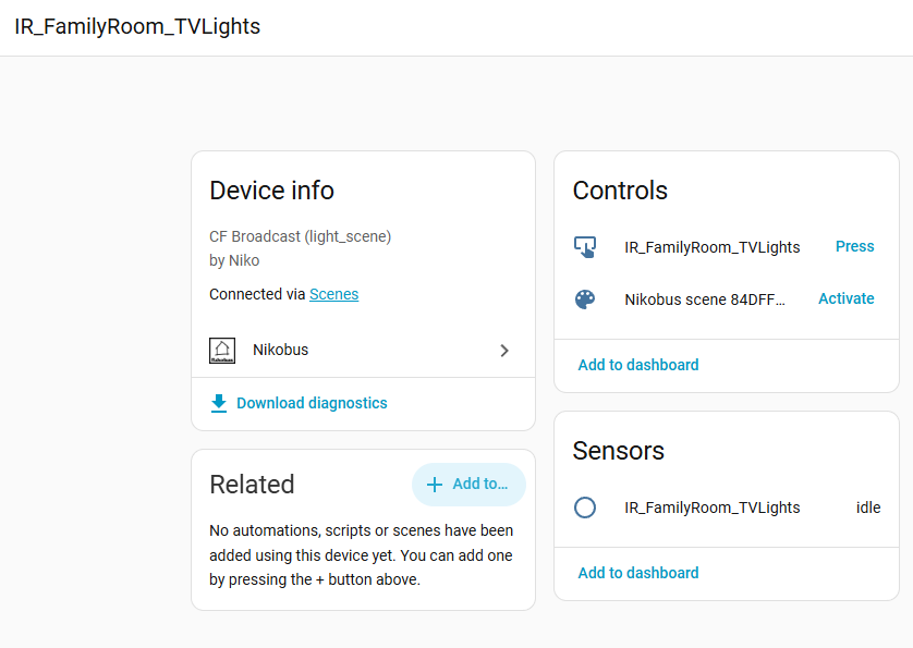

Today the integration decodes each scene from the bus and surfaces it like this:
Here, IR_FamilyRoom_TVLights is an IR code from a wall button with an IR receiver. When that code appears on the bus, Nikobus runs the scene HA only sees it and flips the matching sensor.
Under Controls you get the scene entity itself, so you can activate the scene straight from HA:
(Firing the underlying button/IR entity is an equally valid way to trigger it.)

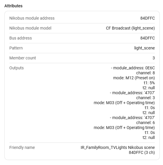

Open the scene's attributes and you can see its full definition the modules, channels and modes it drives:

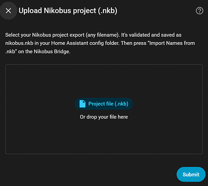

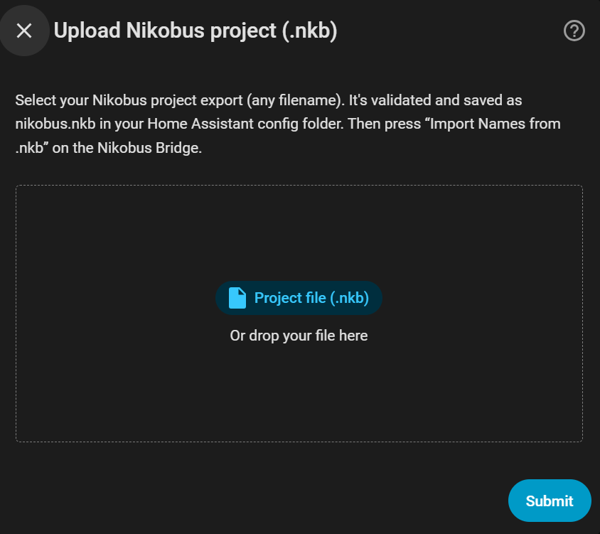

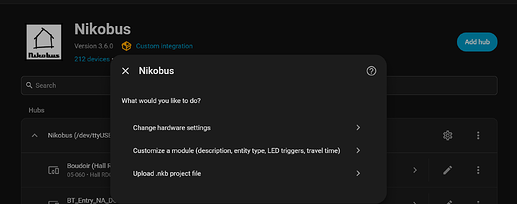

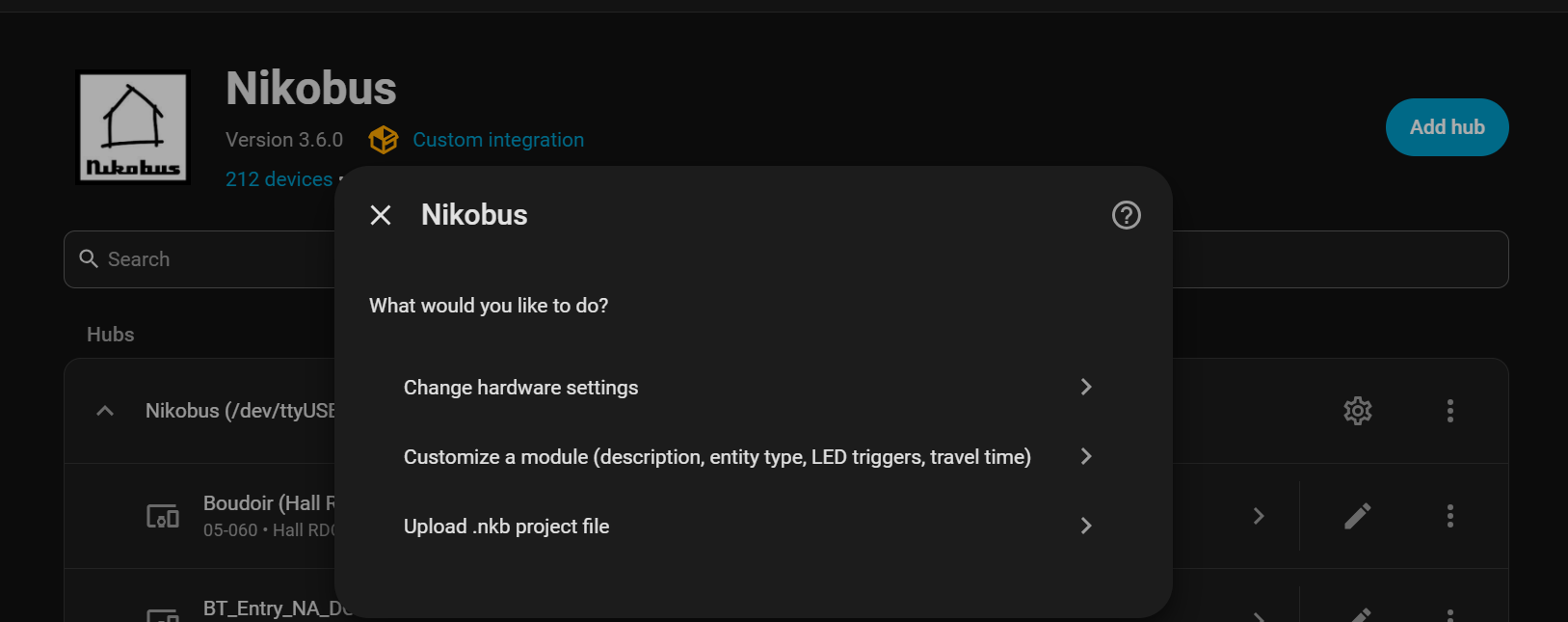

The config flow has now an upload .nkb config file to ease the process

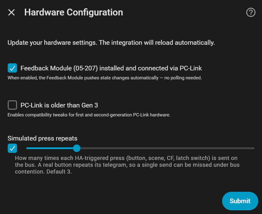

You can now set your simulated button press from HA repeats, default is 3.
