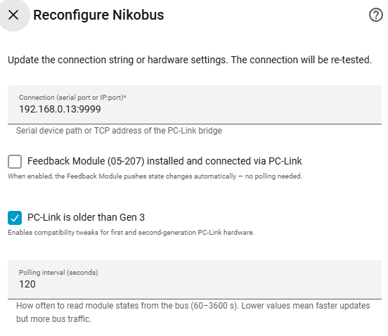

Also remove “PC-Link is older than Gen 3” option.

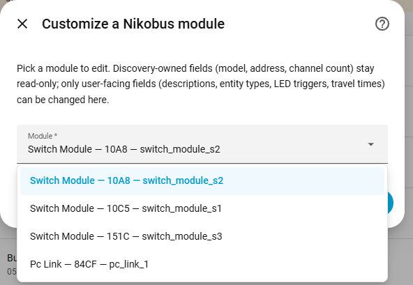

The config file isn’t read. I have nothing else than the PCLink now
I configured 4 modules, the 3 with the address as seen in OH and one where I inverted the 2 bytes.
I disabled the HUB
Then deleted the files from .storage, then restarted HA (restarted docker)
Then enabled again
But looks like the file is ignored at restart

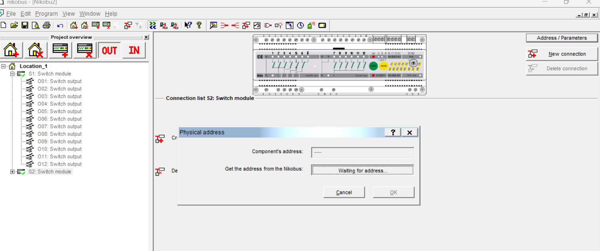

I found the Nikobus PC software and I was able to remove the 2 modules from the PC link. But for some reasons, I wasn’t able to add my 3 modules using the program… not sure how to use it. I was expecting it would read from the bus, but it couldn’t find any module. Maybe same issue as the integration ?
and also, when I press a button, it’s reported in the log and then when I use the address (which is the same as on OH) to trigger a click via action, it does work. So I think the bridge is working as intended
in the Nikobus software, with an empty project, you have the “load project overview” and “load existing installation”, once done and you see all your modules and config then you need to “Program module” - select them all and hit program.
DO NOT PROGRAM an empty project, you would loose all Nikobus config

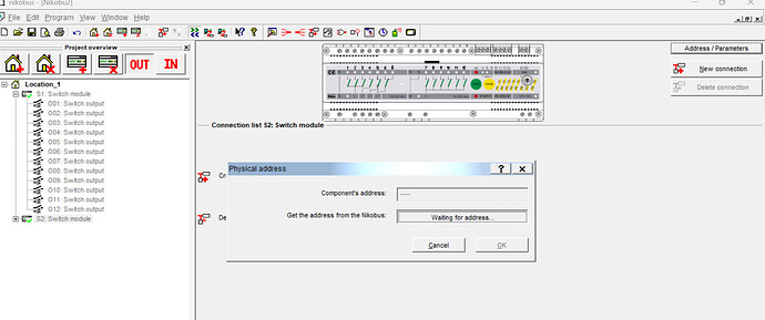

going to the nikobus SW, when I read the PC Link config, I just see the new module I added, but I can’t read its config
If >I add another module (in OUT), then searching for address, it doesn’t find anything
my bad, run the discovery in the Nikobus integration in HA. It will see the file and load it vs query the PC Link.
I just remember I changed that logic in the latest integration release. :face_with_raised_eyebrow:
If Nikobus software is not cooperating, leave it, you could end up with an erased Nikobus…
If you still want to play with nikobus software… for the module to emit its address on the bus while the nikobus software listen, you have to push the yellow “mode” button till it bippp.

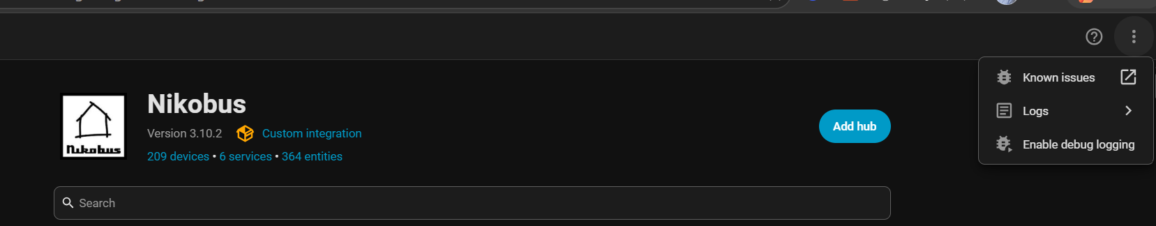

you have no enabled debuglog :slight_smile:
Nikobus integration - top right 3 dots - enable debuglog
then settings - system - log - filter on “niko” - 3 dots - show raw log

Not sure what fixed the issue to be honest. I ended adding the 3 modules in Nikobus SW and programming the PC Link. That’s probably what did the trick. But at the same time I fixed the addresses in the config file, so it’s one or the other, but IT WORKS now :slight_smile:
Thank you so much for your time.
