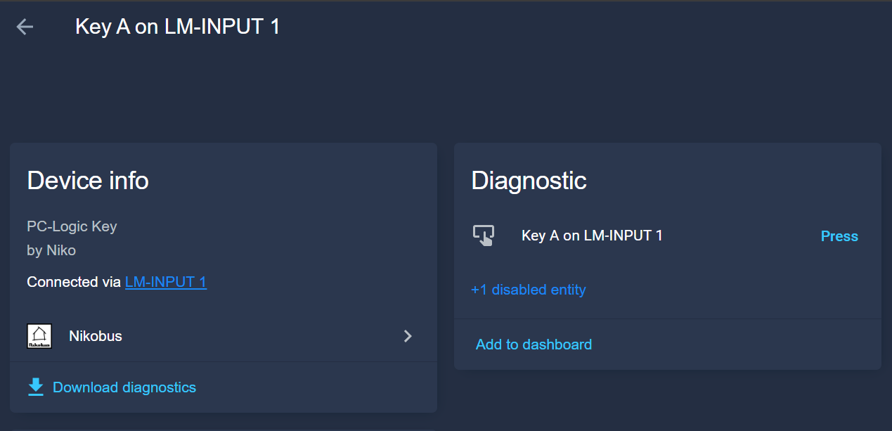

Now, I connected the ‘real’ sensors, and have problem, that. it doesn’t work anymore.
None of the A/B helpers change. I have sensors thay are connected to the Logic-module, and also to the Interface-Module, and none of them change. The connection to the modules are correct, since the status is shown correct on the modules screen.
Is the something changed on that part?
I will test tomorrow all 12 imputs in detail again.
Check that the sensor is not disabled ?
if you try, enable debuglog before, we always need it to troubleshoot
All the connection to the module are normaly 1.
When opening a window, the become 0.
I have created the debug-log-file, I opened the window that is connected to the 1st input of the interface, module, an closed it again.
Where can I upload it, because it’s to big for the forum
Open an issue on the GitHub Issues · fdebrus/Nikobus-HA · GitHub

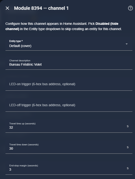

Covers that stay calibrated
Any cover motion commanded from Home Assistant that ends at fully open or fully closed sends a stop frame after a configurable delay by channel. That erases the small drift the position estimate accumulates over time. Intermediate positions and an explicit Stop are unchanged.
A roller channel that still carries the discovery placeholder of 30 seconds takes its travel time from the run time programmed into the module itself, so the position model matches the hardware out of the box. A value you set on the channel yourself still wins.
