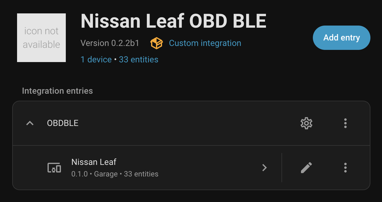

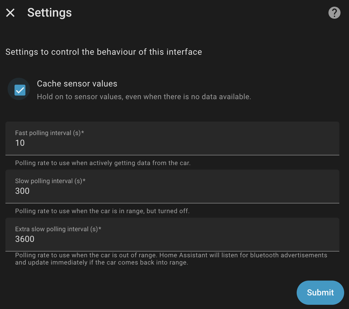

Yes you can:
Click the settings gear here:
Change the slow polling interval to something shorter:
Remember: when the car comes back into range after being away, the BLE advertisement will trigger an update immediately, no need to wait.

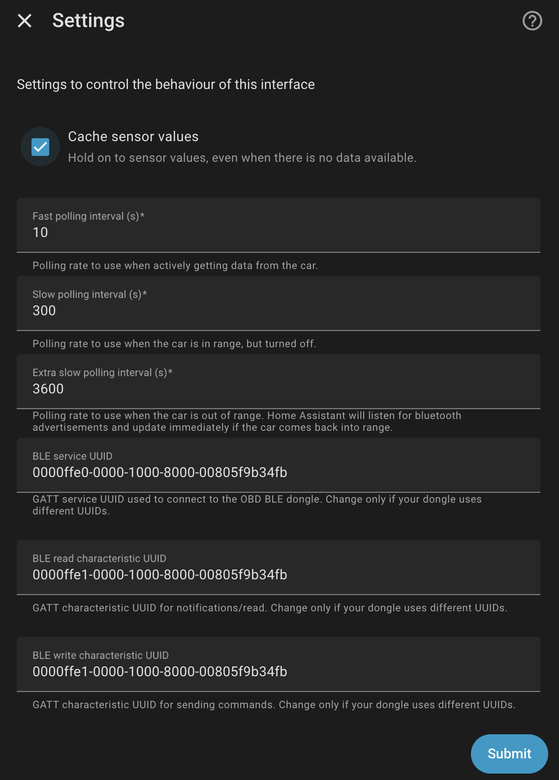

Ah - very relevant point.
Since all that has moved to a python package, it is no longer editable.
I’ve pushed a new update to both the HA component and the python package to allow configuration of the UUIDs from HA (v0.3.1b1). Please test it.
Instructions here: GitHub - pbutterworth/nissan-leaf-obd-ble · GitHub

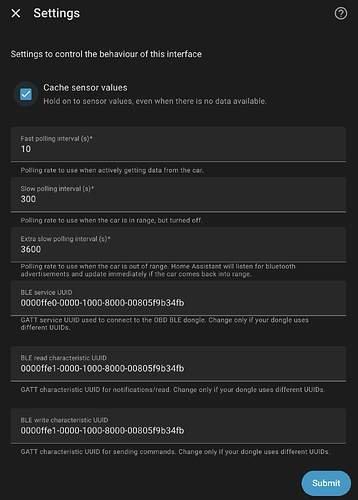

Good day! Version 0.3.1b2 is currently installed. I’m monitoring it.
I am currently testing v0.3.1b2 and seems to be working well. A couple of items I would like to check about. I ticket the “Cache sensor values” box however when I restart HA all the data comes up as unknown, should this be expected? Is there anyway to change it so the data remains? The second item is that I have a 2018 Nissan Leaf, when the car is switch off and locked the values in HA are no longer updated, is this to be expected? If so any ways around it? Thanks
