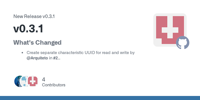

Updates:
v0.3.1 — significant stability improvements. Have been testing this for several weeks and haven’t had a single lock-up.

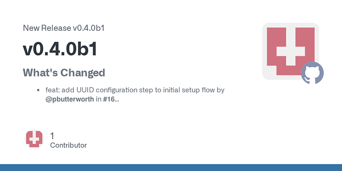

v0.4.0b1 — pre-release: @128203ro have implemented, but not tested, a scheme for customising the decoders without needing the modify the python package. Please experiment.
