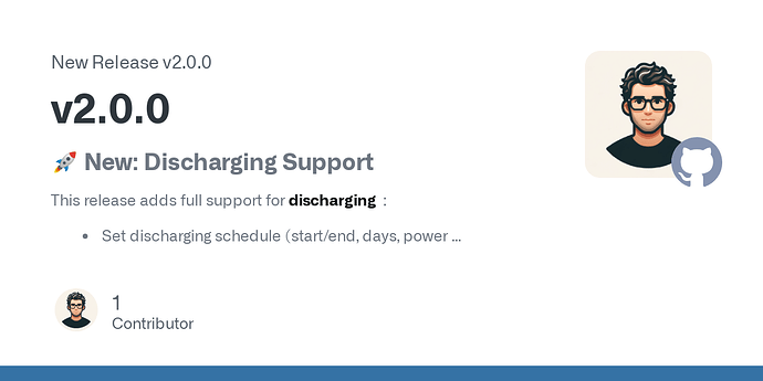

I am currently testing a new version of my integration.
In the “Time-of-Use” mode, the next version will have the option of discharging the battery after a set time and power.
This is currently also possible with the SAJ app.
This will be available in a few days

To make the new version instantly available in Home Assistant via HACS:
Go to the integration in HACS → click the three dots right side neben SAJ H2 Modbus → select “Refresh information”.
Hey Stanus74, thanks for the update. Exporting & Importing now works great. Bought you another 5 coffees for that . This was really what I was looking for. Great work! Cheers!
