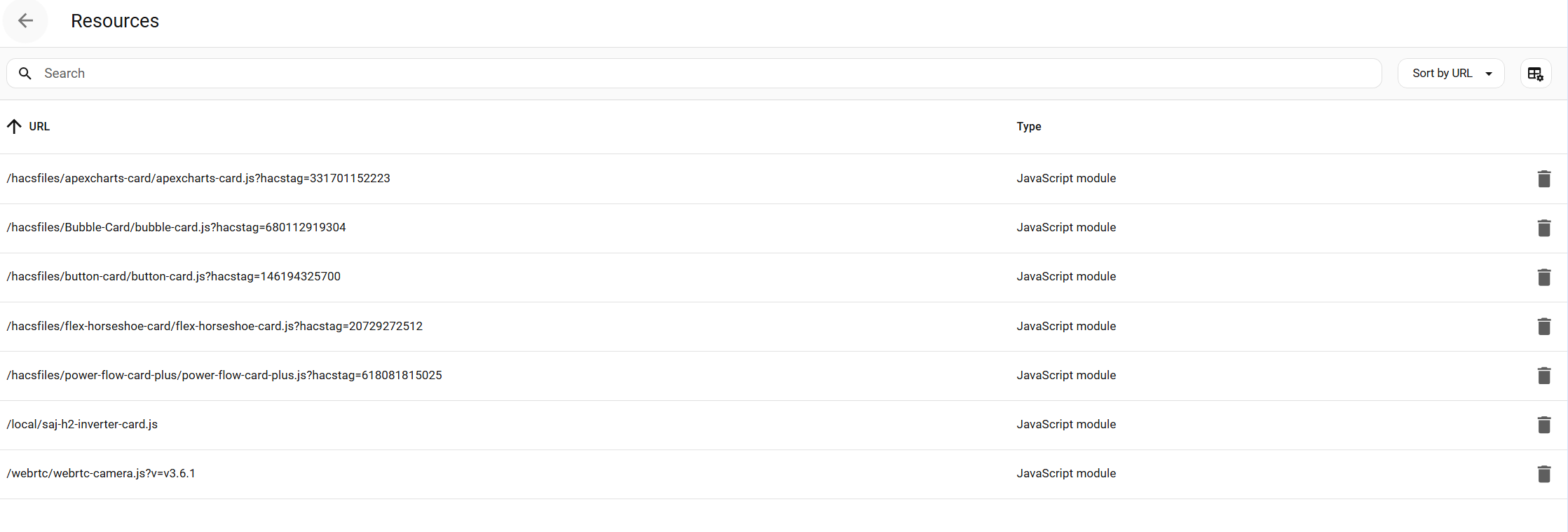

Hi Stanus74,
I have a problem with configuring the SAJ charge/discharge card
I have uploaded the latest saj-h2-inverter-card.js (see screenshot)
I have added the resources (see screenshot)
I’ve done the refresh with the cache
I have added a custom card on my dashboard with these details
“title: SAJ H2 Inverter Control
type: custom:saj-h2-inverter-card
mode: both”
But this card keeps on giving the error:
  • Custom element not found: saj-h2-inverter-card
everything is updated to the latest available version
I could use some help here :slight_smile:
the JS FIle is not loaded
see Instructions to Reload Page
it’s working now. thx!
