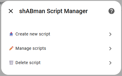

I’m excited to introduce my new custom integration shABman – a Shelly Script Manager right inside Home Assistant!
What is shABman?
shABman lets you manage scripts on Shelly Gen2/Gen3 devices directly from Home Assistant – no browser or Shelly app needed. Everything runs locally via the Shelly RPC API.
:sparkles: Features

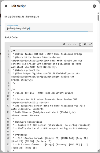

  • Create, edit & delete scripts – fully integrated into the familiar HA Options Flow
  • Switch entities per script – start/stop scripts and toggle autostart
  • Sensor entities – total script count & number of running scripts
  • Real-time updates via WebSocket – instant entity updates on status changes
  • Automatic backups – code is backed up before every edit/delete, with automatic rollback if an upload fails
  • HA Servicesupload_script, delete_script, list_scripts for use in automations
  • HACS compatible :tada:
  • Full English & German translations

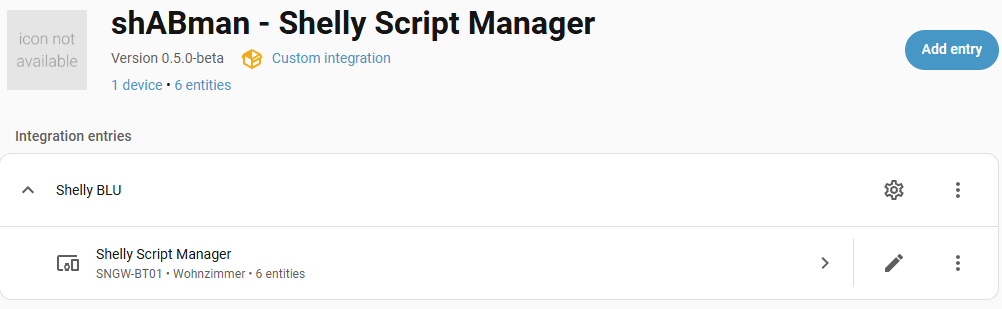

  4. Go to Settings → Devices & Services → Add Integration and search for „shABman"
  5. Enter the IP address of your Shelly device – done!
