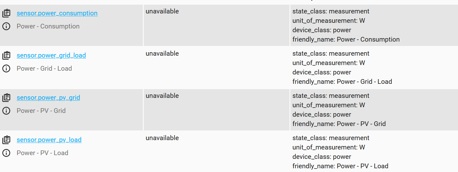

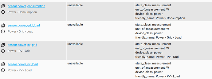

Can you help me with the template sensors, I copied it from the wiki page, but the sensors are always unavailable:
This is my config yaml:
# Loads default set of integrations. Do not remove.
default_config:
# Load frontend themes from the themes folder
frontend:
  themes: !include_dir_merge_named themes
automation: !include automations.yaml
script: !include scripts.yaml
scene: !include scenes.yaml
# Motion Sensor
template:
    - trigger:
      - platform: event
        event_type: motioneye.motion_detected
      binary_sensor:
      - name: Door Motion
        unique_id: "Door_Motioneyeos_detection"
        state: "true"
        device_class: motion
        auto_off: 30
# Solar Edge
    - sensor:
      - name: "Power - Solar Generation"
        unit_of_measurement: "W"
        device_class: "power"
        state_class: "measurement"
        # DC power from inverter
        state: "{{ float(states('sensor.solaredge_i1_dc_power'), 0) }}"
        availability: "{{ has_value('sensor.solaredge_i1_dc_power') }}"
      - name: "Power - Consumption"
        # The net of inverter and grid power
        state: "{{ float(states('sensor.solaredge_i1_ac_power'), 0) - float(states('sensor.solaredge_m1_ac_power'), 0) }}"
        availability: "{{ has_value('sensor.solaredge_i1_ac_power') and has_value('sensor.solaredge_m1_ac_power') }}"
      - name: "Power - Grid - Load"
        state: "{{ min([float(states('sensor.solaredge_m1_ac_power'), 0), 0]) | abs() }}"
        availability: "{{ has_value('sensor.solaredge_m1_ac_power') }}"
      - name: "Power - PV - Grid"
        state: "{{ max([float(states('sensor.solaredge_m1_ac_power'), 0), 0]) | abs() }}"
      - name: "Power - PV - Load"
        # What is being generated less what is being exported, always positive.
        state: "{{ max([float(states('sensor.power_solar_generation'), 0) - float(states('sensor.power_pv_grid'), 0), 0]) }}"
        availability: "{{ has_value('sensor.power_solar_generation') and has_value('sensor.power_pv_grid') }}"
edit
Seems that I don’t have “sensor.solaredge_m1_ac_power”
only have:
“sensor.solaredge_i1_m1_ac_power”
With this sensor it’s working
