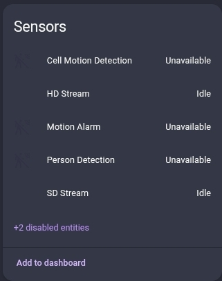

Hello, i have two C460 camera with solar pannel and one C225 camera.
on both C460 i don’t have binary sensor motion detection or person detection (i use automation for notify) that i have on C225 camera… there are solution?

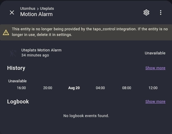

I use C310 and have been working, suddenly i noticed that motion and person detection (binary_sensor.) is disabled… Dont know how to get this to work or what changed??!
I tried to restart, remove it and add it again, but then there was no motion at all, so i had to restore a backup for it to “be as before”…
Dont know what to try anymore or what i need to do to fix this.
Read FAQ in readme.
Any solution for my problem?
ok, i read it, no solution for my problem! Thank you!

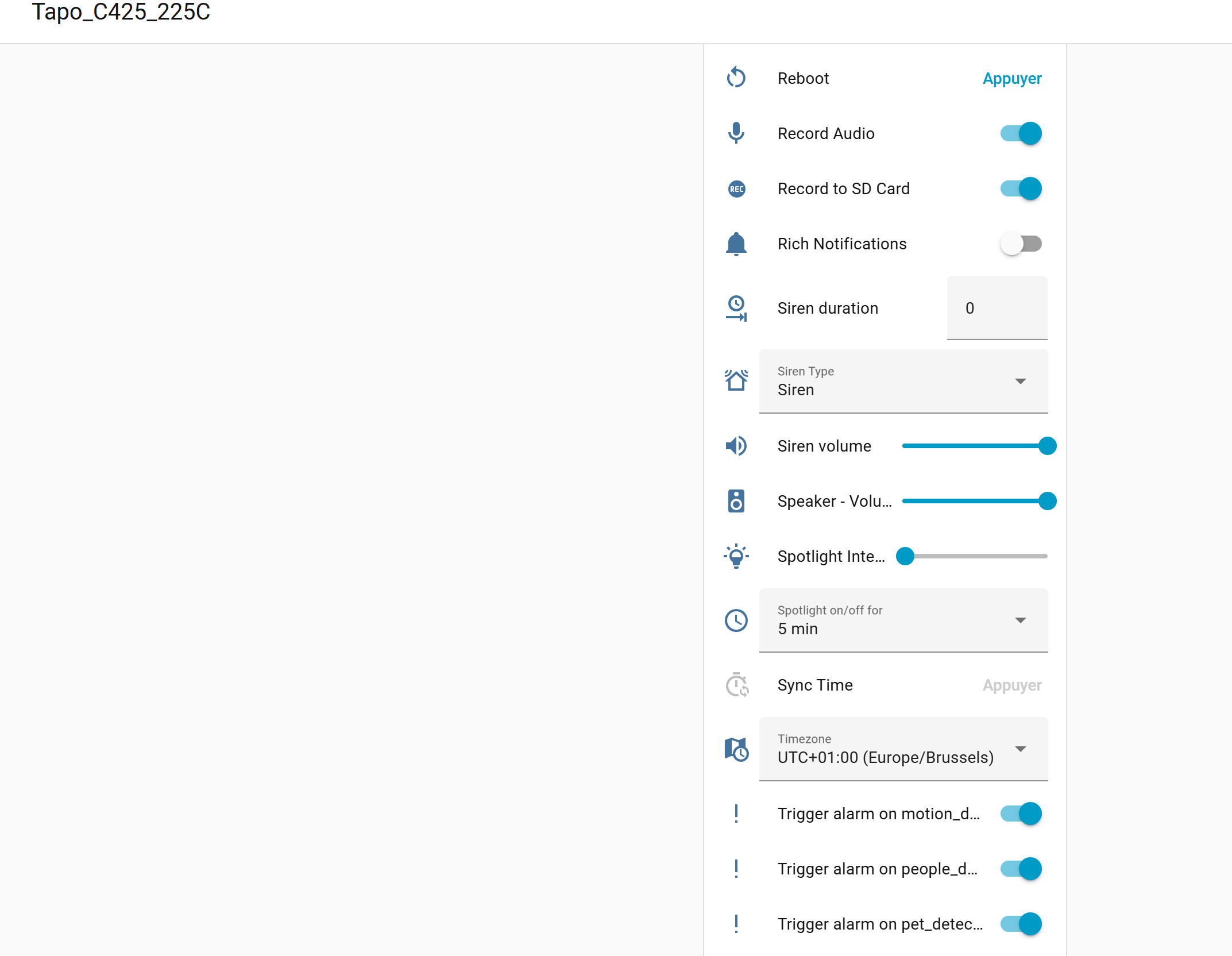

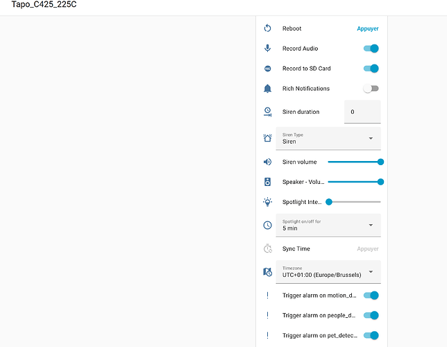

I just bought the Tapo C425 camera because I needed a battery-powered camera (there’s no power outlet on my wall). I was shocked when I tried to integrate it with Home Assistant to find that the motion sensor (the most important one) wasn’t there, even though all the other sensors were available (even the battery sensor???).
“The Tapo C425, being a battery-powered camera, does not support the RTSP protocol.”
It’s unbelievable and baffling. My other indoor Tapo cameras (C200, C500) work perfectly. Can you confirm this missing motion sensor? Or do I need to use a different system? If so, I’ll return my purchase to Amazon. Thank you very much.
The remaining solution is a Zigbee/Z-Wave motion sensor to serve the purpose and analyse image captured by Intégration google_generative_ai_conversation.generate_content (Gemini) . :innocent:
It’s clearly stated in FAQ.
  • Binary sensor for motion doesn’t show up or work
  • Supported models
thanks. It seems the WebHook solution would work for the Tapo C425. Can you confirm this, and if so, where could I see a concrete example of how it works?
But according to Claude.ai, "The Tapo application does NOT natively allow sending webhooks. You would need:
A third-party service like IFTTT or Tasker (Android)
Or use Tapo RTSP + a script."
What do you think?
In your opinion, would the only solution be the use of a dedicated motion sensor (Zigbee, Z-Wave, or Wi-Fi)?
Thank you.
