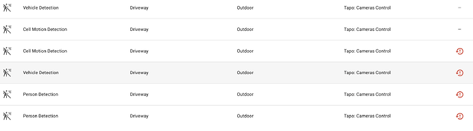

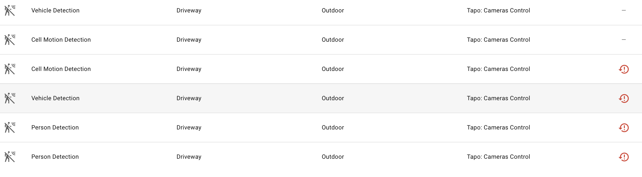

Just installed the latest update and it seemingly fried my sensors, creating duplicates across the board for all my cameras. Anyone else having issues?
No duplicates here after updating to latest.
