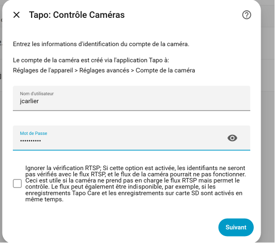

On the previous screen, I correctly entered my camera's username and password. I validated it in VLC: rtsp://user:[email protected]:554/stream1 and I get the camera image.

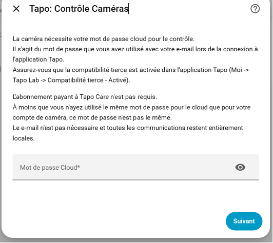

On the next screen, it forces me to enter the cloud password; I enter the one from the previous screen and I get an error, whereas previously, as far as I know, it worked.

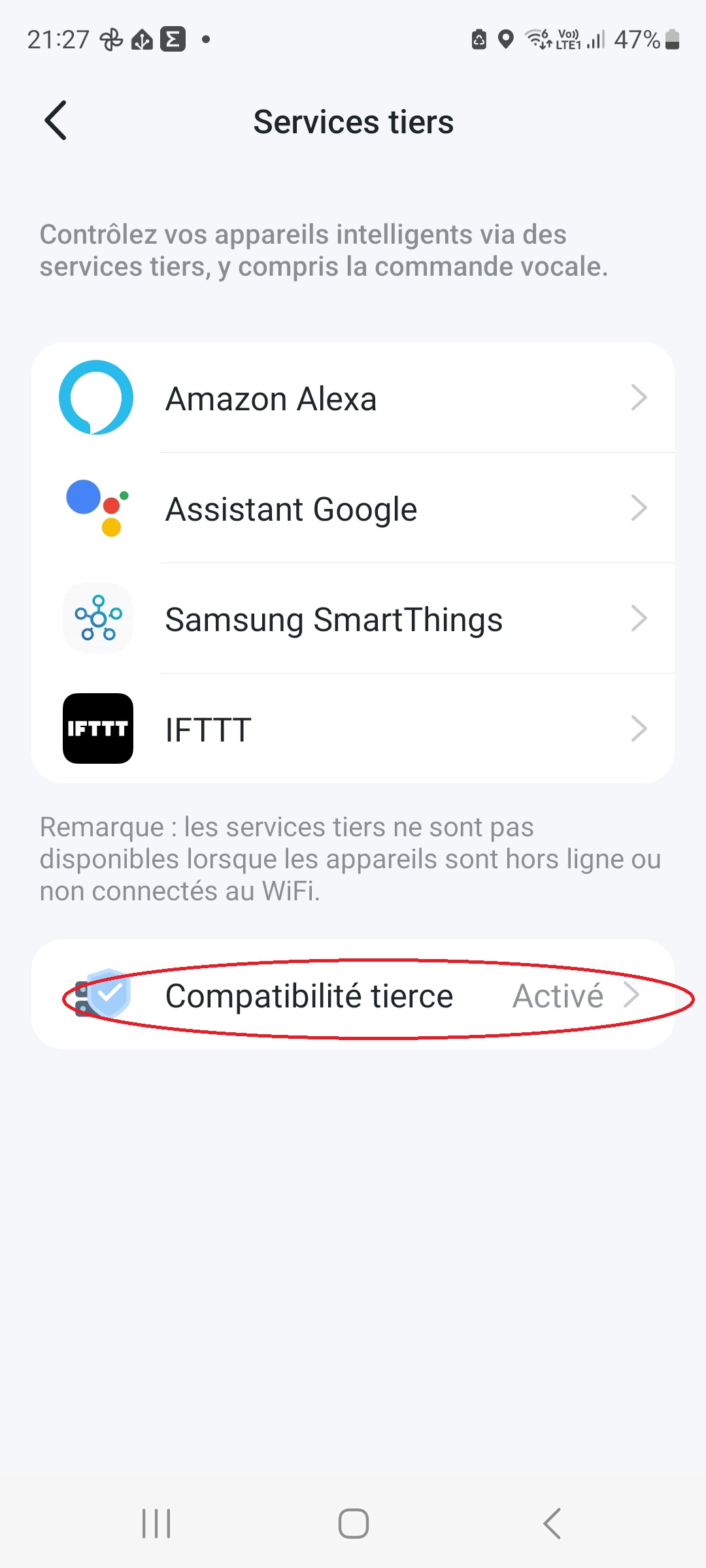

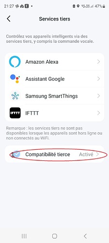

Follow instructions in your screenshot, what specific points do you not understand?
second screen:
third screen:
which password ???? (i have no cloud abonment)

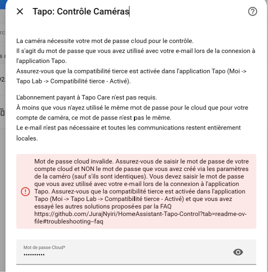

if i introduce the same as second screen
message in english:
Invalid cloud password. Make sure you enter your cloud account password and NOT the password you created via the camera settings (unless they are the same). You must enter the password you used with your email when logging into the Tapo app. Ensure third-party compatibility is enabled in the Tapo app (Me -> Tapo Lab -> Third-Party Compatibility - Enabled) and that you have tried the other solutions suggested in the FAQ: GitHub - JurajNyiri/HomeAssistant-Tapo-Control: Control for Tapo cameras as a Home Assistant component · GitHub
thanks
Your TPLink cloud account password that you used with your email when logging into the Tapo app...

i have only one passwword!! password of my app..
You have a TPLink account that you used to sign in into the Tapo app. There is no point in arguing, everyone has this. You can reinstall the Tapo app and will see you need to sign in...
ok i found the problem .. i change my password in : "TP-Link Account"
