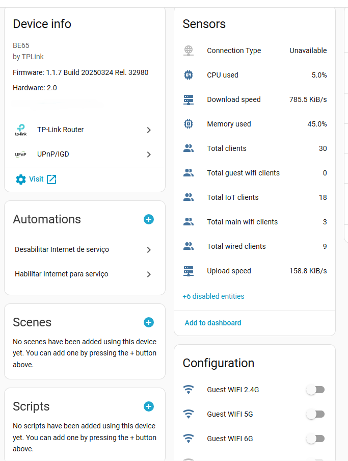

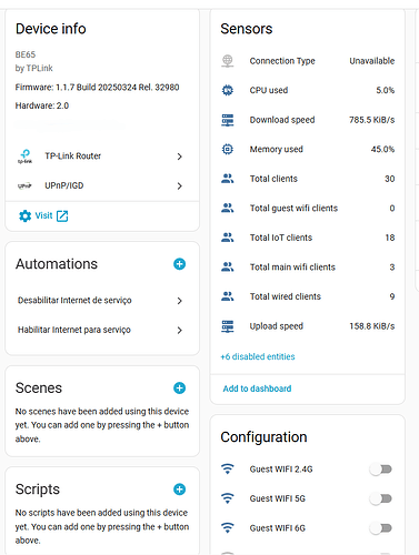

Hello, I’m having trouble enabling and disabling the guest network with my router. I’m using the Deco BE11000/BE65 v2.0 Firmware 1.1.7 Build 20250324 Rel. 32980.
The error displayed in the browser is:
“Failed to perform the action switch/turn_on. TplinkRouter - TPLinkDecoClient - An unknown response - Extra data: line 1 column 2 (char 1); Request admin/wireless?form=wlan - Response 1NvJjj8gn2cjK8MT2mpsiHZsAhzo8kOndgSXS2h7FF/BT2A2I/XSV7/pPuQGkuzs+NOjbrrtA6oQ3nKz0vibEhyY/KXIH0AHI66taWRV4RclzPudgJw/Gk4MMlRmqm0Dk+1nHbTiUPdNDJXYgwSIysSPKXw70gBmYMXcIrvriJdlQfuq8apngx98Z/p5/myKvN0RGzjj2wGgkmNoE2h7YoJd+rPC9Ubo/i7QgzW4Ch1ng4cbtrkegmsGTnYQ8ah2jYkmmkbK00TA1nS4/XkYHDtVk/U1x2IcL4cbQmMKCjDVq2Makv8nIJCkPCX15GPZE3+tTqaDaqYjvoDBzf4kIs9QJXweAJjKSpTRsGhBy9tbFS+m/HHvbVKW6fd9y6CDqfD12UKjo1iTYQKjjpts9c5MaoNyaqvS8q7Is4xwKtuPJAORSTuAMHdq3xkzX4ghzSF2385hE2T/+ekZ9wtcIc2v0jFksnJcC9yU5j5Fmb0KjPhoi2ieMJ4VINF8F8QhOmQ/pukn7cxIboYg9xKY3xkfKuMwoxMxH+jOTE8aZ9M=”
