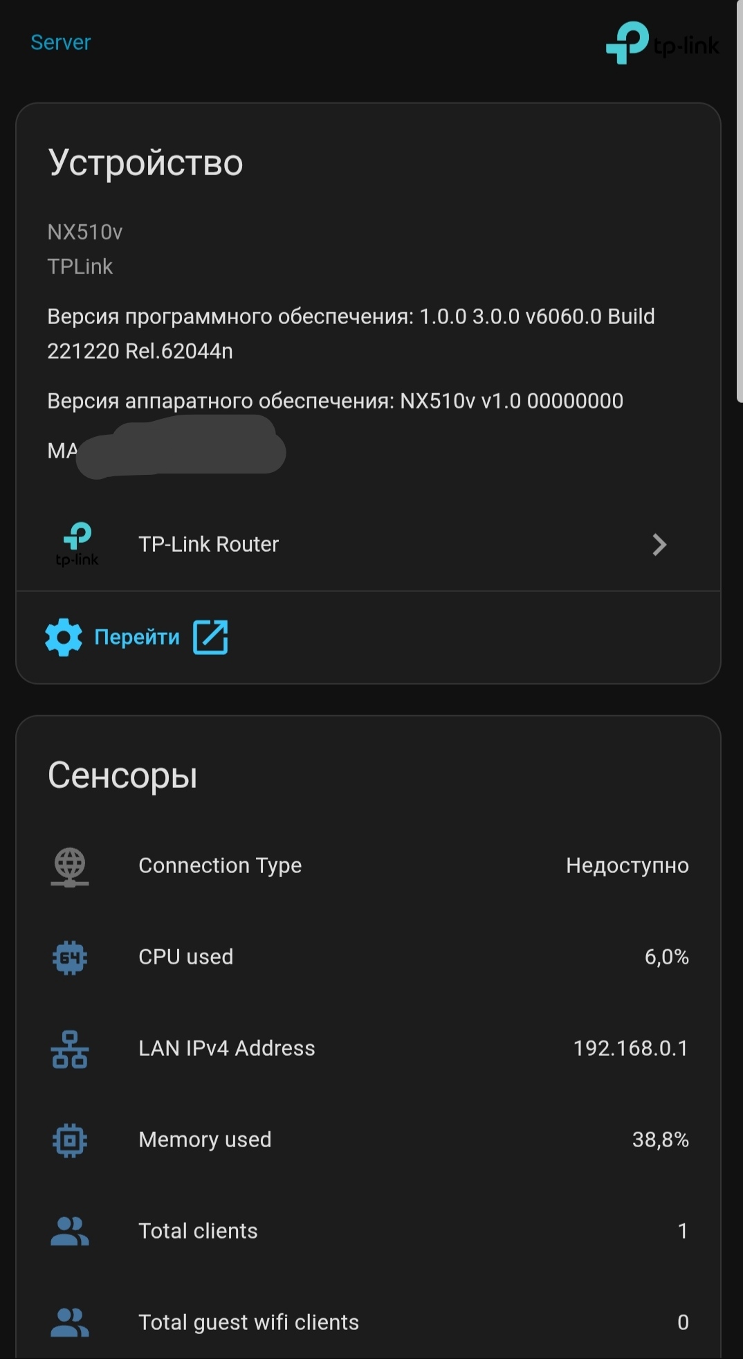

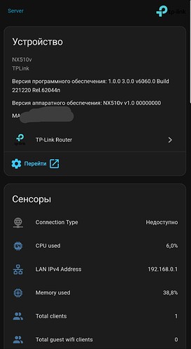

Hello, I login to the integration using “user” and password, LTE connection data is not appearing on the NX510V router, firmware version 1.0.0.3.0.0.
LTE information is not added for your router to the client. As I dont have this router - would be great if you add this feature to the client GitHub - AlexandrErohin/TP-Link-Archer-C6U: Python package for API access and management for TP-Link and Mercusys Routers. See supported routers list
