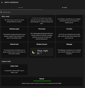

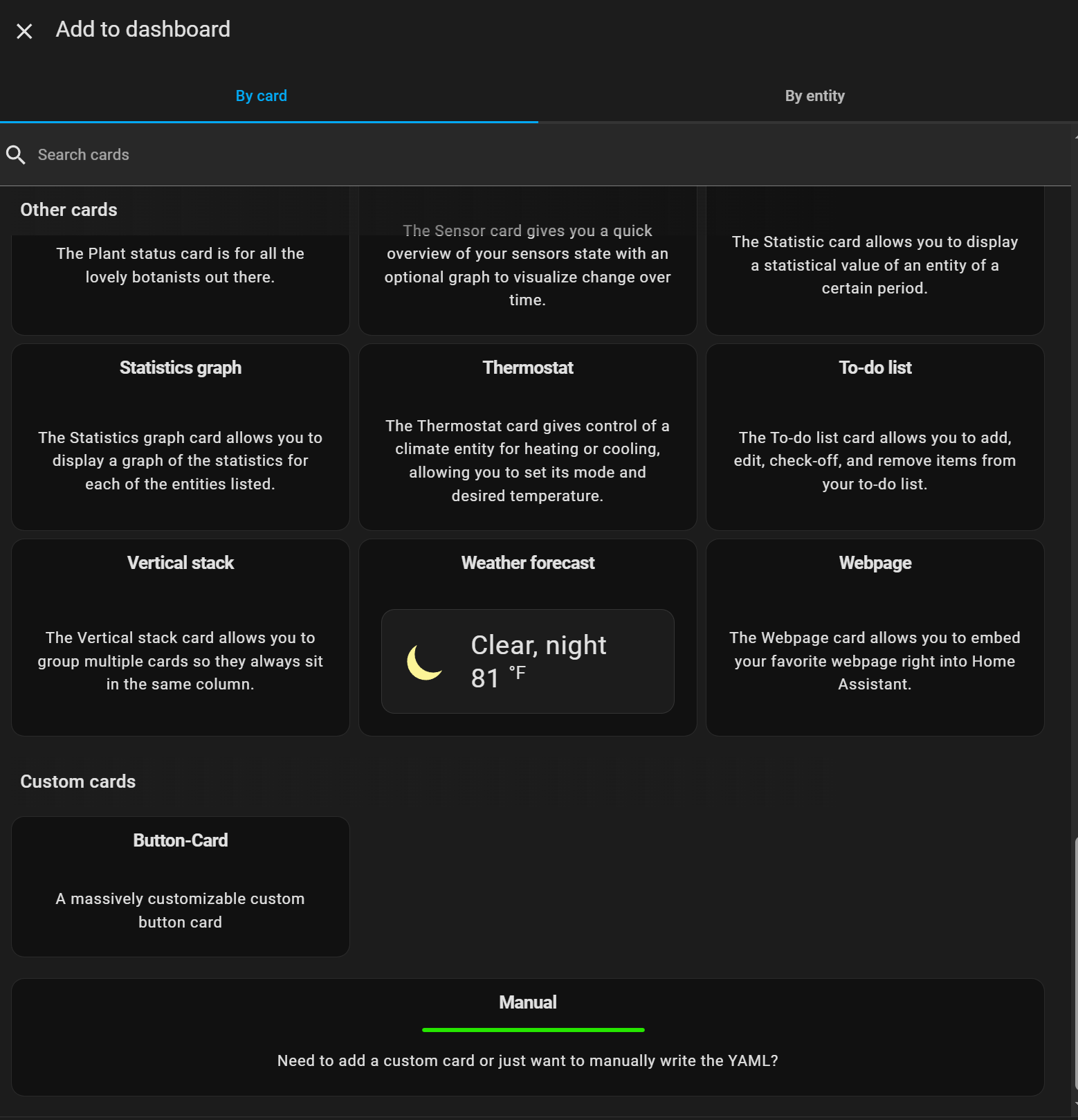

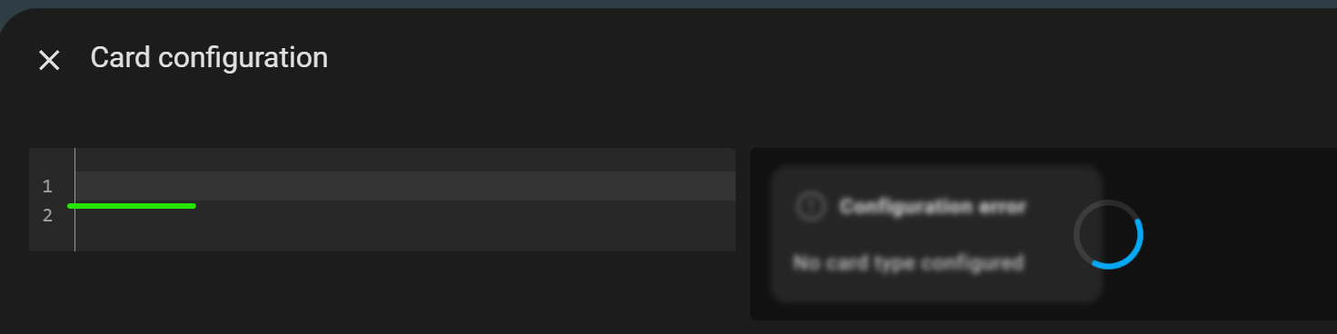

Add a new card, select Manual all the way at the bottom of the selection list
Copy the code I provided and paste it here
If you are copying other user’s button card code, all entities need to be change to your entities. If one entity in the Button code isn’t available in your system, you may get an error.

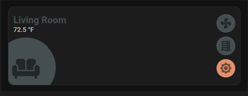

Sharing a pic of the actual dashboard error will help
It would look like this
Code is fine, check your entities Although, I’d go about it differently
Your code works without error on it’s own card. It is just two of my buttons though and nothing else. What is it I have wrong?
