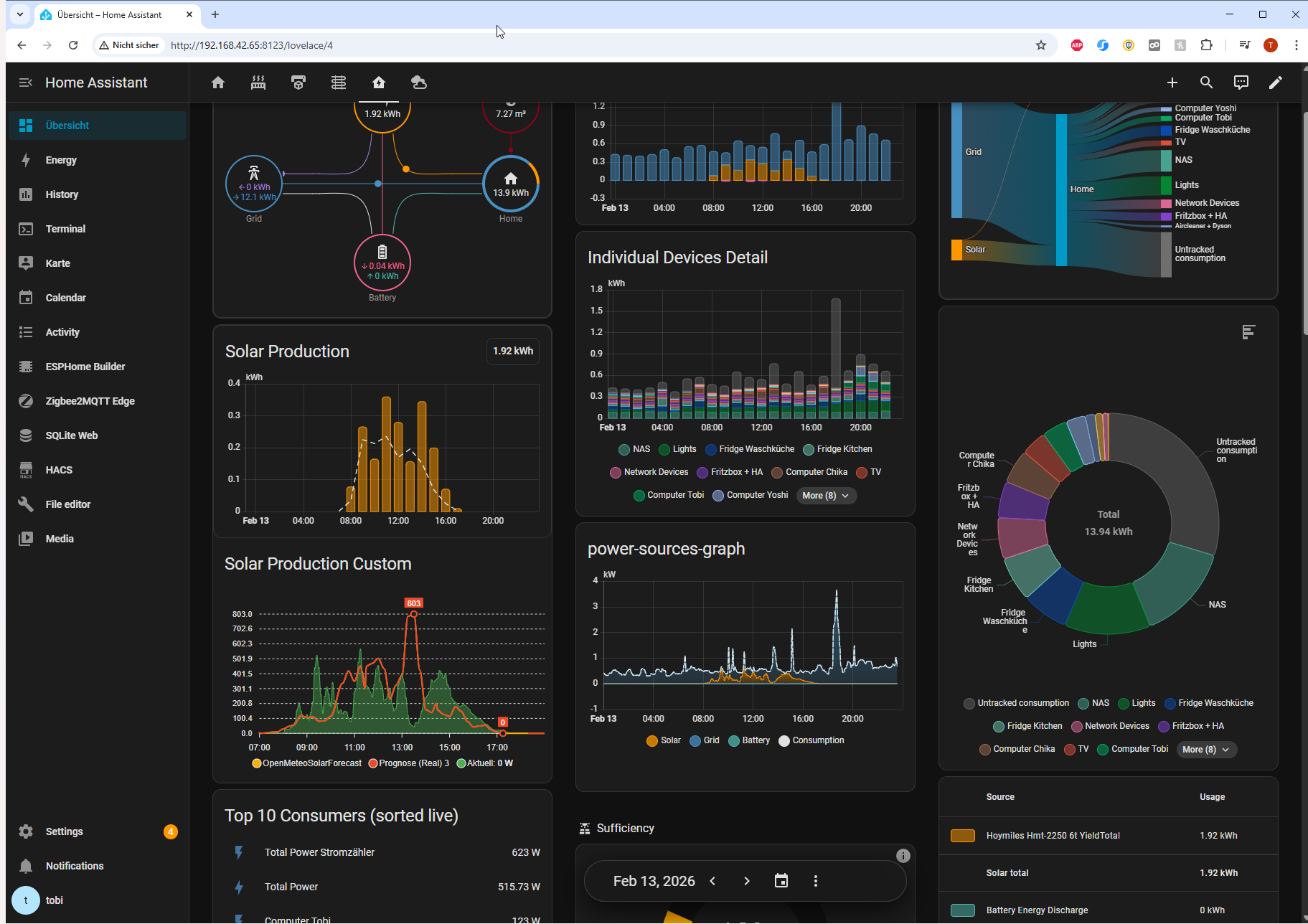

I got it:
          - type: energy-date-selection
            card_mod:
              style: |
                ha-card {
                  /* Fixierung am unteren Rand */
                  position: fixed !important;
                  bottom: 30px !important;
                  /* Zentrierung unter BerĂĽcksichtigung der Sidebar */
                  left: calc(50% + var(--mdc-drawer-width, 0px) / 2) !important;
                  transform: translateX(-50%) !important;
                  /* Dimensionen */
                  width: auto !important;
                  min-width: 450px !important;
                  height: 58px !important;
                  padding: 0 40px !important;
                  /* Design */
                  z-index: 9999 !important;
                  background: rgba(25, 25, 25, 0.95) !important;
                  backdrop-filter: blur(15px);
                  box-shadow: 0px 10px 40px rgba(0,0,0,0.8) !important;
                  border-radius: 30px !important;
                  border: 1px solid rgba(255, 255, 255, 0.15) !important;
                  display: flex !important;
                  align-items: center !important;
                .card-content {
                  padding: 0 !important;
                  width: 100% !important;
                  justify-content: space-between !important;
                :host {
                  position: absolute !important;
                  width: 0 !important;
                  height: 0 !important;
Many ways apparently :wink:

Success! This works like a charm.
  card_mod:
    style:
      # 1. THE INTERNALS (The calendar popup itself)
      hui-energy-period-selector$:
        ha-date-range-picker$:
          date-range-picker$: |
            /* Forces the popup to open upwards */
            .daterangepicker {
              top: auto !important;
              bottom: 50px !important; /* Pushes it above the floating bar */
              margin-top: 0 !important;
              transform-origin: bottom left !important;
            /* Flip the popup arrow (optional, cosmetic) */
            .daterangepicker:before {
              border-top: 7px solid #ccc !important;
              border-bottom: none !important;
              bottom: -7px !important;
            .daterangepicker:after {
              border-top: 6px solid #fff !important;
              bottom: -6px !important;
      # 2. THE CARD EXTERIOR (The floating bar)
        ha-card {
          /* Fixed position at the bottom */
          /* Horizontal centering (Stable method) */
          left: var(--mdc-drawer-width, 0px) !important;
          right: 0 !important;
          margin-left: auto !important;
          margin-right: auto !important;
          /* Styling / Dimensions */
          width: fit-content !important;
          z-index: 9000 !important;
          justify-content: center !important;
        .card-content {
        /* Hides the host element in the grid layout */
        :host {
For reference here is the complete Element:

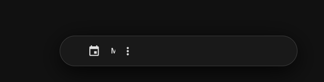

I love this, many thanks for sharing! I have an issue with the rendering being broken, it worked a coupe of times but now I only see parts of the picker. Anyone else seing this?
If I typo the .card-content to e.g. “display: falex !important;” it works as it should. Hmm.
@haraldh That typo fixing the issue (“falex”) actually points exactly to the root cause: you are experiencing a severe flexbox collapse.
The old CSS hack stopped working because Home Assistant completely rebuilt the underlying DOM for the hui-energy-period-selector card recently. It is now extremely fragile when manipulated with card_mod.
We just spent hours fighting this exact behavior. Here is what is happening under the hood:
  1. The Javascript ResizeObserver: HA added a hardcoded JavaScript observer that constantly measures the width of this card. If the card drops below ~450px, the JS physically deletes the arrow buttons from the DOM and moves them into the 3-dot overflow menu. If it drops below ~600px, it removes the “Now” button too. CSS cannot bring back elements that JS deleted.
  2. The Flexbox Collapse: The date text (.date-range) now has a flex-grow property. If you try to squeeze the card, the flexbox collapses and cuts off the text (turning “Mar 17” into “M”). Disabling flex entirely (which your typo “falex” effectively does since the browser ignores invalid CSS) works around the collapse, but breaks the intended layout flow.
The Solution: We have to separate the logic from the visuals using a brute-force scaling hack.
We force the card to be 600px wide. This tricks the HA JavaScript into thinking it has a massive screen, so it keeps all the arrows and the “Now” button in the DOM. To make this fit on a mobile screen, we use a media query to apply transform: scale(0.6) which shrinks the rendered 600px card down to a neat 360px.
To prevent the touch hitboxes from misaligning during the scale (which makes the buttons unclickable), we center it on mobile using an old-school negative margin (left: 50%; margin-left: -300px;).
Here is the fully working code with all fixes applied:
			/* 2. ALIGNMENT (Fixes flexbox collapse and huge empty gaps) */
			.content {
			  gap: 10px !important;
			/* Remove flex-grow from the date to prevent it pushing arrows away */
			.date-range {
			  flex: 0 1 auto !important;
			  margin: 0 !important;
		  ha-card {
			/* 3. THE FLOATING BAR (Desktop Base) */
			/* Dynamic centering (Sidebar-aware for desktop) */
			/* Fix hitboxes */
			pointer-events: auto !important;
			/* THE TRICK: Force 600px width so the HA Javascript keeps ALL icons (arrows + 'Now') */
			width: 600px !important;
			padding: 0 15px !important;
			box-sizing: border-box !important;
			/* Visuals */
			backdrop-filter: blur(15px) !important;
			/* Text contrast fixes */
			--primary-text-color: white !important;
			--secondary-text-color: white !important;
			--mdc-icon-color: white !important;
			--mdc-theme-text-primary-on-background: white !important;
		  /* 4. THE MOBILE HACK (Scaling brute-force) */
		  @media (max-width: 500px) {
			ha-card {
			  /* Reset sidebar logic and hard-center using oldschool negative margin */
			  left: 50% !important;
			  margin-left: -300px !important; /* Exactly half of the 600px width */
			  /* Shrink the 600px card to 360px (600 * 0.6) for mobile screens */
			  transform: scale(0.6) !important;
			  transform-origin: bottom center !important;
		  /* Hide the host element in the grid layout without breaking it */
		  :host {
			pointer-events: none !important;
I copied this exact code, the date picker popup still goes down. Everything else works fine. Strangely, the compare popup goes up, but the date picker goes down no matter where I put it.
Same problem as Paul, the date picker keeps going down.
I checked with the browser inspector and style .daterangepicker appears not to exist (anymore?).
Regards,
Ben
