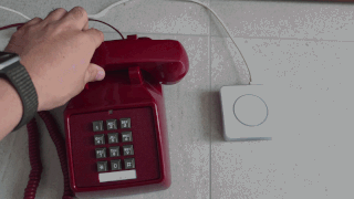

Hi everyone,
I’ve put together a custom ESPHome external component that brings full VoIP/SIP capabilities to ESP32 devices: sip_client.
Instead of just a simple media player, this component acts as a native SIP client. It allows your ESPHome devices to register with any standard VoIP/PBX server (such as Asterisk, FreePBX, Fritz!Box, or local PBX setups) to make and receive actual voice calls just like a hardware phone or intercom.
:rocket: Key Features
  • Full SIP Phone Capabilities: Supports active SIP registration, outbound calling, and inbound call reception.
  • Native ESPHome Integration: No complex coding or custom firmware setups—fully configurable entirely via YAML.
  • Hardware Flexible: Can be easily combined with buttons, keypads, microphones, and speakers to build standalone hardware.
