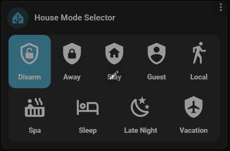

@Nerwyn I’m trying to customize an Input_Selector. I want to make the icon sizes larger and thus I need to increase the height of the row.
I cant get the row height to change or the spacing to change (CSS below). (screenshot shows this)
I’d also like to split the buttons/options into 2 rows but I didnt find a setting for that?
CSS is…
:host {
  flexbasis: 200% !important;
  --mdc-icon-size: 36px;
  --feature-height 100px;
  --feature-button-spacing 20px;
You’re missing a colon in your CSS on --feature-height. --feature-button-spacing isn’t a variable used by this project. You can set the gap on the custom selector host styles instead. You also don’t need to use !important in these styles, it’s added by the feature to custom user styles. It’s also flex-basis, not flexbasis.
Try these styles. You’ll have to adjust the custom-feature-button attributes to fit the options as you like. You may also have to adjust the parent card layout to fit the extra tall feature row if in sections view.
:host {
  gap: 0 20px;
  flex-wrap: wrap;
  --feature-height: 100px;
custom-feature-button {
  flex-grow: 1;
  flex-basis: 20%;
  height: calc(0.5 * var(--feature-height));
Its better but any of the item you put above didnt change anything. I’m using a Tile Card, does that matter?
The code below is the only things that impacted the visuals, the other settings did not.
Also, its not changing the Left/Right gaps, or adding rows?
:host {
  gap: 0 20px;
  flex-wrap: wrap;
  --feature-height: 70px;
Are you putting these styles at the row level or the selector level? They should be in the selector. And are you trying to add a gap between selector options (what my provided styles do), or increase the side margins of the entire selector?
I’m fumbling around, did not realize there are 2 separate options. Too many nested menus! I got it to where you see below
How can I reduce the gap between the icon and the label below?
also, any idea how to remove the header/title above the selector options (this is a tile card). thx for the help, this is just what I need!
To do that, you’ll have to modify the label styles of each option individually. Add this to the CSS Styles field in the appearance panel of each individual option.
.label {
  position: relative;
  top: -16px;
Outside of the scope of what custom features can do, but you can do this with card-mod.
card_mod:
  style: |
    .container {
      padding-top: 10px !important;
    .content {
      display: none !important;
huge thank you! Its a big challenge for a noobie when we literally need to learn 3 ‘new’ languages (YAML, JINJA, CSS) all at once to be proficient with dashboards and automations.

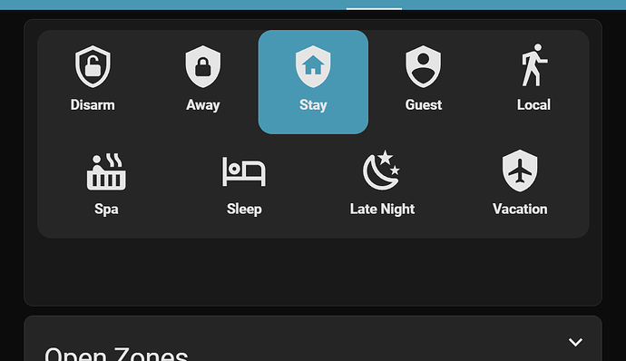

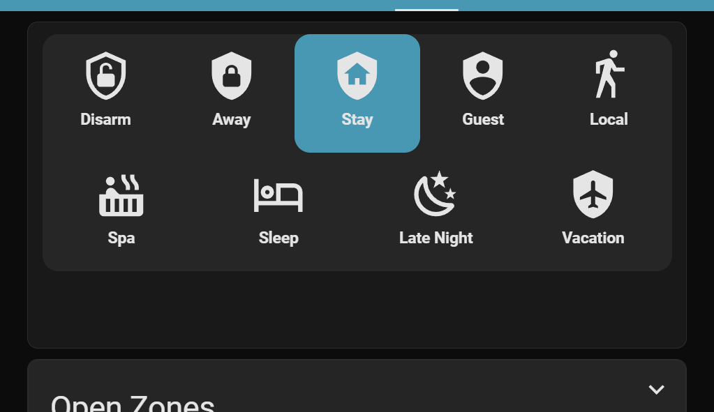

one last question… do you know the setting that will get rid of the buffer at the bottom? padding-bottom:10px !important; didnt work.
If you’re using sections view, in the layout tab of the card click on the menu and then Edit in YAML, and then set rows to a non-number like null or x. That should disable it from conforming to sections rows which should get rid of the extra tile card space.
