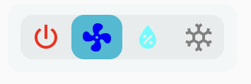

I’m trying to replace the icon with an image in the Selector section.
Unfortunately, your example didn’t work. How can I add an image?

Also, is there a way to cancel the hover effect that occurs when it comes to the frame?
That config is a bit out of date, but you can do the same using the newer CSS styles option. In the configuration UI at the option level put this in the CSS styles field in the appearance section:
.background::before {
  background-image: url("/local/path/to/your/picture.png");
  background-position: center;
  background-repeat: no-repeat;
  background-size: contain;
Disabling the hover color is a bit trickier as there’s a few CSS variables at play there, but these styles at the selector level should make it so that only the currently selected option is highlighted and hovered options are not highlighted.
.option:not(.selected) {
  --color: transparent;
  --opacity: 1;
  --hover-opacity: 1;

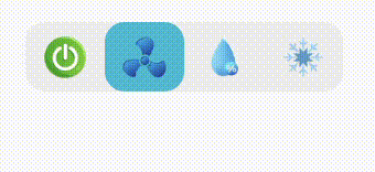

Thank you so much for your answer.
I was able to put an image instead of an icon.

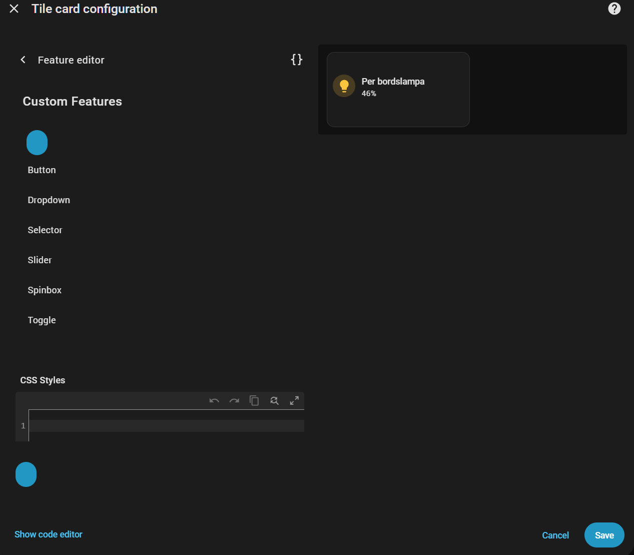

I have a problem with the editor, see the screenshot. There is no “Add Custom feature” button, but instead a list of the various kinds of features available. Clicking them has no effect.
This was fixed in 4.7.12 as Home Assistant version 2026.2.0 changed its dropdown components. Update to the latest version of this module and Home Assistant, make sure that there are not extra copies of this module installed, and possibly clear cache.
I am on HA 2026.2.3 and on Custom Features 4.8.0. Have cleared all caches and also tried on “clean” devices/browsers that have not used HA before. Still the same.
Check your browser console logs and make sure that it’s actually loading the latest version of the module. There’s probably an extra copy of an older version of the module installed that’s loading before the latest version. It may have the name service-call-tile-feature.
That seems to be the case, yes.
When I hover over that link, the path is http://homeassistant:8123/hacsfiles/service-call-tile-feature/custom-features-row.min.js?hacstag=698501153434
But I have no idea of how to get rid of the old version. Have tried removing Custom Features in HACS.
It should say this instead:
Check your frontend resources list for custom-features-row.min.js and delete it. Keep custom-card-features.min.js. Also check your /config/www/community/ directory for a folder named custom-features-row or service-call-tile-feature and delete it. If custom-features-row.min.js is in the /config/www/community/custom-card-features/ folder delete it.
That was the solution. It also seems I had a similar issue for Universal Remote Card, so I cleaned up that as well. Thank you!

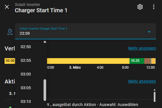

I’m having trouble understanding how to use the value variable in an action template.
I have a select entity with predefined times in 5-minute increments.
Now I want to use the input to select one of these values ​​from the entity.
To do this, I want to modify the input so that the value matches the next available selection. For example, change 12:36 to 12:35, or 10:28 to 10:30, or 08:58 to 09:00.
Below is my approach to implementing this in the action template. However, I’m not sure if I can use the value variable this way.

If value is undefined it may be because you didn’t set the feature entity to the correct entity or it’s attribute to the correct attribute. Try putting {{ value }} in the label and see what appears in the feature.
Your template also appears to be incorrect. For input 10:00 it’s returning 1,0,:,00. Instead of manually parsing the input as you’re doing, try using the time functions and some math. Specifically the ts-py-datetime time and timedelta objects. This template should work:
