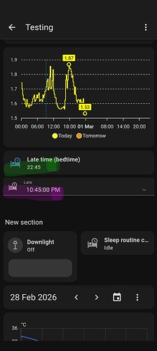

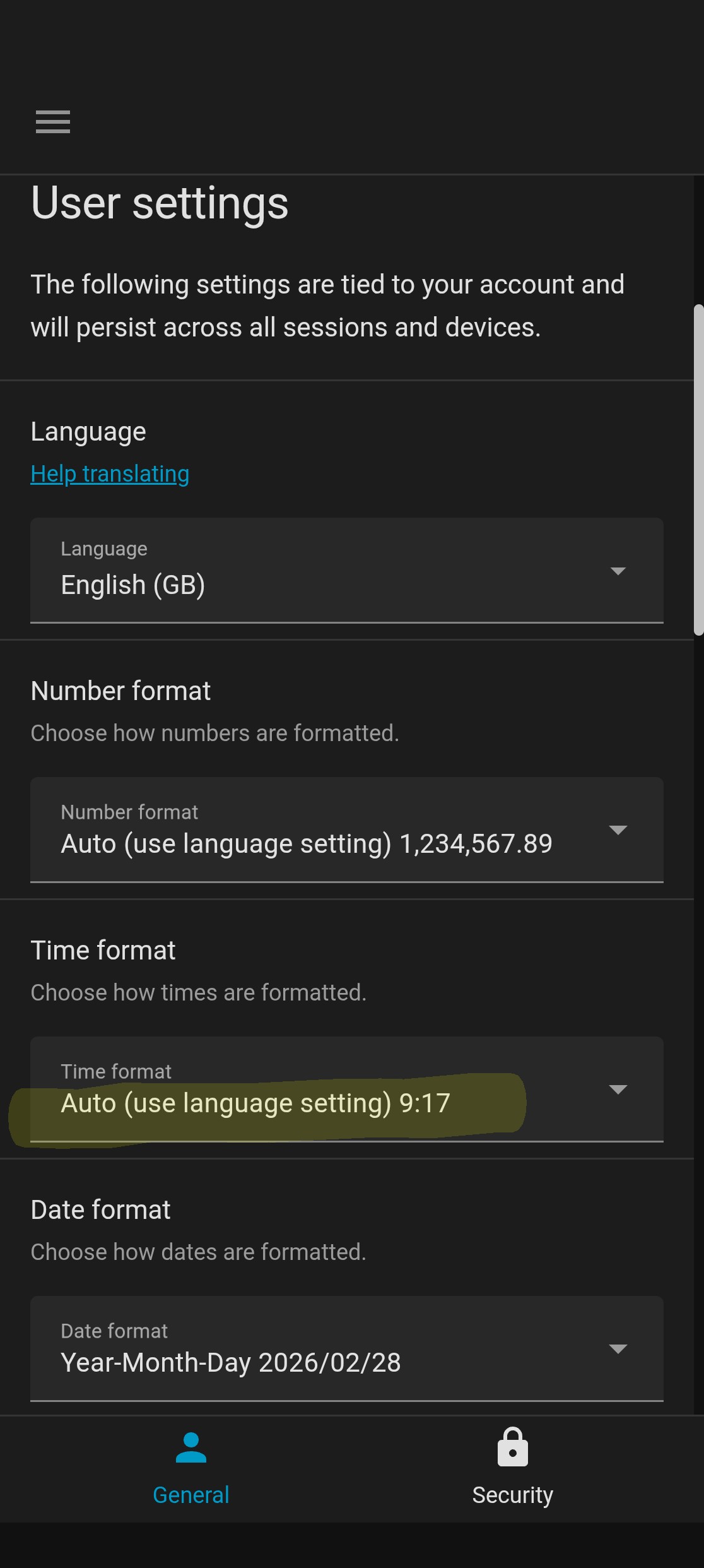

I noticed a potential bug with the time format.
Setting, 24 hour clock:
Tile card (marked green) shows 24 hour clock, custom features card (marked pink) shows 12 hour clock for the same entity:
That’s expected behavior with templates for both the HA default jinja backend and this card’s template system. ha-nunjucks has it’s own methods to format states, attribute names and values, numbers, dates, times, and datetimes using user settings as asked for in this issue and seen here in the ha-nunjucks README. But in testing while writing this I realized that I wasn’t taking these localization settings into account when doing so, so I’ve created a bug to fix later.

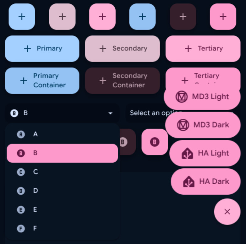

Version 4.9.0 adds many new Material Design 3 button and dropdown type variants.
  • FAB (floating action buttons) buttons.
  • Standard and vibrant menus.
  • FAB menus.
It also adds some fixes to toggle checkbox and input features to use newer Home Assistant theme style tokens, and makes it so that Material Design 3 buttons and sliders will now scale with --feature-height in their font size and border radii.
