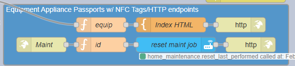

Enter NodeRed. I had nodered parse the tag info written on the tag so I dont need to micromange any act after its written.
Because I grew tired and tried many different apps and systems to WHERE would be the best place to store this inventory. I decided to combine these two workflows.
Now NodeRed keeps a JSON db of those devices/applicances.

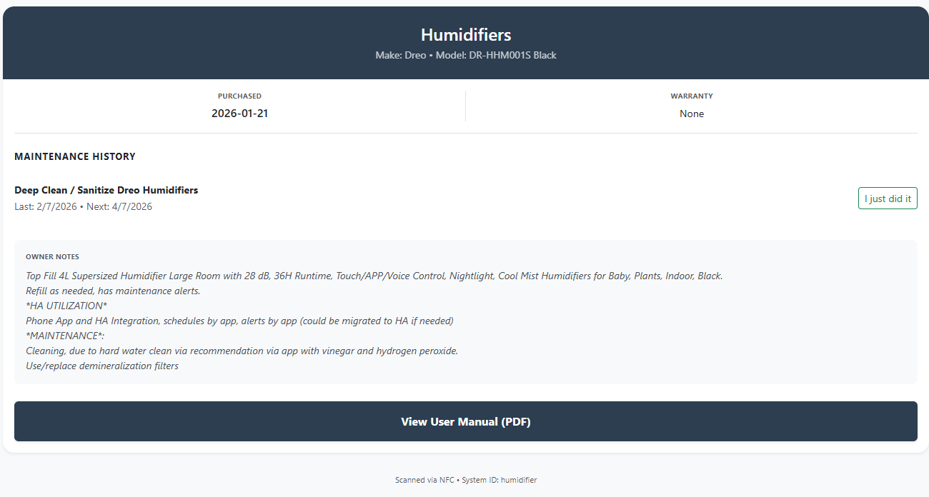

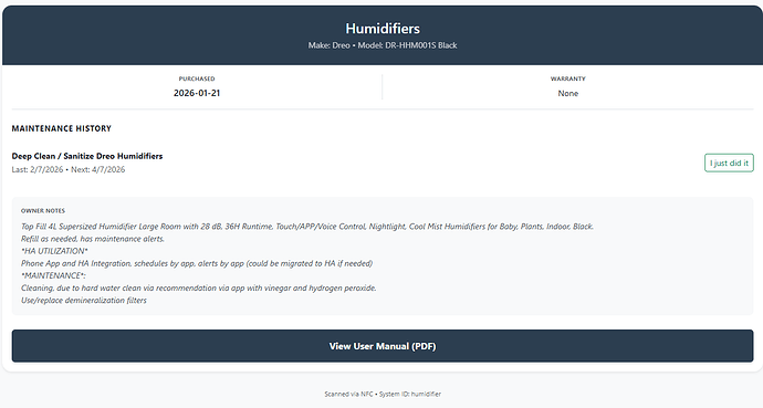

The tag writes the identifier, and phone will open the page from NodeRed based on the identifier written on the tag. Instead of auto logging maintenance activity directly on the scan, the phone opens the Inventory/Passport page, which has all the data:
  • Purchase/Warranty
  • Make
  • Model
  • Details/History (previous issues, repairs/replacements, servicing, quirks…etc)
  • SN / PN
  • Link to PDF Manual so I dont have to remember what every button/symbol means. Any specific maintenance task shows when last completed and next due by an -I JUST DID IT- Button which auto updates the record in HomeAssistant.

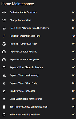

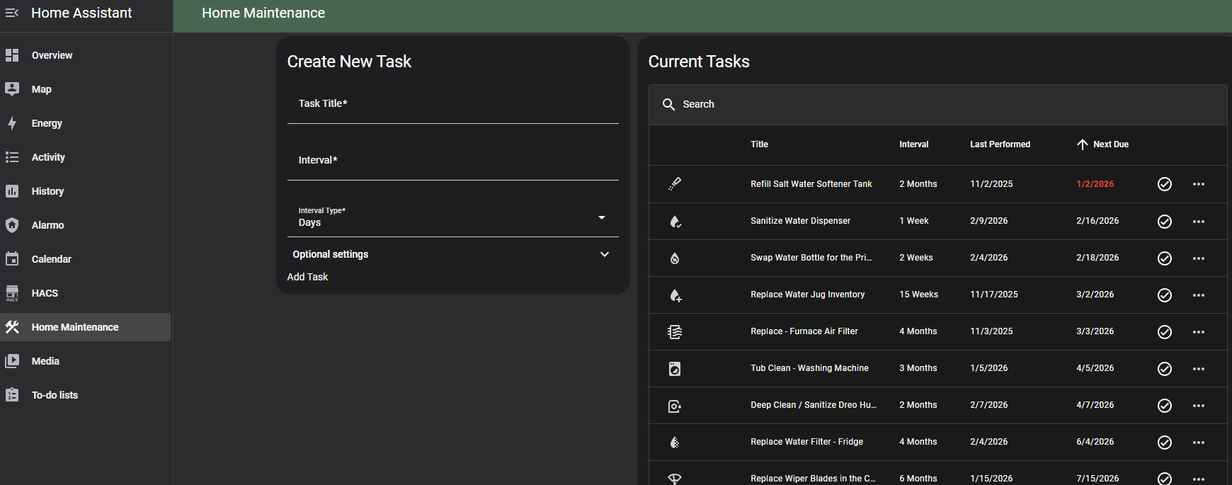

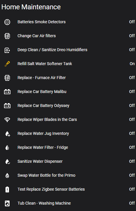

I came across HACS Home Maintenance integration and leverage that to log maint events.
Fridge, washer, dryer, dishwasher, water softener, furnace…etc.
