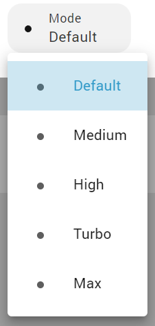

I’m creating a custom humidifier entity with a custom set of modes. It works but the custom mode’s icons in Mode dropdown in the more-info card show up with “dot” icons (I assume some default) and I’d like to set them to some custom icons but I have not been able to identify what property / def I need to override or set in my python code to accomplish this.
I’ve tried going through the docs on my own and also asked LLMs but the answers are always garbage. The manual search isn’t showing much.
Eg I’m getting this
Thanks!

thanks very much, interesting! so it’s not possible to do this programmatically? kind of need to hardcode it in that file? e.g. if i want to make it templetizeable, not possible?
No I don’t think there’s any dynamic/templating possibility.
I tried replicating this exactly in my custom component’s folder but it didn’ take. I also tried renaming entity_component to entity as well as being explicit about it being a humidifier domain but nothing worked :frowning:
Try looking at other core humidifier integrations that have icons and see how they structure it. Or check docs:
That’s exactly the page I was looking at but that’s woefully handwavy. I want specifics on exactly where to put the file, exactly what API to override to point to that file. It’s all super loose on details and clicking through the links doesn’t give me anything specific. Anyway, it’s good to see you’re pointing me to where I’ve been looking so the key is there. I’ve tried a few variations and none have worked.
I haven’t been able to make this work but I’ll mark your original icons answer as the solution. I don’t know if I’ll be able to but it’s more on me
Been playing with it for hours, still cannot get it to work (ie for HA to honor it). Giving up…

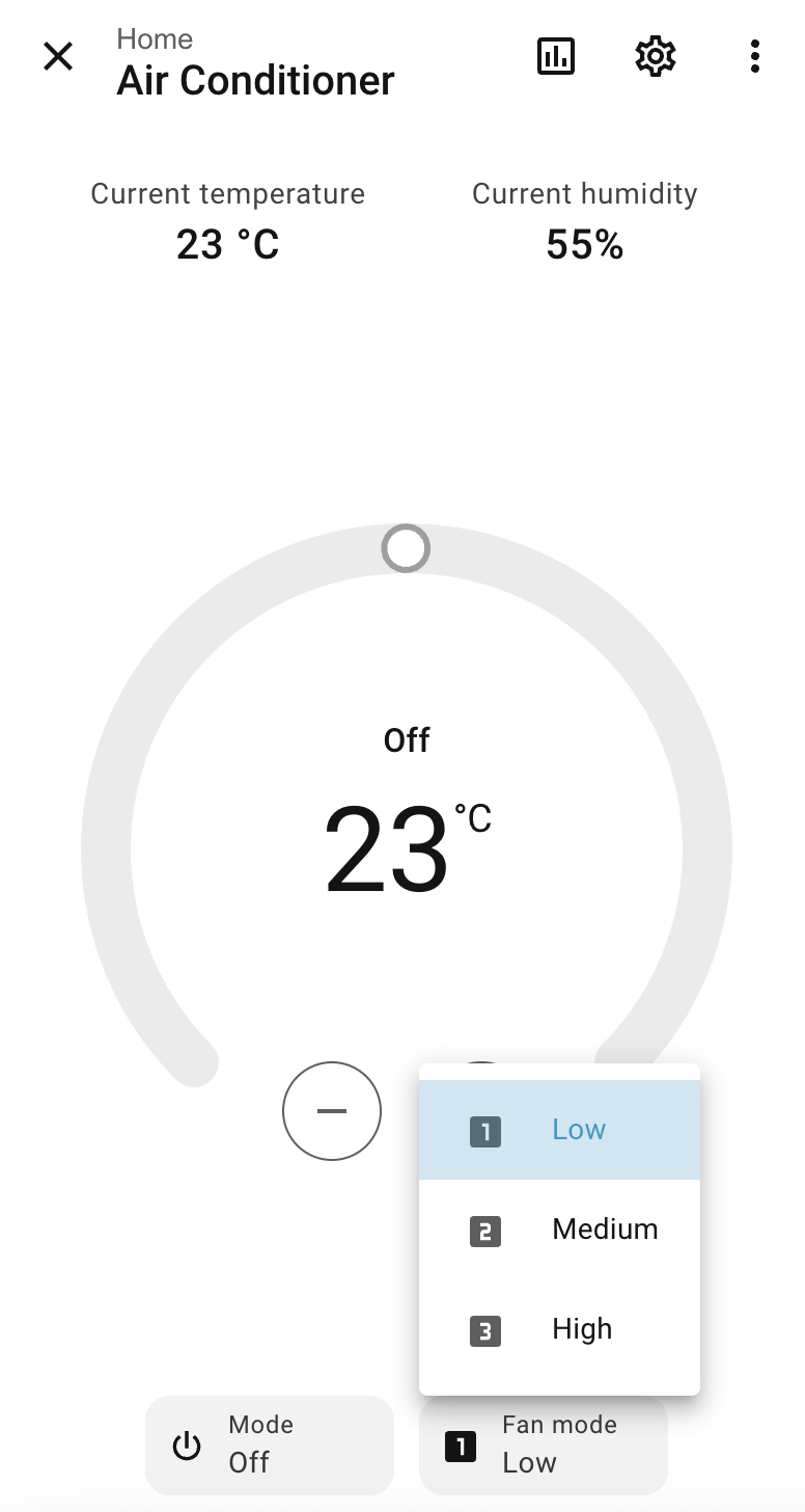

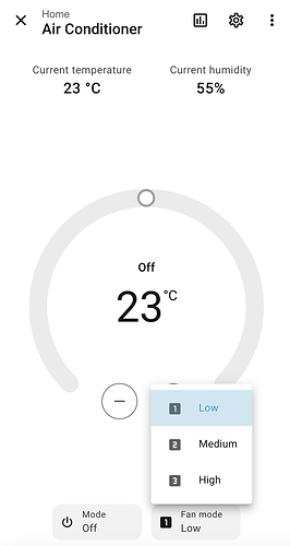

card_mod can work with more-info via theme. In this case I have adjusted fan_modes and icons to be in the jinja template for card_mod. This is actually easier in application, but more involved in that you need to use a theme.
card_mod theme yaml. Once everything is good you can remove the Jinja comment that sets debug to the template {# card_mod.debug #}
Note: ha-control-select-menu:nth-child(2) is the fan modes. You could style the hvac modes with ha-control-select-menu:nth-child(1) and adjust template to suit
My Themet:
  card-mod-theme: My Theme
  card-mod-more-info-yaml: |
    ha-more-info-info $:
      more-info-content $:
        more-info-climate $:
            {% set fan_modes = [ "low", "med", "high" ] %}
            {% set icons = [ "mdi:numeric-1-box", "mdi:numeric-2-box", "mdi:numeric-3-box" ] %}
            ha-control-select-menu:nth-child(2) ha-attribute-icon[slot="icon"] {
              {% set iconIndex = fan_modes.index(state_attr(config.entityId, 'fan_mode')) %}
              --card-mod-icon: {{ icons[iconIndex] }};
            {% for fan_mode in fan_modes %}
            ha-control-select-menu:nth-child(2) ha-list-item:nth-child({{ loop.index + 1 }}) > ha-attribute-icon {
              --card-mod-icon: {{ icons[loop.index0] }};
            {% endfor %}
I hope HA eventually makes it possible to edit devices from the UI and assign icons there. And even further in the future, assign default icons for common modes for both humidifier and dehumidifier device types, similar to how default icons already exist for recognized modes for climate.thermostat device types.
