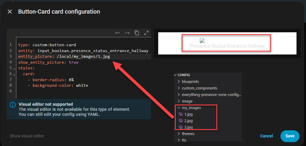

Custom:button-card: image is broken
I am going a bit nuts here, as I thought is a simple task.
I followed here where I had copied all the code, but somehow the image is broken. I have tried uploading 3 different images to test as it could be the image’s problem but I had no luck. I tried clearing the cache from Chrome, restarted HA, I am just not sure what’s wrong?
Try with a simple i.e switch or light
As Your Picture ends up in an Input_boolean basically “as a file”
Create www folder for serving local file…
Thank you both for your replies and I had done both of your recommendations and still doesn’t work
  1. changed to a light
  2. put the images under “WWW” folder (where I already have)
:smiley: use only /local/xxxx.jpg … dont think your instance is at you.domain
thank you this works!
