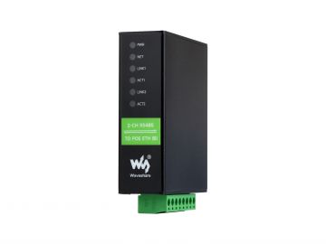

Hi, is it possibile to have two wallbox Connected with RS485 to the same Rs485 to eth device? (an unique integration, with slave 1 and slave 2).
Thanks for the support.
For using with this integration you must have charger WITH LCD and own IP addres. So you add IP of your charger to this APP.
Or IP TCP RS485 module. You buy Modbus with more inputs with own IP RS
input
Thanks for your answer First of all. I followed instructions written above (with DR134 adapter). It works fine but just for one wallbox even of rs485 has been Connected in both wallbox. Is it there the possibility to have both instances on home assistant with an unique adapter?
Thanks
dual input rs485 tcp. With this APP charger is only MASTER
It should be possible to add multiple chargers, but every charger must have its own IP, integration connects to. But integration “only” connects charger to home assistant. It does not manage your charging. For managing charging you must set up automations or integration.
