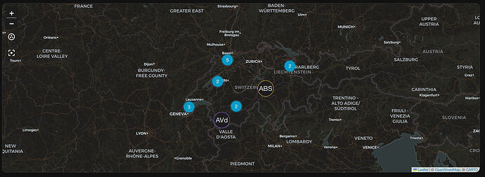

• Geo-location events for displaying alert locations on the Home Assistant map

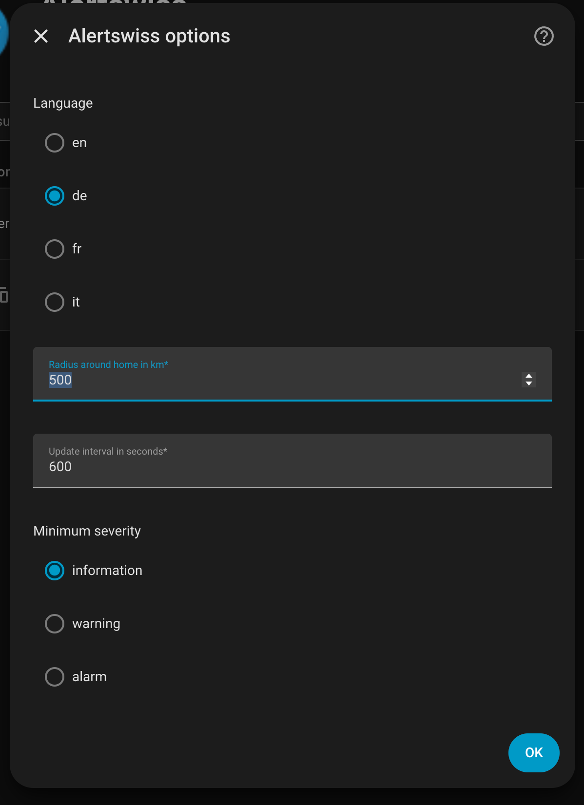

• Configurable search radius around your Home Assistant location
• Adjustable update interval
• Filtering by minimum severity level (Information, Warning, Alarm)

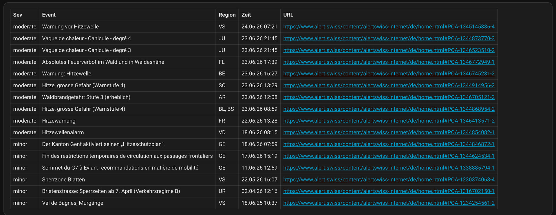

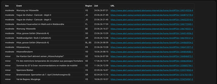

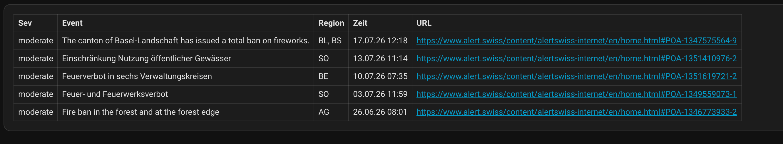

• Dashboard tables showing all active alerts

Screenshots
