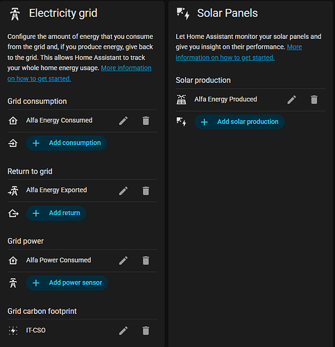

Here’s how it should be configured:

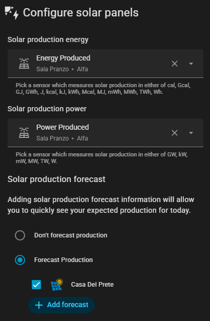

And here’s the detail of the “Solar Panels” section when you edit it:

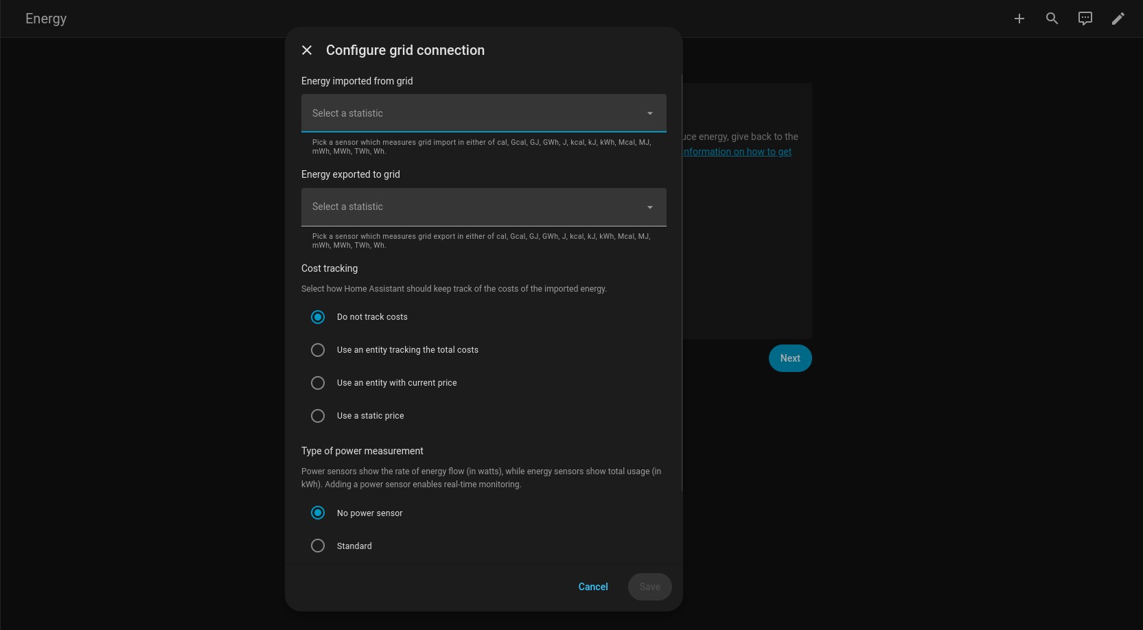

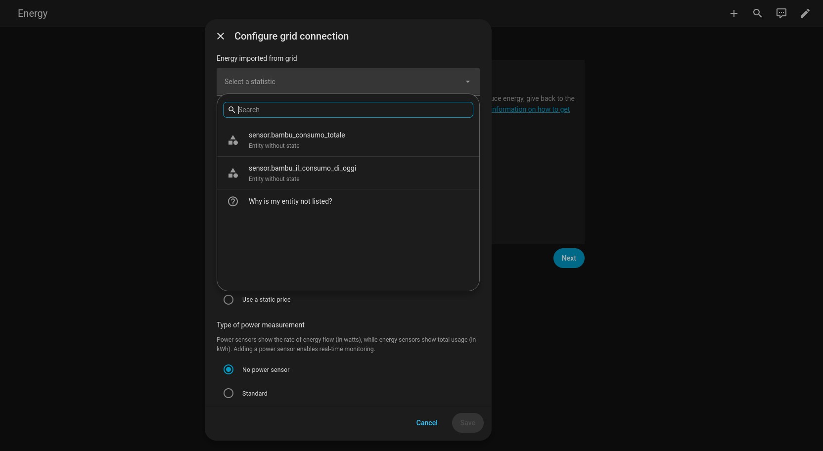

When I go to the energy tab, I cannot choose any of the Alfa sensors.
Both Grid consumption and Grid power don’t have any Alfa sensors and I cannot add them manually.
Any ideas?

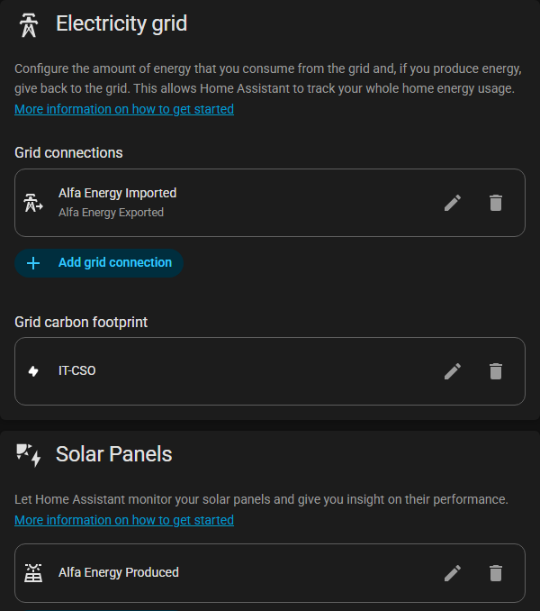

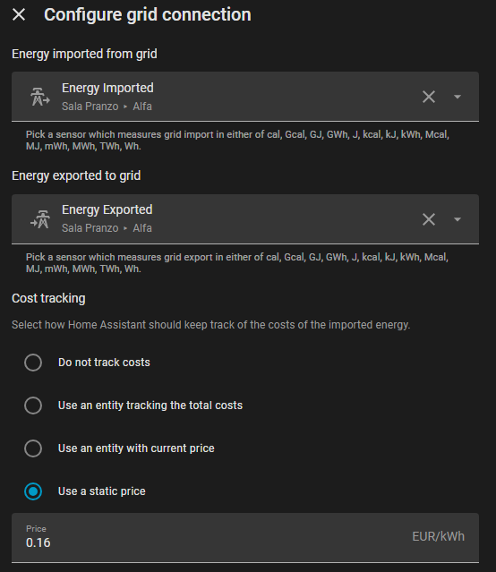

In the Energy dashboard, you need to choose the energy sensors, not power sensors: so for Grid connections it’s Alfa Energy Imported, for Solar Panels it’s Alfa Energy Produced.

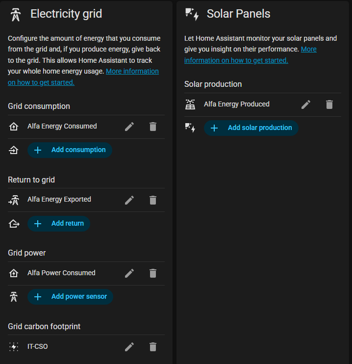

This is my dashboard config:

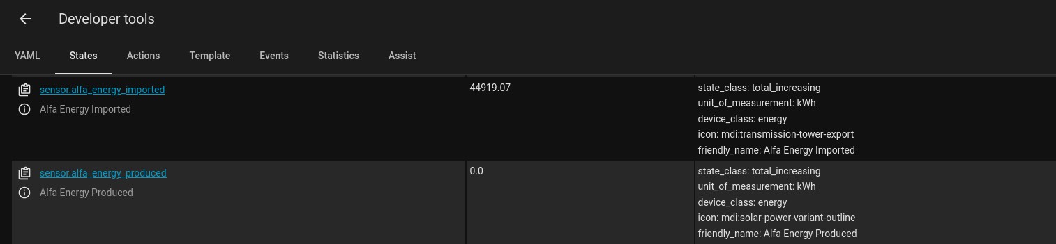

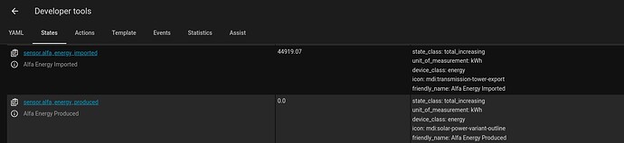

If Alfa sensors don’t appear, go into developer tools and check the two sensors’ details, specifically the device_class and state_class attributes. They have to be like these, otherwise you won’t see them in the energy dashboard:

Seems to me that everything is as it should but I still don’t see the sensors in the energy tab.
I’m on Home Assitant OS with all the updates if it helps

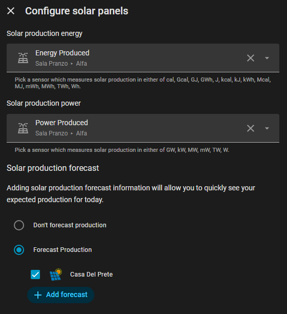

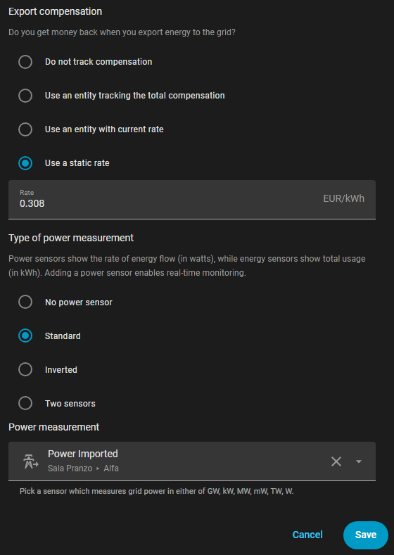

This is the “Configure Grid Connection” I have, you can see Energy import, Energy export and Power Import sensors configured:
This is the “Configure solar panels” section, you can see Energy Produced and Power Produced sensors configured:

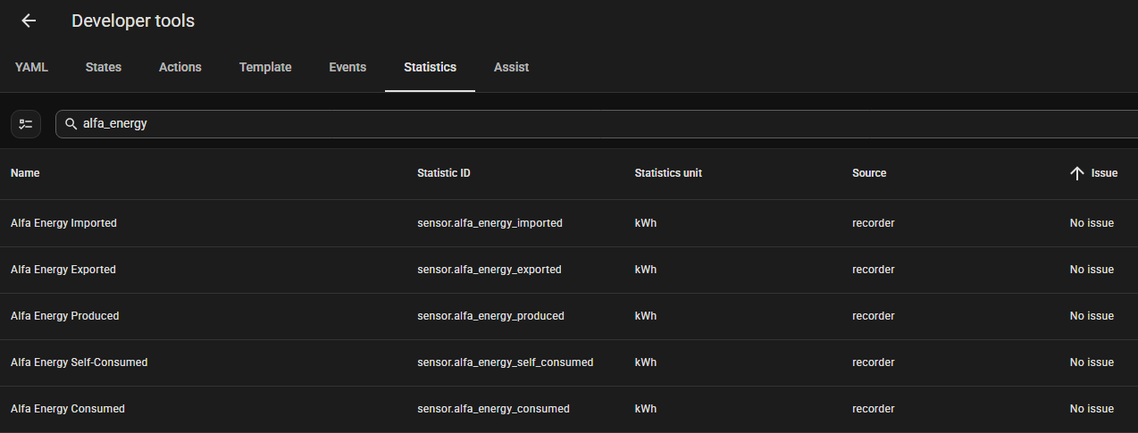

One suggestion: maybe you have recorder disabled by default and you need to enable it explicitly? If the alfa entities are not recorded, they will not appear in the energy integration. Also, check in the statistics section of HA if they are listed. If they aren’t, it means they’re not recorded. It happened to another user in the past because he had a very weird recorder configuration.
Here’s the statistics section filtered for Alfa energy sensors, you can see the source Recorder indication:
