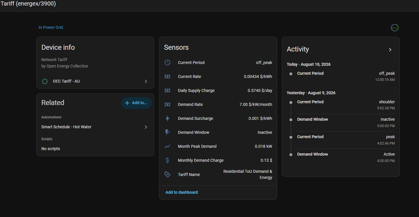

What it does
  • Current rate sensor ($/kWh) updates every 5 minutes based on your actual network tariff schedule
  • Current period sensor tells you if you’re in peak, off-peak, shoulder, or solar soak
  • Demand window sensor binary sensor you can use as an automation trigger (e.g., throttle loads when demand is being measured)
  • Demand charge tracker monitors your grid power and calculates your peak demand + estimated monthly demand charge
  • Config flow UI pick your Network Provider, pick your tariff, done
Supported networks
12 Australian DNSPs: Ausgrid, Endeavour, Essential, Energex, Ergon, AusNet, CitiPower, Powercor, United, Jemena, SA Power Networks, Evoenergy, Power and Water.
Data comes from a free public API: Tariff Data Service - Swagger UI sourced from official AER-approved DNSP Network Price Lists.
Demand tracking
If your tariff has a demand component, the integration automatically:
  • Samples your grid power sensor every 30 seconds
  • Only records during the demand window (correct time, days, and season per your DNSP)
  • Uses the correct measurement method for your network (30-min average, 30-min max, monthly peak, or rolling 12-month max)
  • Persists across restarts
  • Gives you a live $/month demand charge estimate
Great for automations like “pause the EV charger when the demand window opens” or “alert me if my demand charge exceeds $X this month.”
